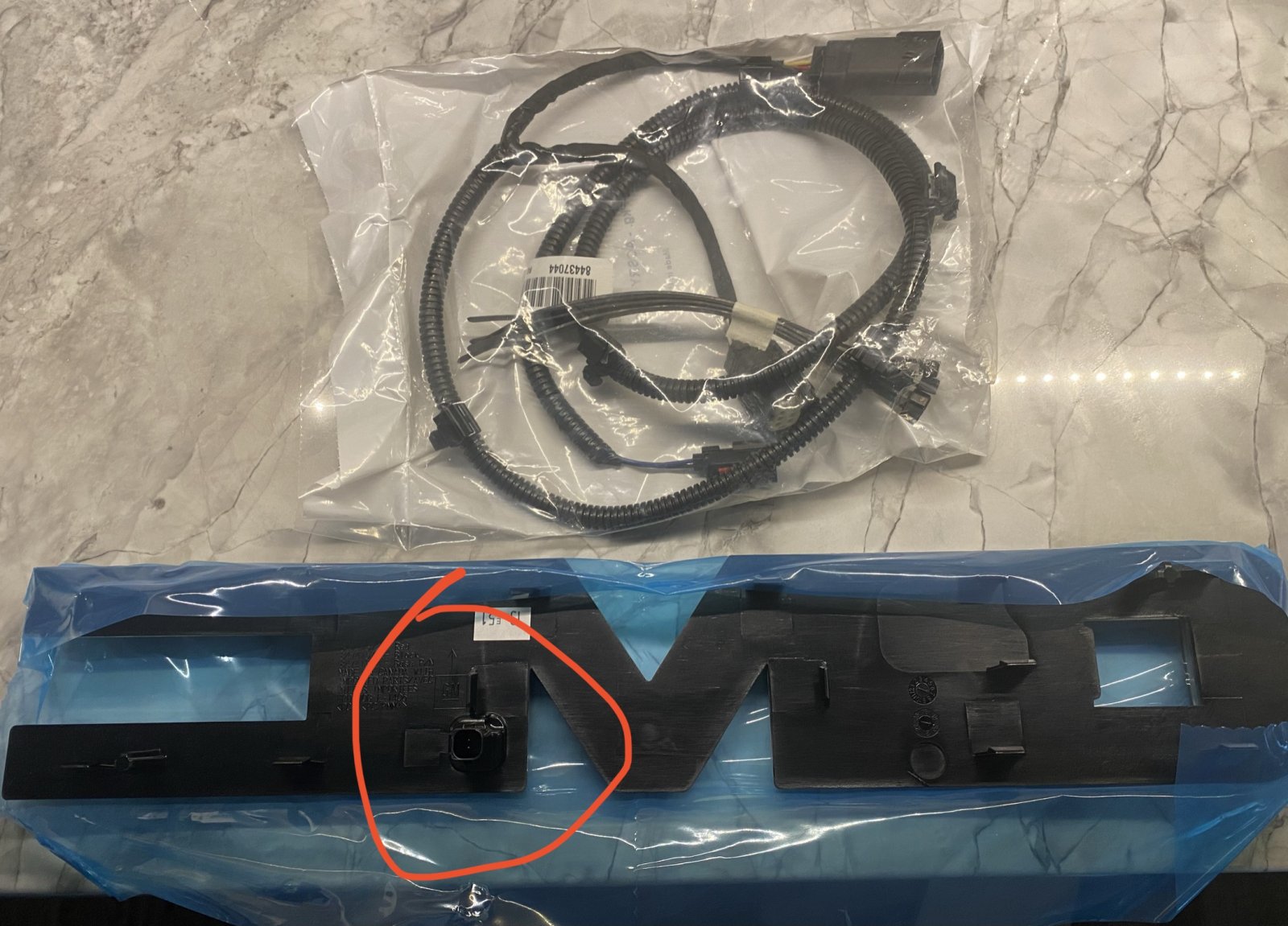

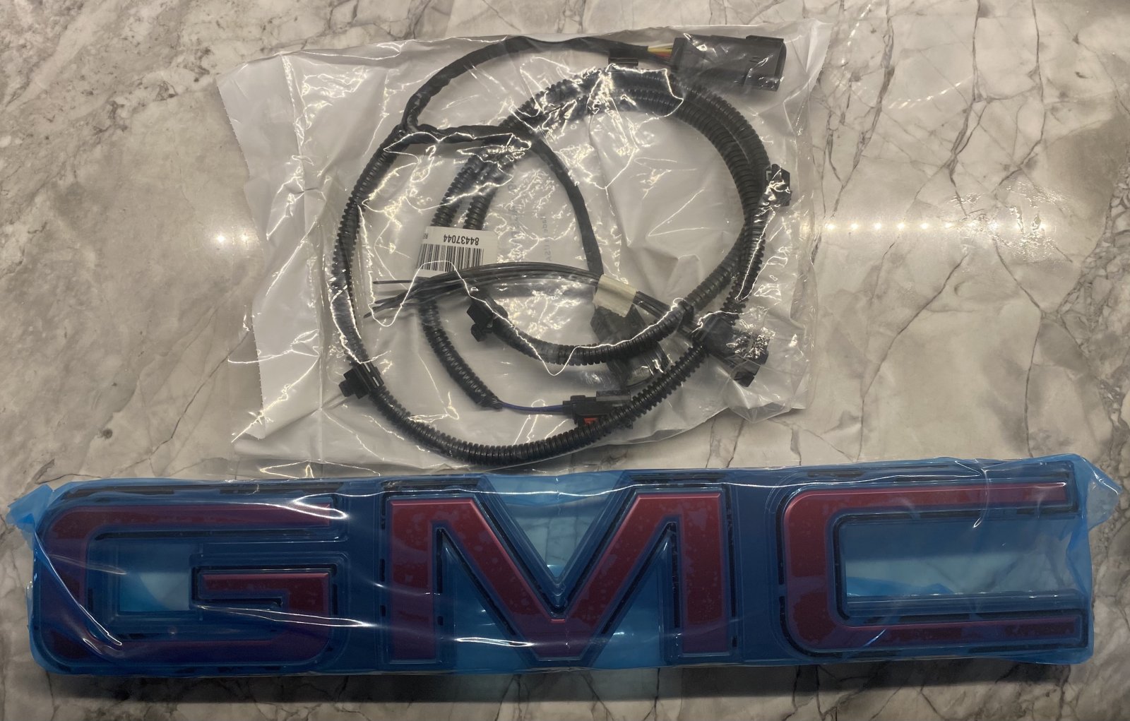

The kit arrived this afternoon, pics attached. Made a precautionary service appt for tomorrow morning in case I run into some snags.
here are pics of the kit. It is two pieces, the wiring harness pt #84437044
The GMC emblem is pre-assembled and all one piece, as opposed to the one on the grill now. I’m not unwrapping until it’s going in but I took pics anyway. On the back on the bottom leg of the M is the female adapter plug in case anyone was wondering where it connects.
no install manual is provided with the kit, just the reference to where to locate them in the SI.
the emblem is very well crafted and feels solid. The backing is black plastic similar to the grill material. There is no chrome outline as with the stock emblem, it is clear all the way around, which is what should illuminate.
very excited to get this in!
