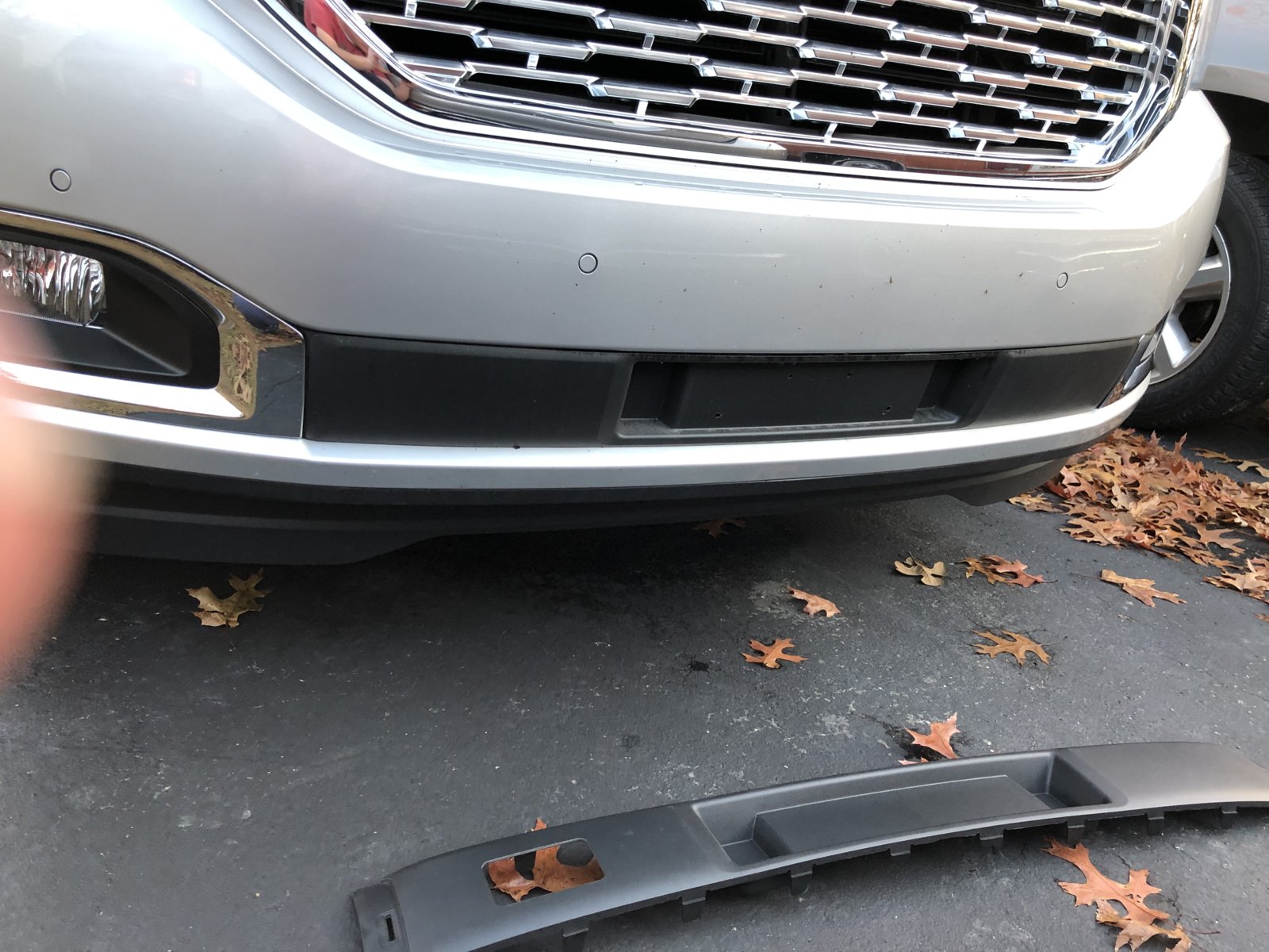

So...I installed the passenger side; still would like a cover/ something to close the trip hole. May have to mod one myself.

TY- The tow hook only works on the passenger side for rigs with adaptive cruise control. the driver side frame rail is filled with electronics. I will post once I have it finalized.

I have a new gm piece with that hole in it. I got the wrong one the first time.... I needed one just like what I had, minus the plate bracket holes.

I have a new gm piece with that hole in it. I got the wrong one the first time.... I needed one just like what I had, minus the plate bracket holes.View attachment 214577
What's the part number for the fascia piece with just the cutout on the passenger side? I'd like to do this install but I have ACC and I don't just want to cut a hole in the fascia I have. Thanks!
See above. I still have the one I bought wrong if anyone is interested in it.

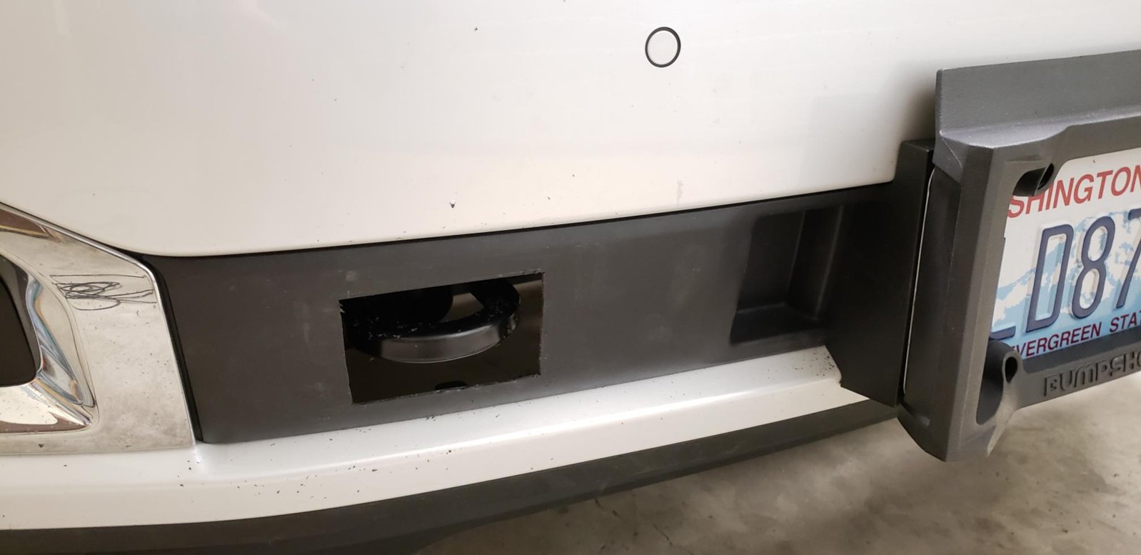

That part number for the one hole facia on the GM site says that it does not fit the 2019 GMC Yukon XL denali, but it looks like yours is a Denali.. Confused I am.
23243960 is the part number I bought. I didn't want the one with the hole. I wanted to plain one because they mounted the front license plate on my truck at the dealership and I hate that.
