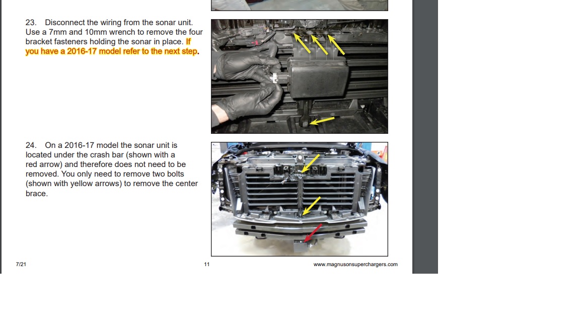

There is a rare fascia panel from the factory that only has the cutout on the passenger side, you can buy that and install only 1 passenger side hook. You can also use your original fascia and cut 1 hole for the passenger hook, or you can buy the 2 hole fascia and only install the 1 passenger side tow hook. Apparently the adaptive cruise sensing module sits right in front of where the driver side tow hook mounts.
