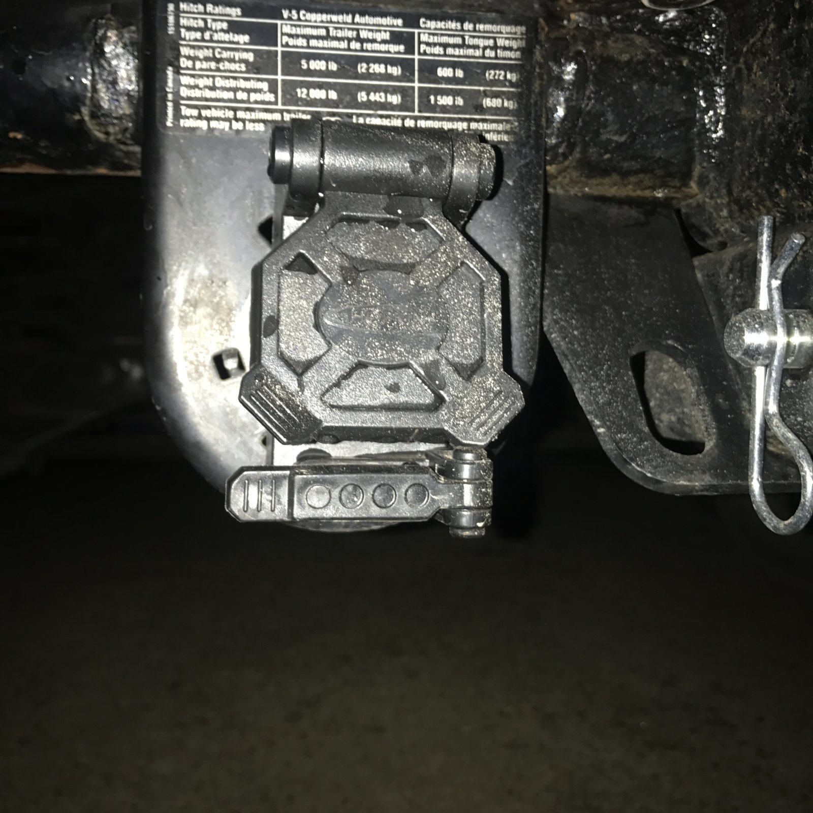

(2) the trailer 7 pin connector has a short some where

(2) Not sure what your symptom is for the "short" but after fighting with my trailer lights for some time I realized the trailer plug is not connected directly to the wires running to the back. It is a split connector and I replaced the portion that is bolted to the frame and all was well.

Thank you for the help. I tried to pull the cable hoping there was a split conection somewhere along the frame but i didnt see one. I will send you some photos of the under side of my truck.

On the stock unit the connector with wires plugs right into the back of the trailer connector housing. The replacement I purchased had wires coming out of back of the trailer connector housing to the mating connector. Take a look at etrailer.com, that's where I get all my trailerin' stuff. They have a nice picture. If I recall the connector lock is on top (you know to make it easier to reach :mad:.

I email the guys at etrailers and they replied with this
Answer:
Check to see if there is voltage on the red wire of the controller when the brakes are applied. It sounds like that is the root of your problem. Typically when this issue arises on a GM vehicle like yours the issue is a blown third brake light fuse which is associated with the brake controller stoplight switch wiring.
Easy way to check that is to see if the third brake light of the Yukon comes on when the brakes are applied. If not then the issue is the CHSML fuse being blown.
It was the fix to the problem. Now the only problem I notice is my right blinker isn't working on the trailer connection and after replacing the fuse my third brake light is still out, I never noticed that it was out.
I'm happy the trailer brake works again. Thanks for the help.
