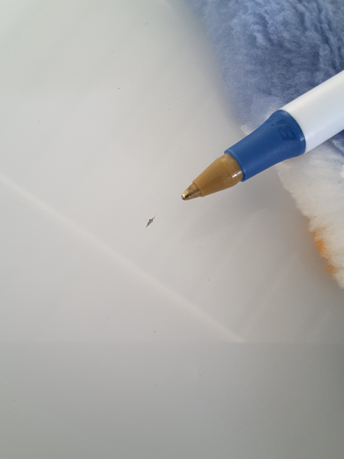

Any idea to treat minor scratches? Like this ...

I don't know what year or model of vehicle, but GM Parts sell touch up pens that are made to match paint codes on vehicle.

depending on your skill level, i usually find automotive paint to match...clean and fill the chip, then lightly wetsand with 2500-3000 and polish back out.
most chip repairs looks worse because the new paint sits on top of the old clear, that portion needs to be removed leaving the paint only in the low of the chip

Dr. color chip isnt bad, but more noticeable that a scuff and polish
