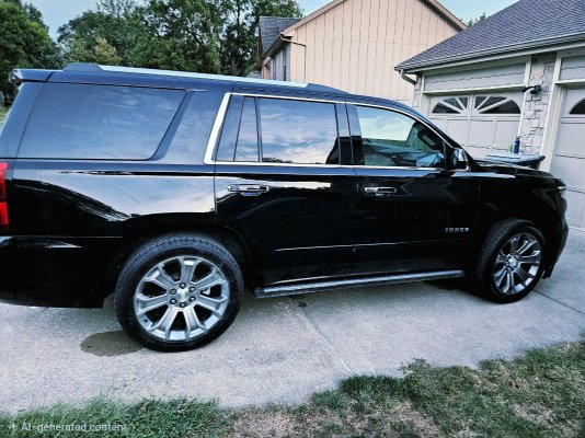

Thank you! I got a couple of these beasts 2004 Yukon SLT and a 2017 Tahoe premium I trust the Yukon more than I do the Tahoe at this point. I already had transmission problems now I'm facing suspension issues
