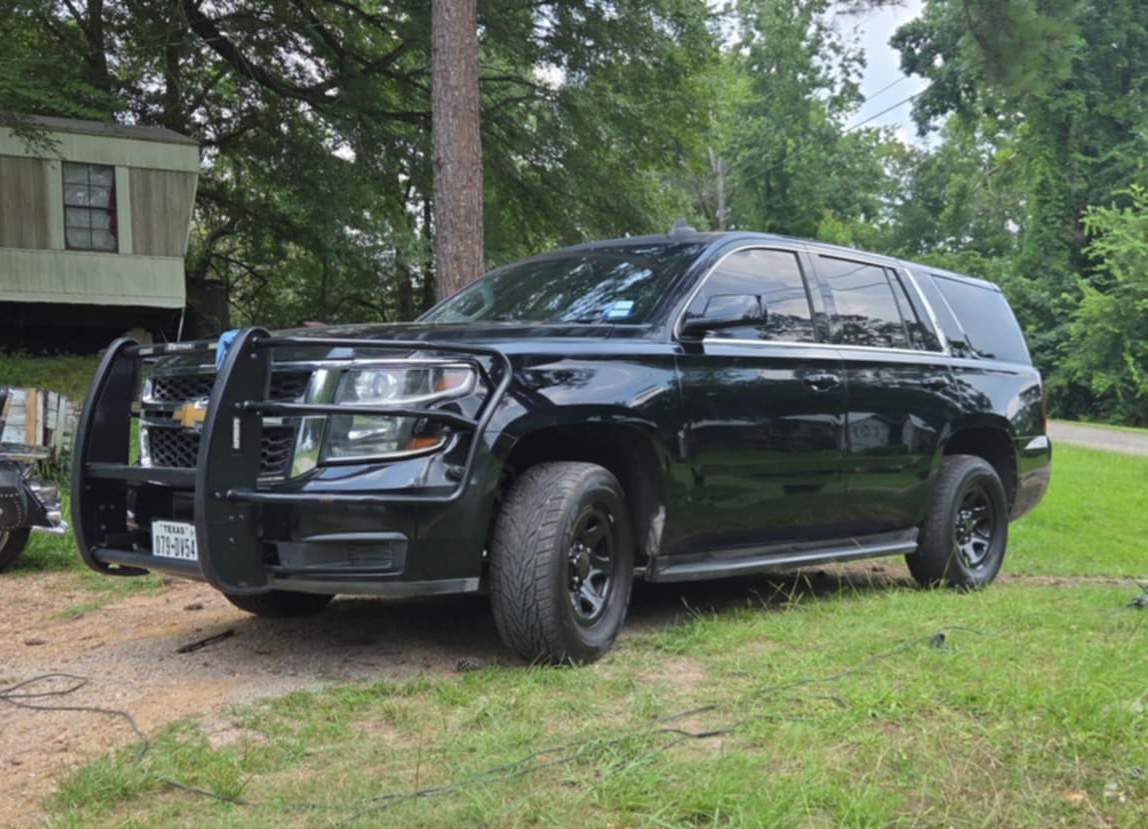

I live in montevallo Alabama, basically the direct middle of the state. Im looking for a good tuning shop for my 2017 tahoe. It has stage 2 cam built transmission, full heatesder back exhaust 3in. It was tuned by what seems to be a very unknowledgeable tuner, possibly new to these vehicles. Its very poorly tuned along with the transmission, this was done in Texas before I got it. I have fixed almost all of the issues that that I can find except some minor exhaust work. And now I need it properly tuned so my fuel gauge doesnt drop dramatically after idling for 5 min, and it doesnt go through spark plugs in 1500 miles, also I would like to be able to actually hear that it has a cam. I heard it for a little bit when I replaced the ignition components and fixed all kinds of issues.

It ran great for a week or so after everything was replaced and little issues fixed, like poorly connected and also cracked pcv lines, stripped our header bolts that were causing leaks. All of the repairs were made before the full tune up was performed. The it slowly started running worse and back to almost how it was before the tunenup. The plugs were fouled out within about 1500 miles and the exhaust reeks of a very rich air fuel mixture. I also know the guy that tuned it admitted to not know very much after work was done.
