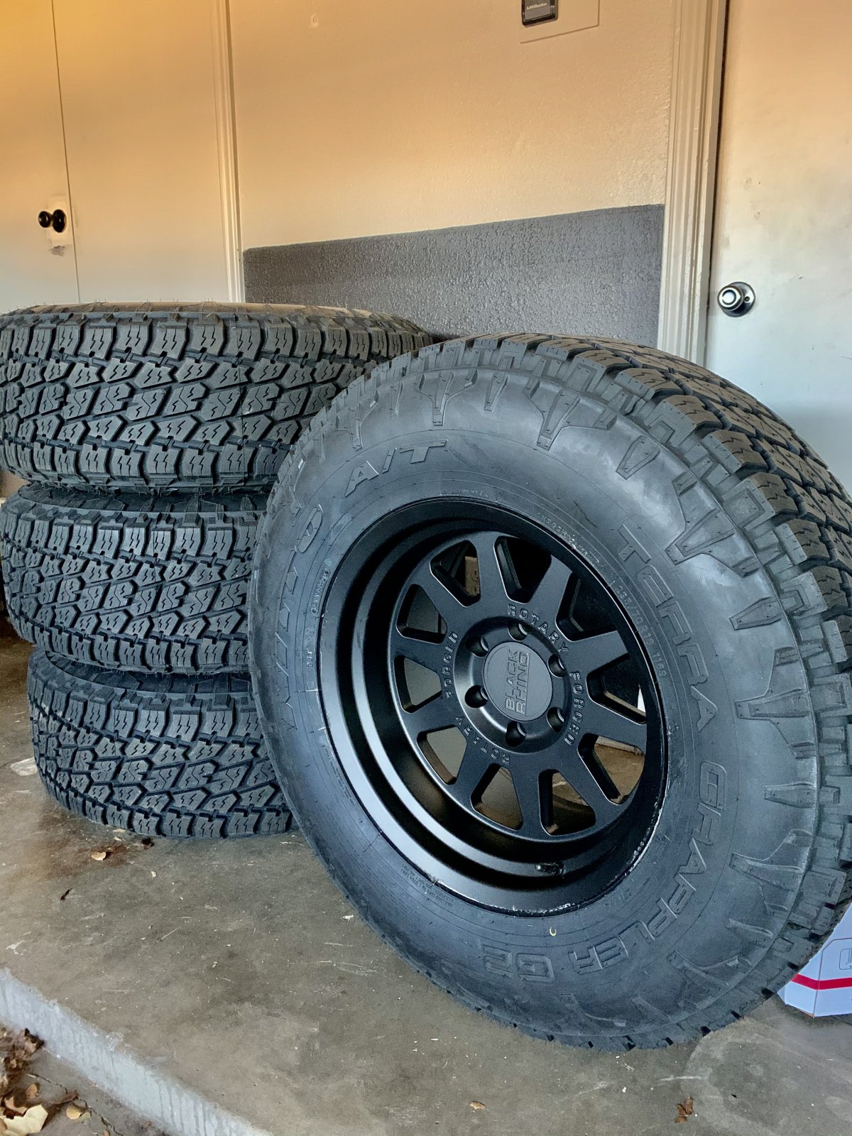

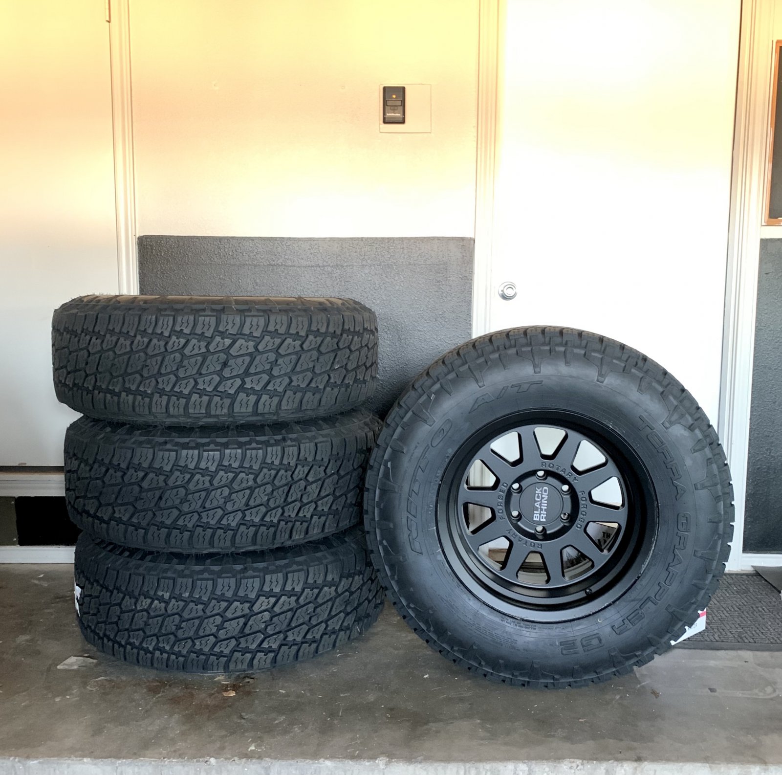

Do you have a close up pic of the wheel tire setup? What setup did you go with? It looks great from the side
Nitto came out with a non 10ply 295/70 34.3” tall and 11.7” wide. It weighs 15lb less than the LT295/70. Perfect for us highway queens that hardly ever tow or go off-road but want the same aggressive look.

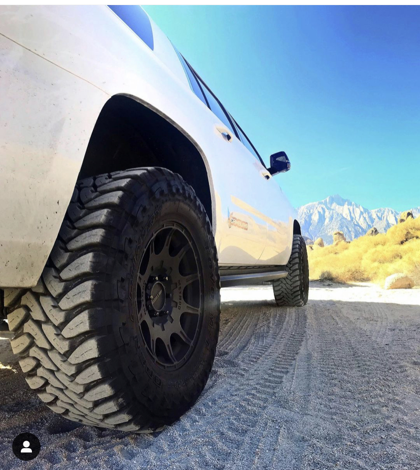

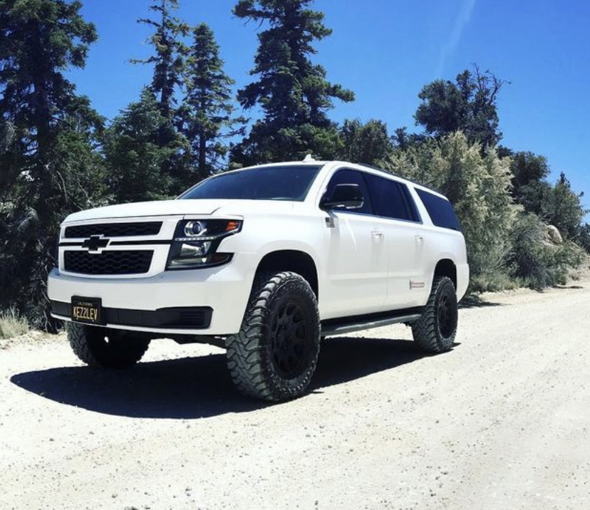

The wheel is 18x9.5 -18 offset. Just have to wait to get the lift installed before I can fit and trim for these to be put on. The rock crawler suburban on the first page was the offset I was shooting for. Slightly outside fender.

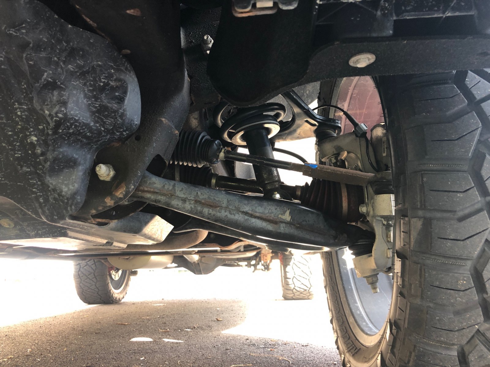

Admittedly when I see angles like this coming down the road I wonder about longevity of their LCA ball joints.

Nick, i would venture to say that the rear control arms probably touch the mount when cornering hard...the lift will cause a slight offset due to track bar length...making the arm closer to the mount, then a sharp turn forces flex of the bushing...and YOU have a slight clunk noise.
and thanks for that pic, it really helps highlight the upper arm joint angle. That solidifies my mind on knowing the upper arm replacement is needed for a 2.5 level.

Thank you for the feedback, I'll check them out. Might be worse with the 3" in the back then, so if I'm still hearing it more reason for the adjustable track bar to get the axle re-centered.
You're welcome for the pic, glad I could help. I'll share a pic of that area after the ReadyLIFT install as well.
