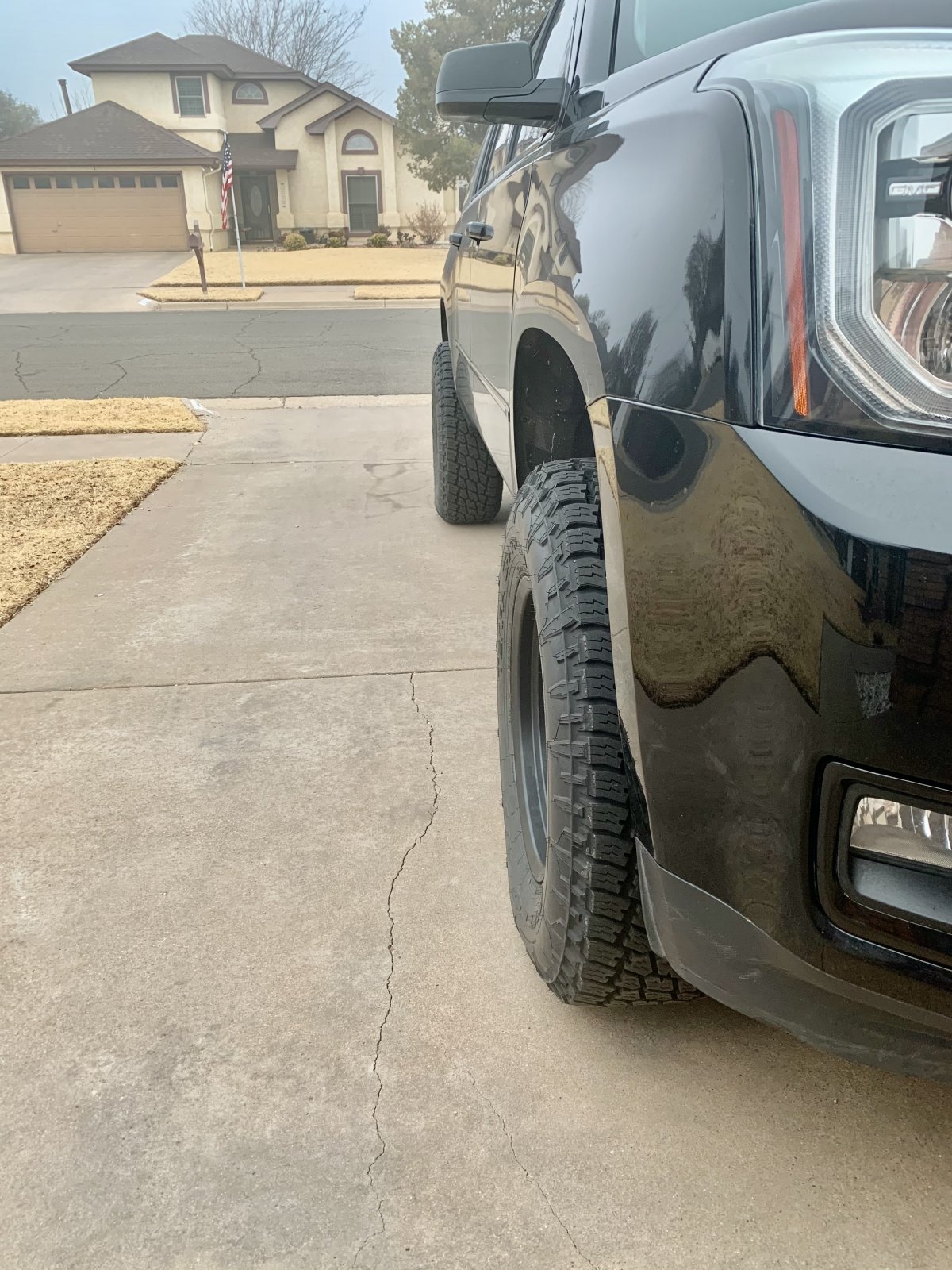

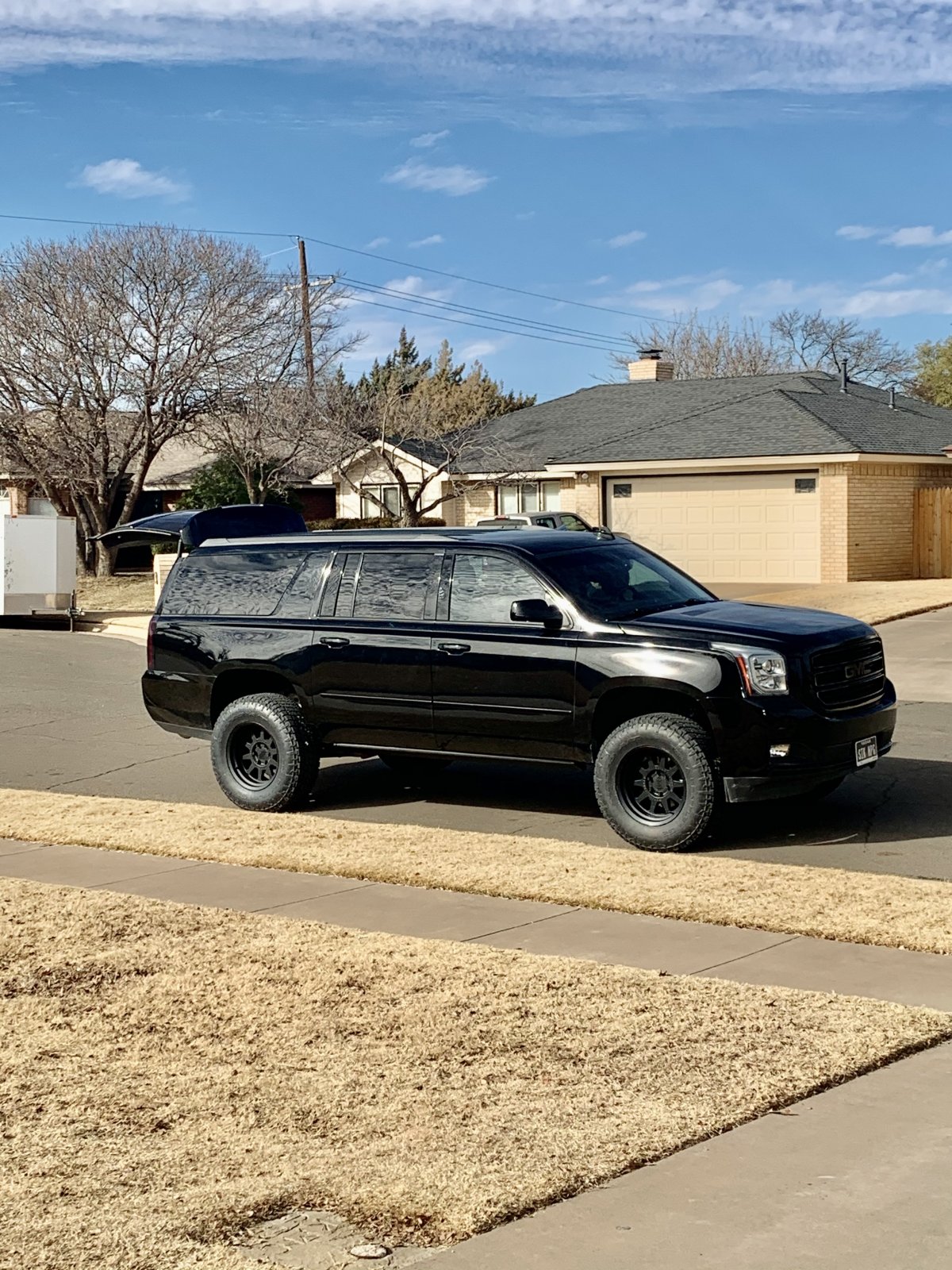

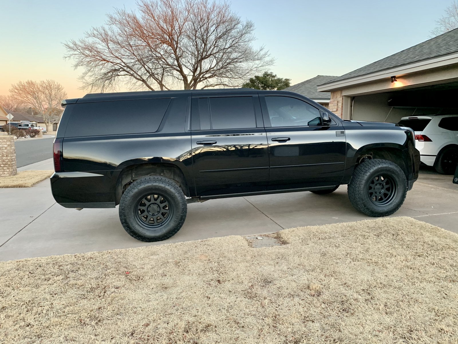

Upper rear isolators on with no issues here.
Currently on a little highway trip
And so happy with the ride! I’ve been in such a rush today i haven’t been able to put a tape measure to the fenders but I’m guessing 42” front and back. That’s with the 35” tires so makes sense that it would sit a little higher at the fender. Tomorrow I’ll for sure post some measurements. Ride quality is def Better than the Fabtech budget kit I had.

Thanks for checking, sounds like I have some more arguing to do.
Can’t believe you were able to get 35’s in there with some offset, looks AMAZING

that stance is perfect ( and i dont mean the offset of the wheels), stance is how the truck sits, and yours nailed it.

That Looks awesome, man. Very elegant. How much trimming to fit the 35's?

Heavier plastic trimming was done to accommodate the 35’s. No metal trimming however. The vehicle doesn’t run any at full lock on flat surfaces. I do have a little rub when hitting inclined:declined surfaces slightly when turning.
Front Fender measured 41”. Rear Fender measured 41.5”. This is with the Monroe front struts and Monroe Rear shocks (bypassing autoride). And yes I agree, the PERFECT stance. Very subtle rake and when I throw some weight in the back it sits level. I honestly wouldn’t mind another 1/4-1/2” of wheel offset but it doesn’t bother me. I’m pretty sure my OCD will kick in and next time I buy tires I’ll go 20x10 -24. To me that would be the perfect! (current wheels 9.5 wide and -18).
Like I said though, ride is SUPERB for my taste. The perfect highway queen that saw no decrease in ride quality over the soft factory riding setup. My Speedo is off by 8mph but I’ll be hitting up Blackbear.
Already received compliments on it at Lowe’s and Advanced Auto Parking lots

Dude that looks amazing. Very nice

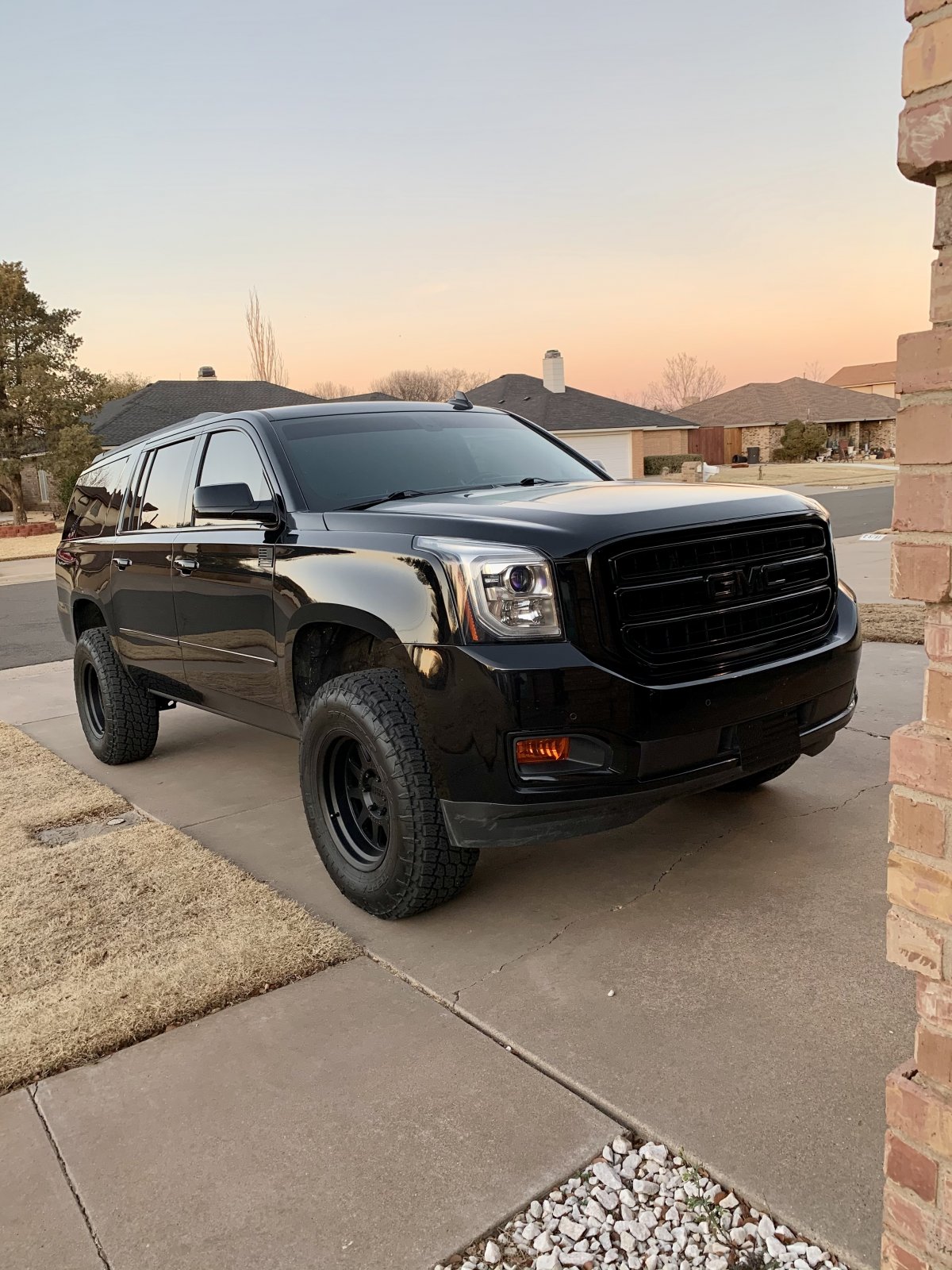

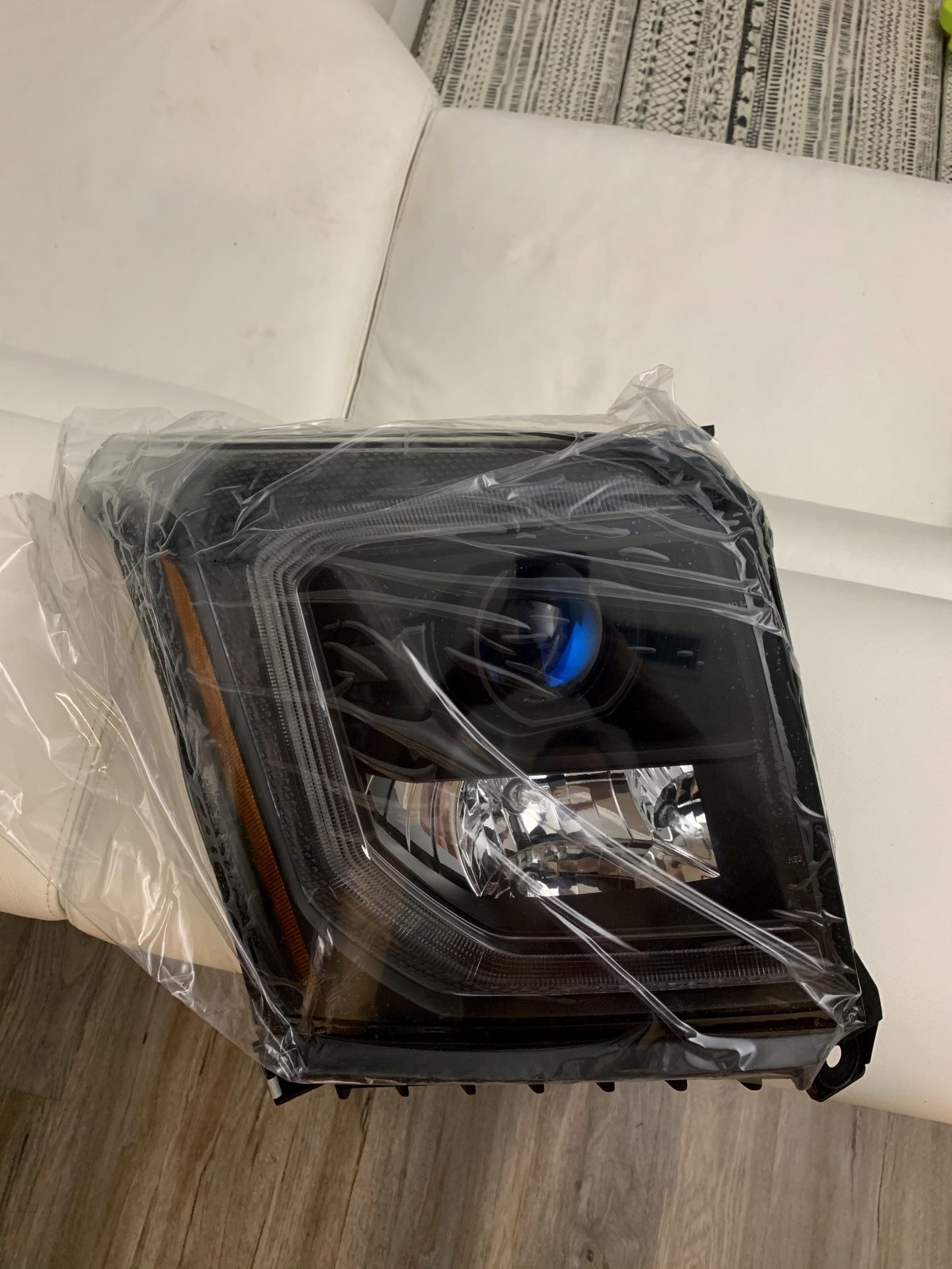

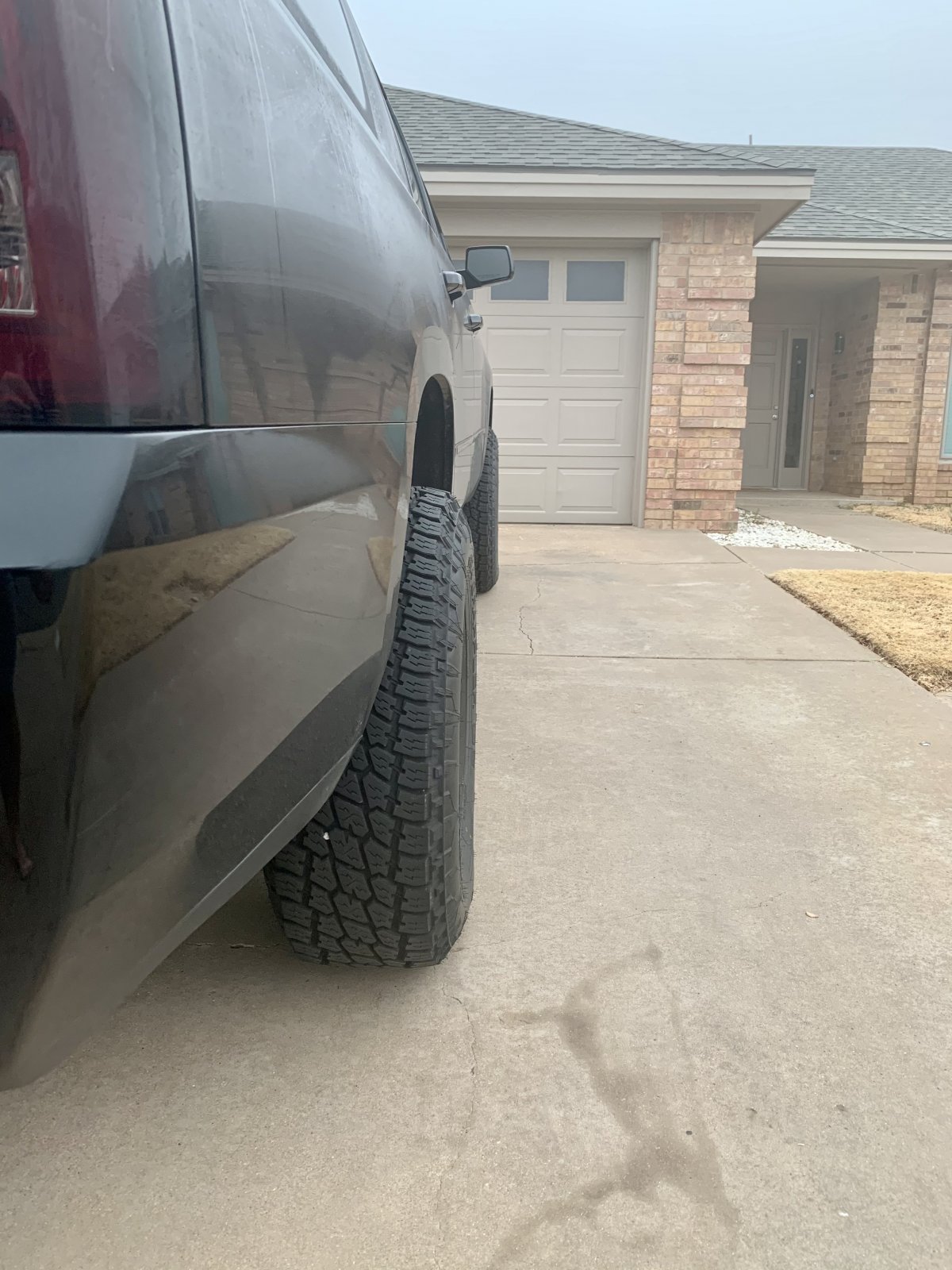

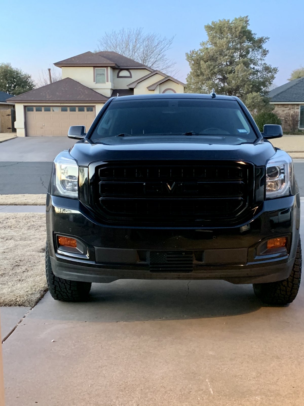

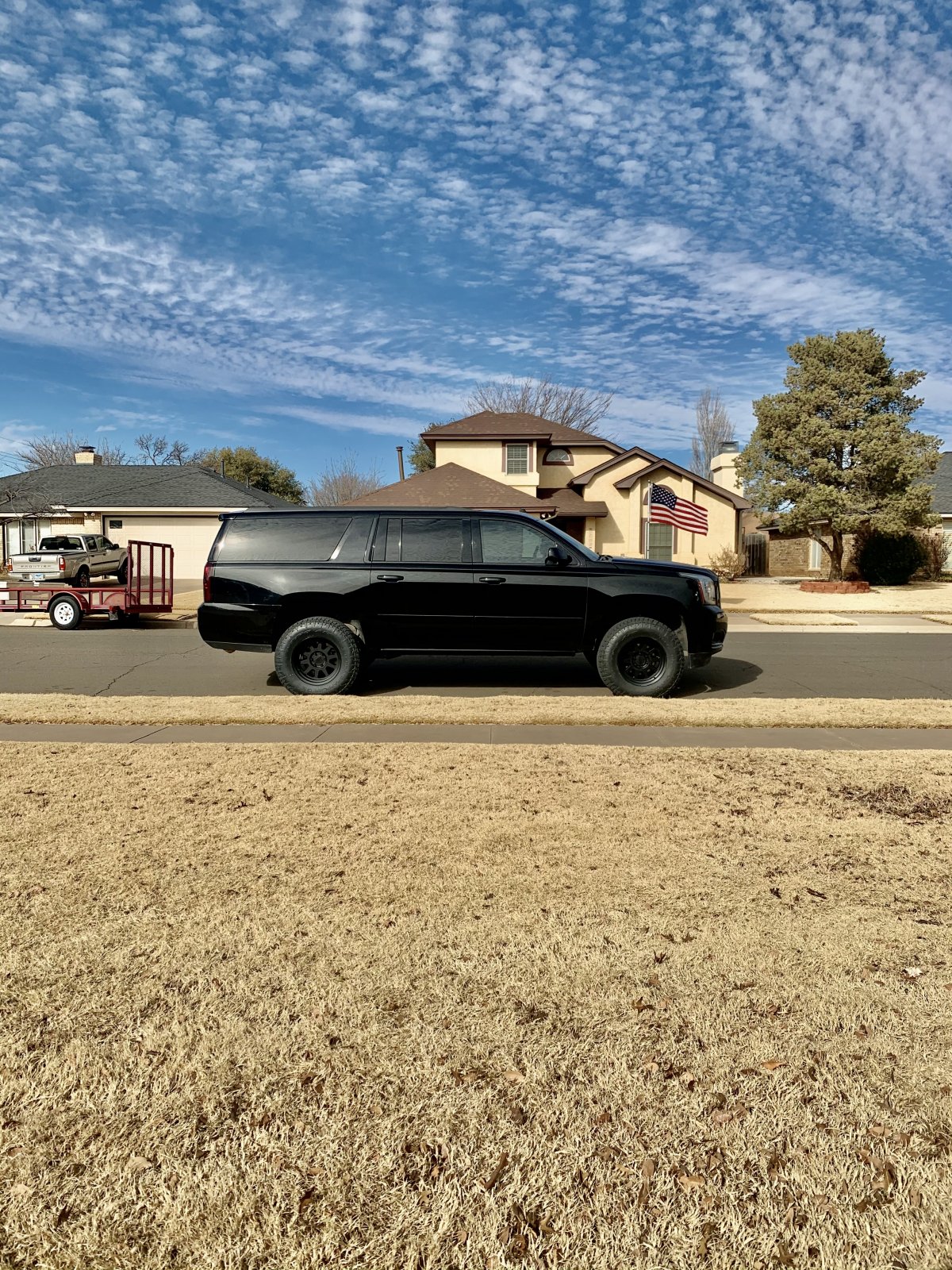

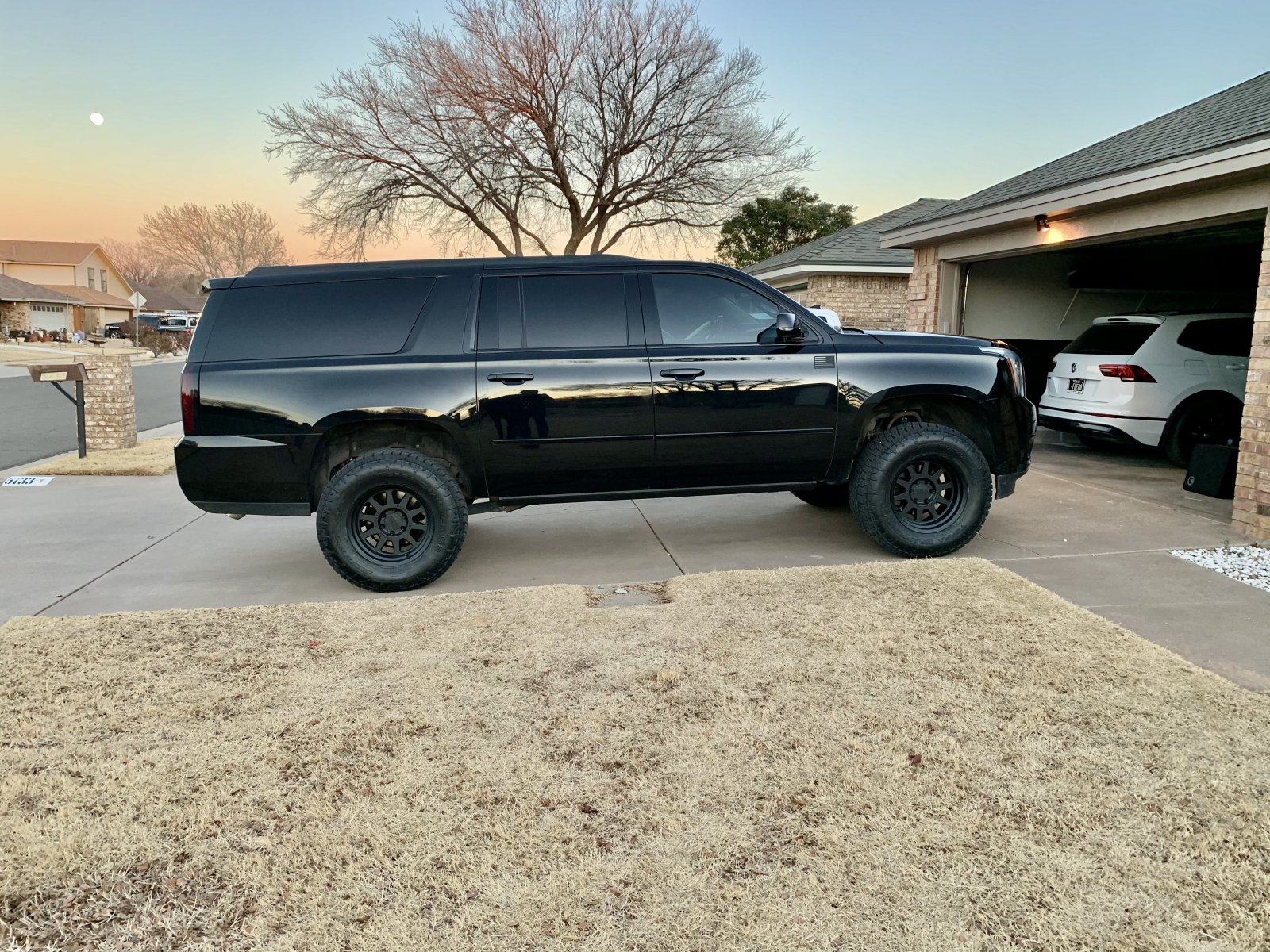

Black Headights aren’t on yet but here are some more pics.
Once I get the new headlights installed and some of the matte black accents I’ll
Get some more pics. I just noticed the pics were on a slanted drive too but I’ll go flat ground photo shoot next time

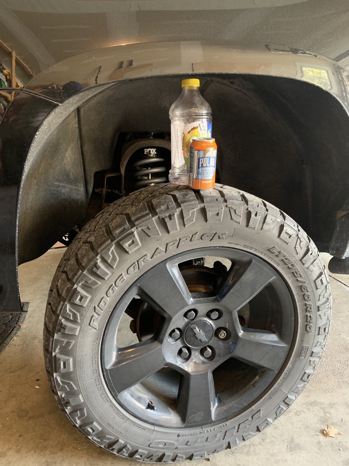

You guys are killing it on this thread! - Seriously, I'm inspired.
Still have some tweaks to do; I'm trying to get my stuff together so I can post a full write up about the v3.0 Tahoe. Sitting at 42.5" at the front fender and need to bring it down a little bit.
BUT, wanted to get you all a teaser photo...

NOKTURNAL....LAMIX FILM ON THE FOGS ???? looks good in that color

yes sir. I like how they pop and match the amber corner lense on the headlight. Went back and forth on whether I should’ve gone smoked or kept clear....but it’s hard to resist the off-road fog look. I’m also a Univ of Texas alum so you know I always dig me some orange.
