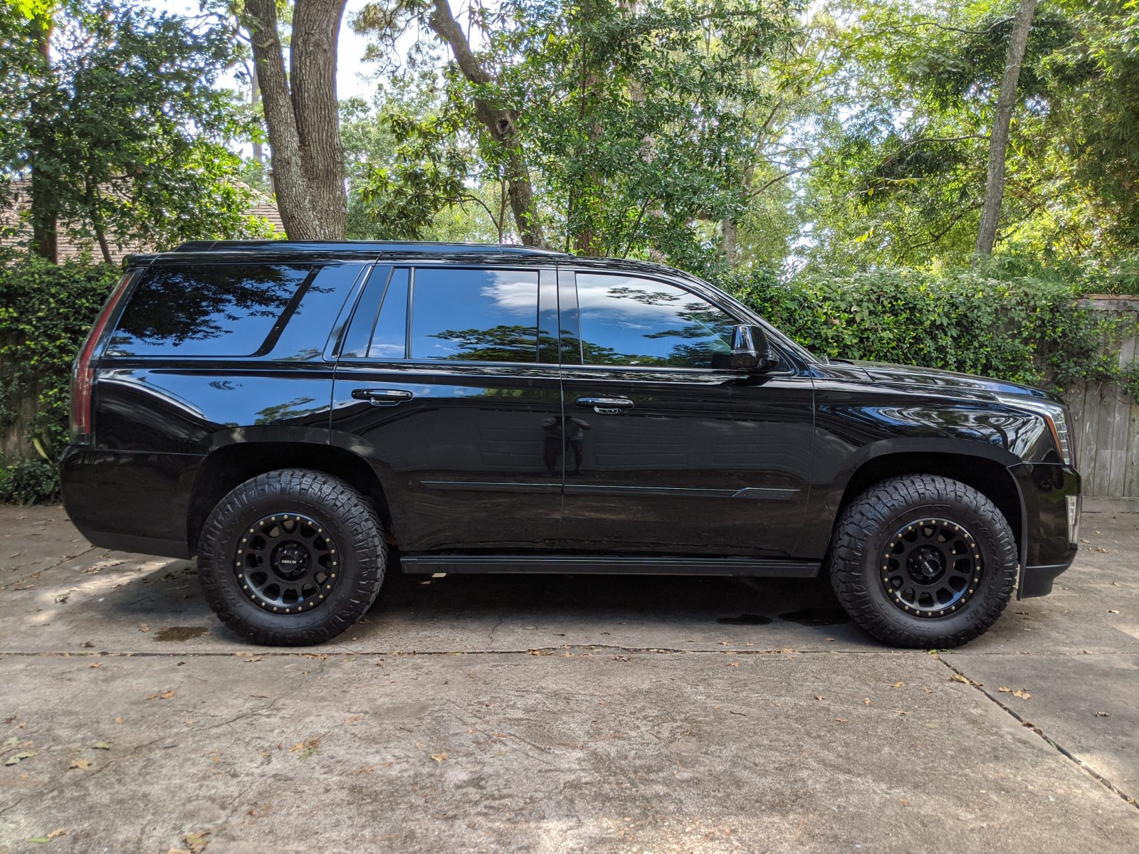

Here is my truck on 33x12.5s on factory suspension(yes it rubbed in the front).
Now here is my current setup with the monroe struts and more street wheel/tire setup

Here is my truck on 33x12.5s on factory suspension(yes it rubbed in the front). View attachment 266193
