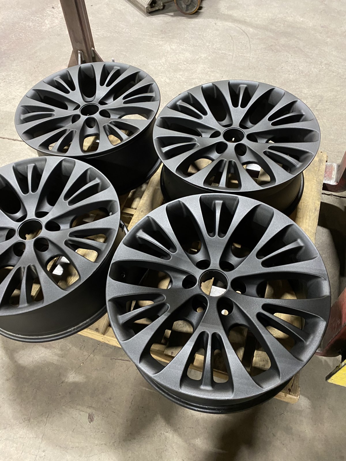

I did stock wheels powered coated. Have a one off Kelderman set up for the ride keep it stock look. Running airlift 3h controller was going to lift but use for every day so stock is nice. Black grill is in the design stage hope to have it done soon

I did stock wheels powered coated. Have a one off Kelderman set up for the ride keep it stock look. Running airlift 3h controller was going to lift but use for every day so stock is nice. Black grill is in the design stage hope to have it done soon View attachment 265642View attachment 265643
Well hells bells, I wouldn’t mind knowing more about your suspension setup.
Wish it was available to all. They stopped making and sale if it a few years ago. Was sold as a leveling lift kit to fit 22-24’s for old body style. Helps to be an inside at Kelderman to build my kit. I added airlift to it and made other mods to make it fit.

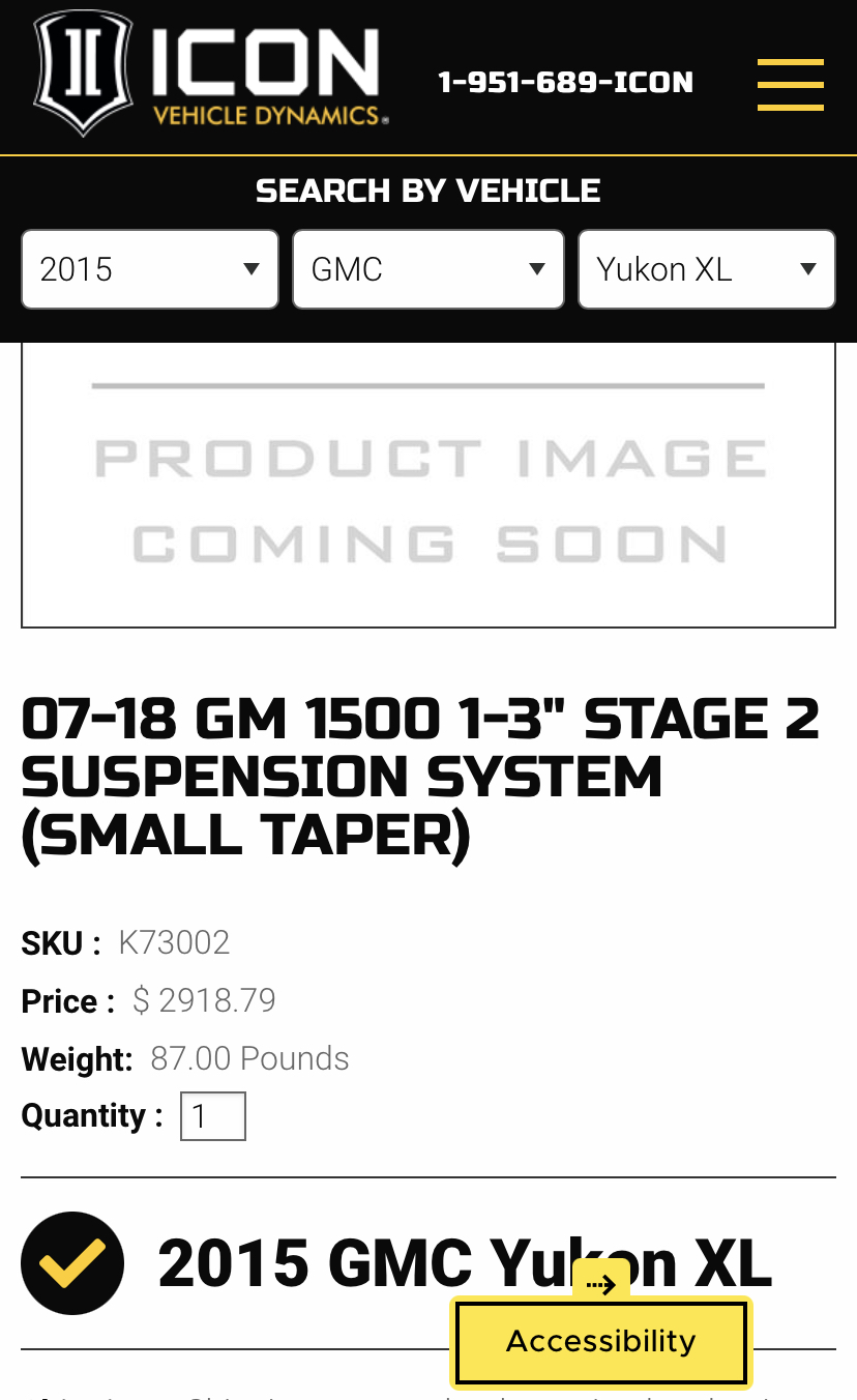

i would ask specifically about the UCA...reason being, the center opening area is key to clear the 2.5 or larger coil over.
just raising a concern that i was informed of, i was told the Icon ( https://iconvehicledynamics.com/acc...07-16-gm-1500-tubular-uca-dj-kit-large-taper/ ) is what most seem to recommend.
if i recall the last set of Zone UCA's that i purchased, they were beefy bout a boxed design that may not have enough clearance. the Fabtech look very similar in design to the Icon.

i would ask specifically about the UCA...reason being, the center opening area is key to clear the 2.5 or larger soil over.
excellent point! I need to check if the beefy 2.5 will slide through the Fabtech UCA
It shows the icon 2.5 (basically same as Fox 2.5) is available also in the small taper UCA. It’s way over my head the difference in why someone would want a large taper vs small taper. However, it does show at least the 2.5 is compatible w small Taper UCA
