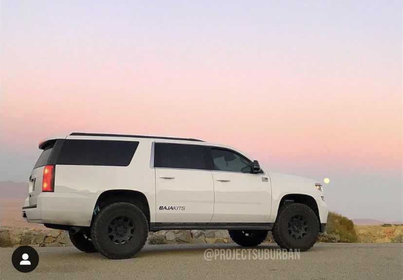

What do y’all think? The pic is just a burban with 2.5” lift upfront from king 2.5’s. He also has 35’s which look awesome but man is not sure how they cut enough for those to work lol but they did.

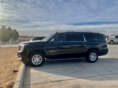

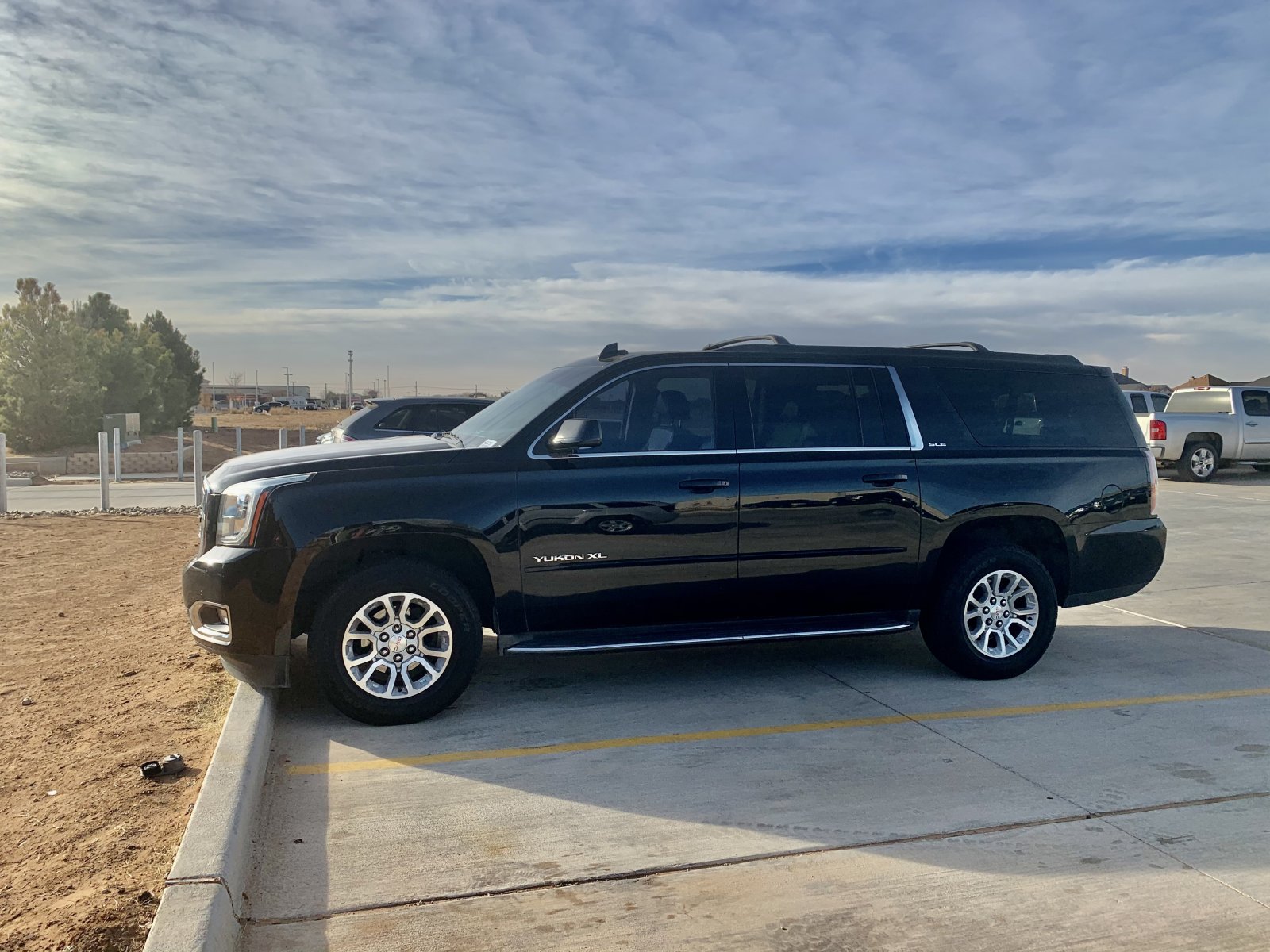

Here’s the grandpa grocery getter! She won’t look like this for long. Updates to follow or other suggestions on above if necessary.

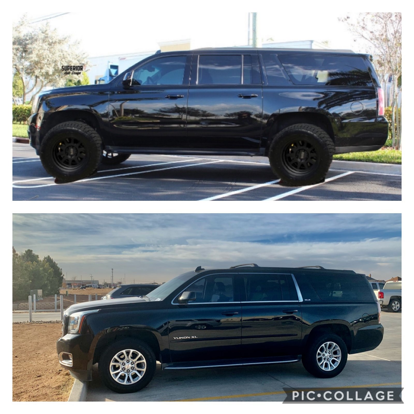

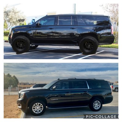

The final result should look like this! I’m pumped. All my vinyl blackout is ordered. My windows are already 5% ceramic all the way around. And I’ve got my all black gmc grill headed this way as well.

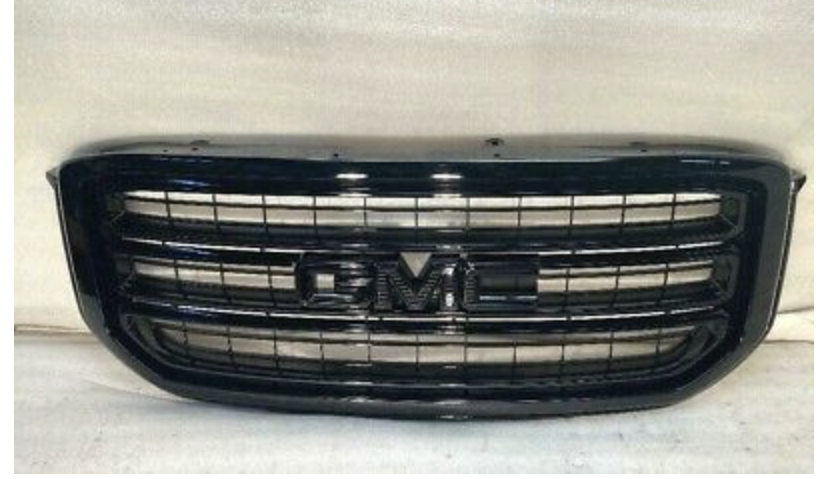

Place in Michigan foes these OEM brand new GM part blackouts for $279 shipped.

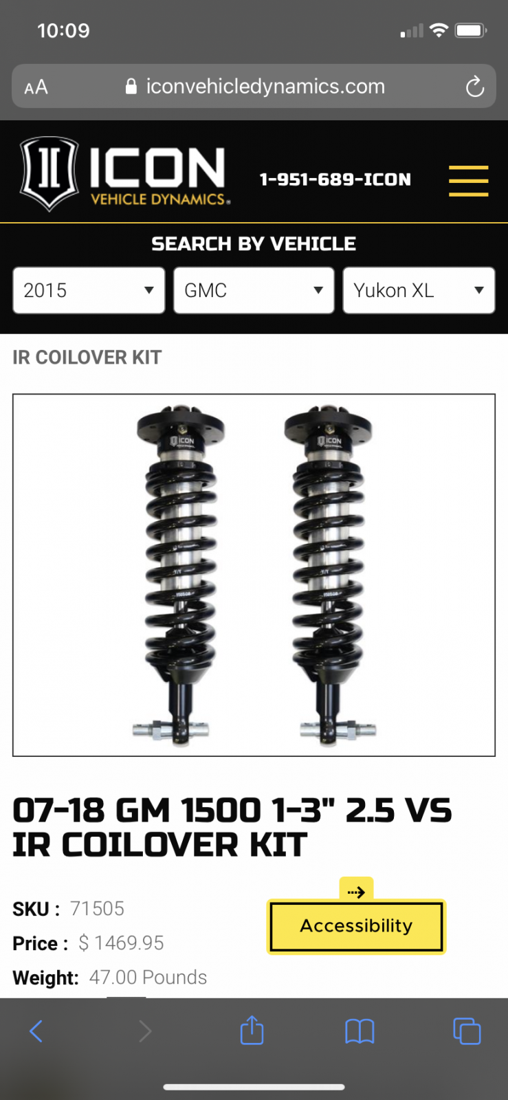

Icon shows to have a 2.5 coilover that is capable of 3” as well.
for the rears it shows the 2.0 replacements are 0-2”. Does that mean you can adjust those to Achieve more height (2” lift) without using a coil spring spacer?

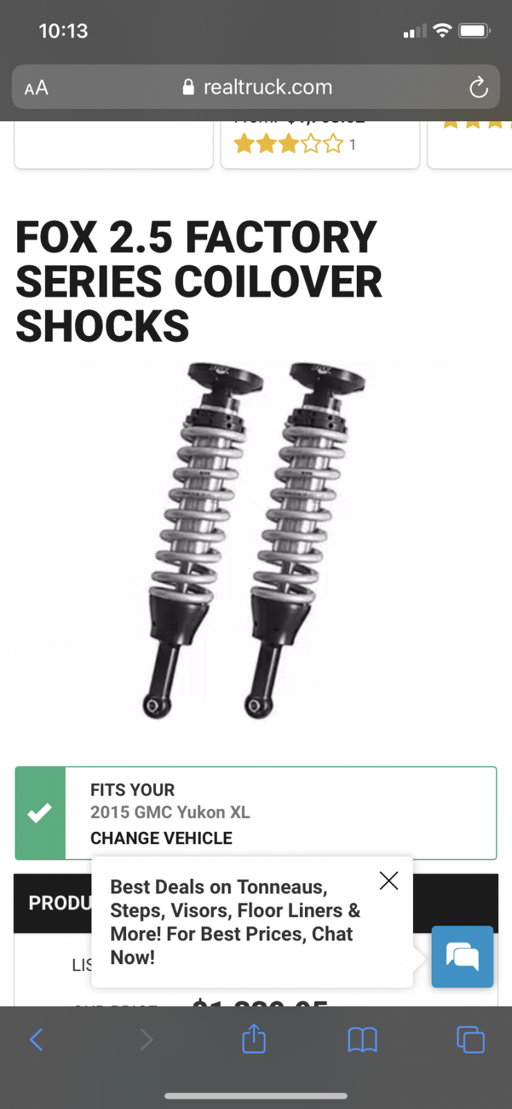

And as shown earlier the Fox 2.5 coilover doesn’t mention the 0-3” ride height adjustment but can you guys verify that’s true that they’re capable of that?
I’d rather Keep it all Fox if I can and the Fox 2.5 are slightly cheaper.

Can Anyone confirm the Fox 2.5 factory series coilovers do add 3” lift? Same with the icon 2.5 coilover? I’d rather just do that and skip the lower strut spacer

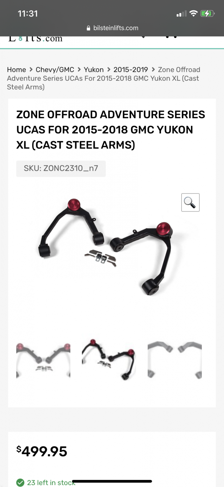

These were the UCA I was going to go with whether it be Fox 2.0 or Fox 2.5 coilovers.
