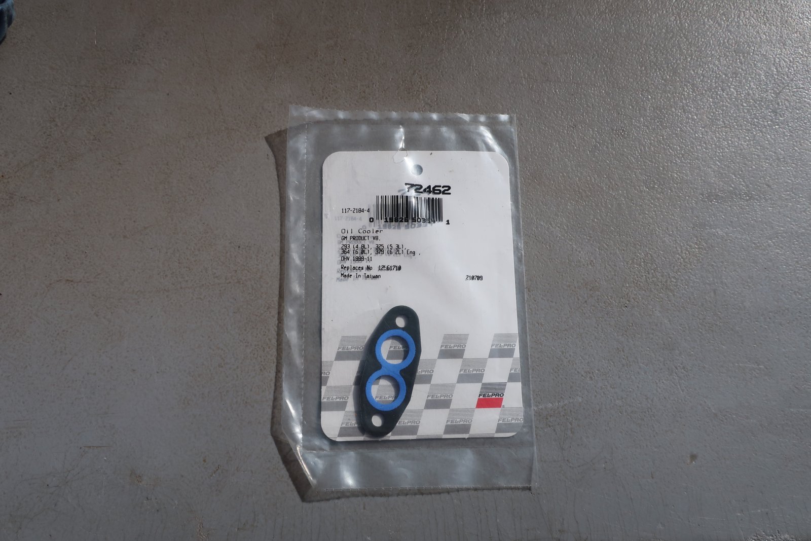

-noted oil seeping from the oil cooler lines adapter at the block last oil change. Installed a new Fel-Pro 72462 gasket. I had heard the OEM replacement gasket was to be avoided. I carefully torqued the little bolts to spec of 106 in/lbs, having heard stories of people breaking them off.

New Fel-Pro 72462 oil cooler lines adapter to oil pan gasket.

Fel-Pro gasket at top, OEM gasket at bottom, and the tiny bolts that go with it.

Nice work. I had the opposite problem with that gasket though. Couldn't get the Fel-Pro to seal. Ended up back with OEM on my 2012 and it's sealed up.

I didn't like the FelPro.. Prob the first time ever !!!
And the OE obviously has issues.. I found the MAHLE that is still
the metal but is built better than the OE... The felpro IMO needs
to have a metal or solid base under the sealing surfaces
Well...I will find out soon enough. Thanks for the info!

Well crud. There are a couple of oil drops seeping from the oil cooler line adapter to the oil pan. Looks like I am doing this job again. Mahle/Clevite seal instead of the Fel-Pro this time. :confused:
if it's the block off plate and not the oil cooler block. there's an aftermarket one with an o ring that usually fixes it.
I think that will fix you up. Sorry that's happening.
