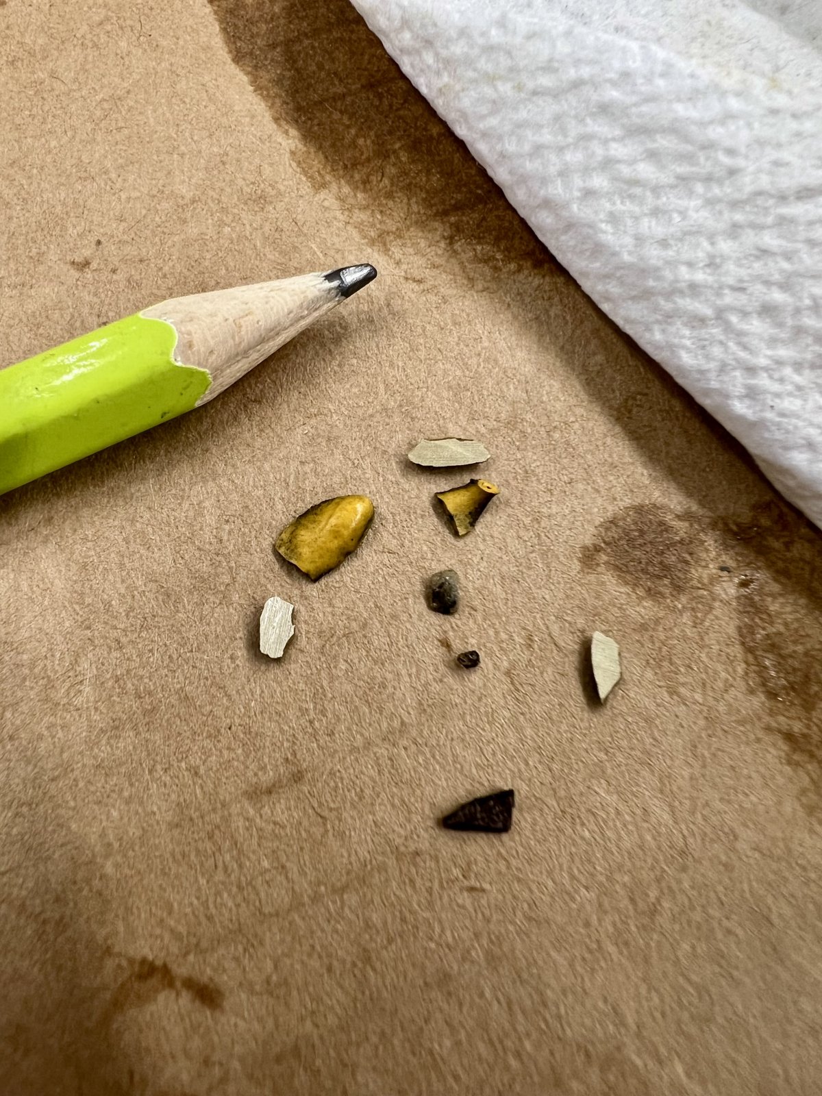

I have a 2021 GMC Yukon XL Denali with the 6.2L engine. For the first 3 years, all oil changes and maintenance was covered and performed by the dealer. Last year this maintenance ended and I personally did my first oil change on the truck at about 40K miles.
After I finished that oil change, I did another on a different vehicle which I no longer own. When draining the spent motor oil out of the drain pan I noticed some debris which remained in the bottom of the pan. I did not know which engine it came from as I had just changed oil from two different vehicles.

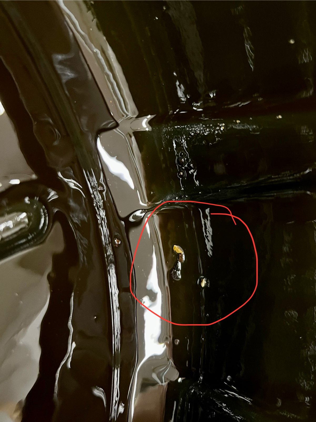

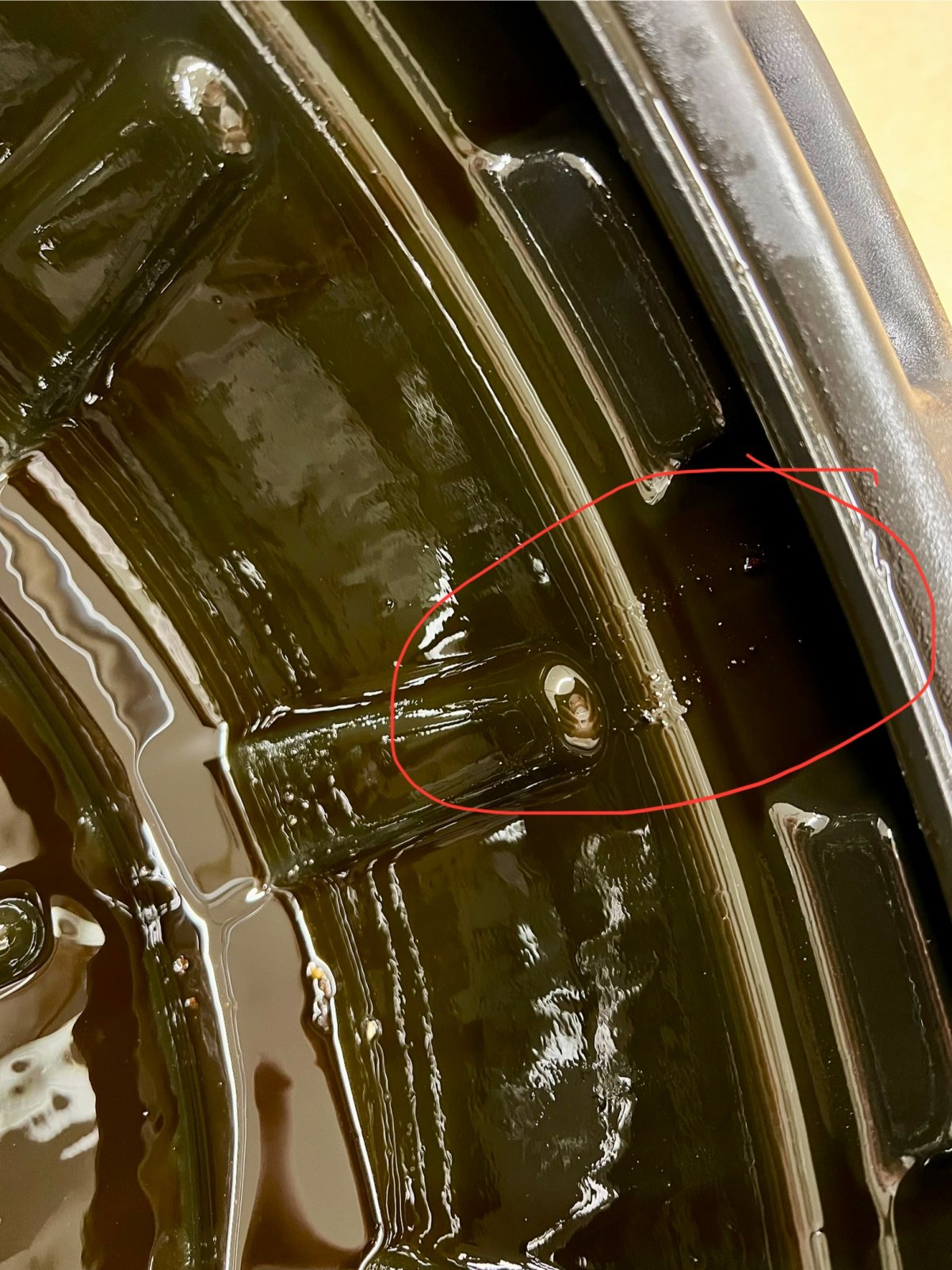

Fast forward a few months to this weekend and my Yukon now has about 45K miles on it and I just performed another oil change. I made sure to thoroughly clean the drain pan before I started draining the oil out of the engine. Sure enough, after I drained the spent oil out of the drain pan there were small bits of debris left in the drain pan. Some were actually rather large. The largest pieces I recovered from the spent oil were yellow, non-metallic, and somewhat brittle. The other debris found was a bit smaller and gray in color. All of the pieces seemed like they could be plastic as I was able to break them apart. Attached are a few pictures. I did not find any metallic looking bits in the oil but I did collect a sample and will mail it off tomorrow.
Any idea what this debris could be and how concerned should I be?
As a side note, when draining the spent oil back into the containers I wound up with about 6.25 quarts. The engine takes 8 quarts. I know some is obviously lost in the oil filter but I allowed that to drain upside for a while. There was not a low engine oil light on before the change. Unfortunately I did not check the oil level on the dipstick before the change. Is 1.5+ quarts of oil consumption normal for these engines over about 5K miles? For reference I am using Mobil 1 Advanced Fuel Economy Full Synthetic 0W-20 and a Wix filter

Plastic debris ? Maybe timing chain guide?

I just spoke to my service advisor and he is pretty stumped on where the debris could be from that was found in the oil. I am going to bring the filter in to him to take a look. Unfortunately he does not think GM will authorize any work without there being an obvious problem. Apparently debris in the oil is not an obvious problem. He did say that they could perform the next oil change themselves and look for similar debris. Finding debris on their own might allow them to do some sort of diagnostic work. We will see...

As far as the Dealer saying Trust Me, we will change it and determine the issue. I would want to be there and witness the oil drain and inspection. Just to make sure nothing is swept under the rug. The plastic is probably from a timing chain tensioner failing. They know this also but their goal is to get you past warranty while your goal is to have a good engine long term.

Back to the original posters question about debris in the oil pan, I would bag what you have and put the date and mileage on what you found. Wise idea to actuallly have a clean drain pan to look for debris and such when changing oil. You might want to consider running an oil analysis on your next few oil changes to see if you have any high wear metals as well. I would also probalby write an email to the dealership Service Manager to include pictures and the description of what you found. Specifically ask for a response, inquire whether they have seen similar things in the past, do they have any specific recommendations as to what action you or the dealer should take. Then hopefully you have a "documented" exchange about this issue in case you have some sort of catastophic problem beyond the powertrain warranty. This may help your case if you do have some future failure.

I got my oil analysis results back and everything came back perfectly normal. No values were out of whack or off.
I also emailed the service manager about the debris found in the oil and they stated they had never seen something like that before. They offered to perform the next oil change and have me present to see if anything is found again. I have saved the filter from the last oil change as well as the debris that was collected in the drain pan.

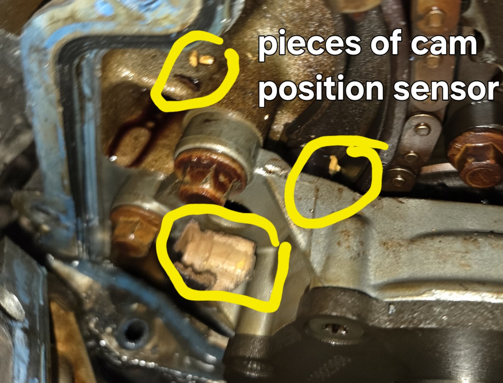

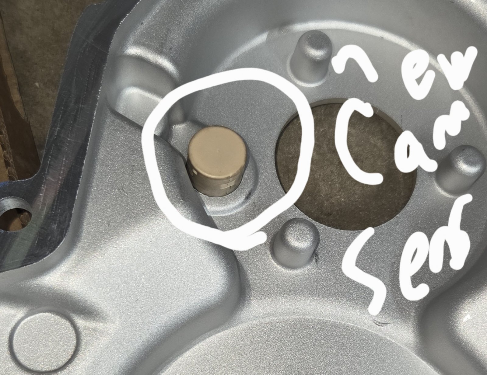

I just did some unplanned cam position sensor, water pump, timing cover, oil pump, timing gear and chain work on my 278,000 mile 6.2 L non AFM Yukon when I tried to simply pull out the Cam PS, but ended with a drilled, fragged, multiple pieces camshaft position sensor.
Those plastic colors and cylinder like shapes definitely look like sensor pieces. Not so much like timing chain guide which is lighter and squarer. I certainly think the crankshaft position sensor and/or camshaft position sensors looked exactly like the pieces that you have there. I think there's something wrong inside your motor. You or the dealer could easily pull the camshaft sensor (at least on the gen 4) and see if it has all of its parts still attached. Unless someone was throwing walnut or Pecan shells into your oil...
