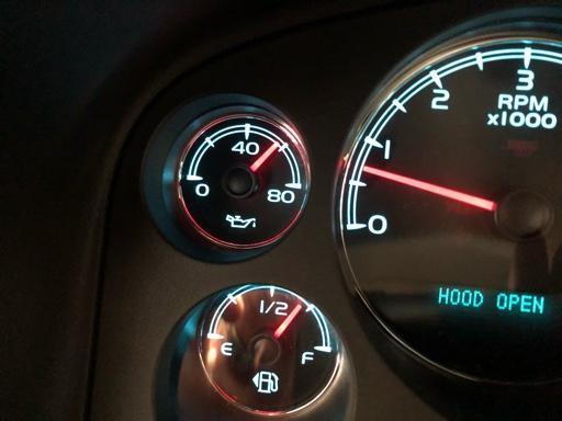

As of 30 minutes ago, WE ARE RUNNING!!!! Fired right up, had almost immediate 50 psi oil pressure 60 psi at 2500 rpm, and almost ZERO lifter noise. Pic below was taken after I took my foot off the gas so the pressure hadn’t come down yet. Hooray!!!! Gonna finish buttoning it all up and take it for a test drive. That BTR stage 2 cam has a sweet lope to it too.
