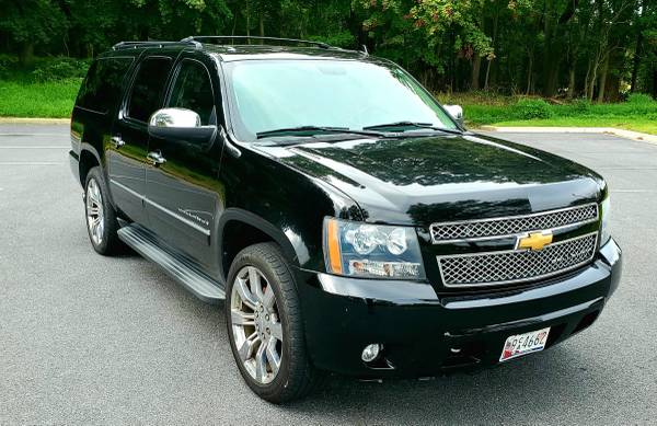

Recently bought a new to me 2012 Suburban LTZ Callaway CS450 450HP with 94k miles. I plan on using it mostly as a second vehicle for towing my boat and camping. The 22 inch wheels have some corrosion. I have been trying to decide to replace them with stock or customer wheels. Not sure what others have done and if there are any recommendations on replacement wheels. Wondering if there are any things that I need to keep an eye on for issues.

It really depends on your taste. There are tons of wheel and tire combos out there. As long as you keep the same overall circumference tire and close to your stock wheel offset you’ll be fine. Take a look at some of the pictures on here to see which wheel strikes your fancy.

Nice ride! I'd go for a set of 2020-2021 new takeoff wheels/tires, the new trucks have such nice wheels and you can usually find them for a good price.

Cool ride!
Those are Denali wheels (model CK375) from the same generation of truck. They are really popular and there are plenty of OEM and aftermarket replacements available if you wanna keep the style. But, both OEM and aftermarket versions are known for the chrome pitting and flaking off if you drive in the salt. It's wheels on a 6-lug GM vehicle- the options for OEM, aftermarket, chrome, painted, powdercoated, are almost limitless. As for aftermarket, I forget which has (or had) the best warranty- OE Wheels or Factory Reproductions.

Nice ride and glad to have ya here!
Those are GM accessory wheels for that generation and were available in 20 and 22 inch diameters. They have a 31mm offset while most of the newer generation wheels run a 25mm offset.

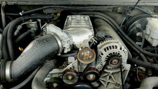

What other features identify this truck as a Calloway CS450?

Cool ride!
Thanks for the info. I like the Denali wheels but like you said the chrome may not last very long. Especially with the winter salt on the roads.
Other than the super charger the the LTX is pretty standard. Instead of the suburban badging it has callaway logos and CS450 in the interior. I am pretty amazed with the CS that I am getting 20MPG on the highway.
