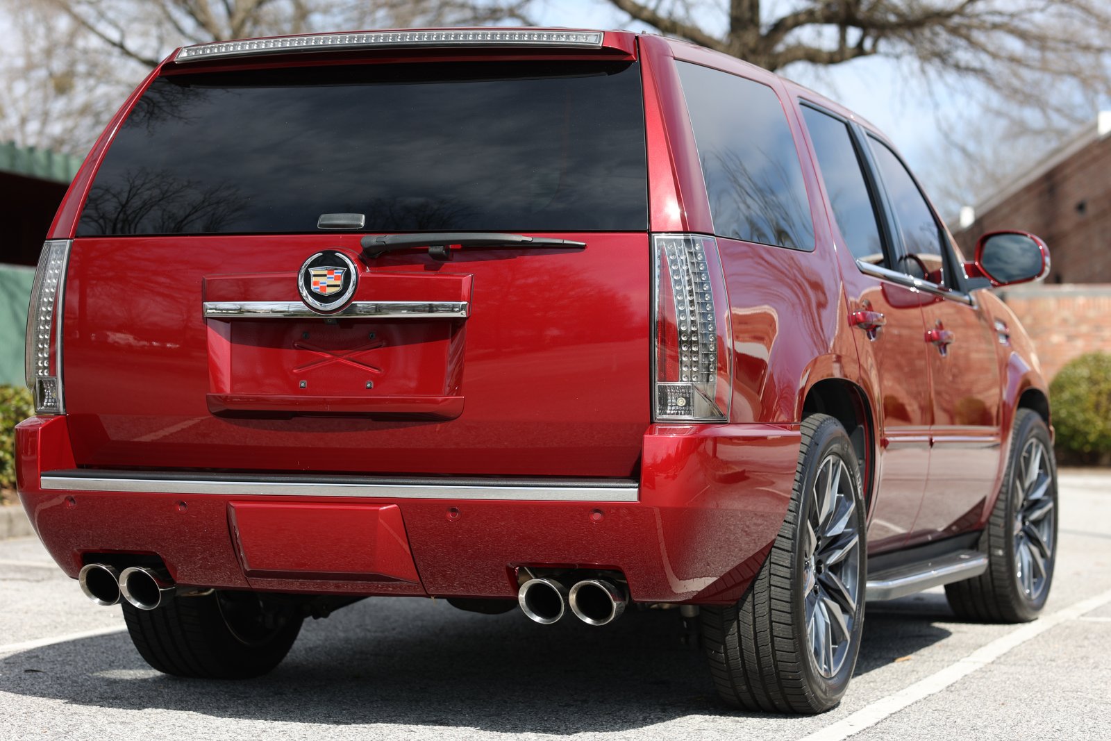

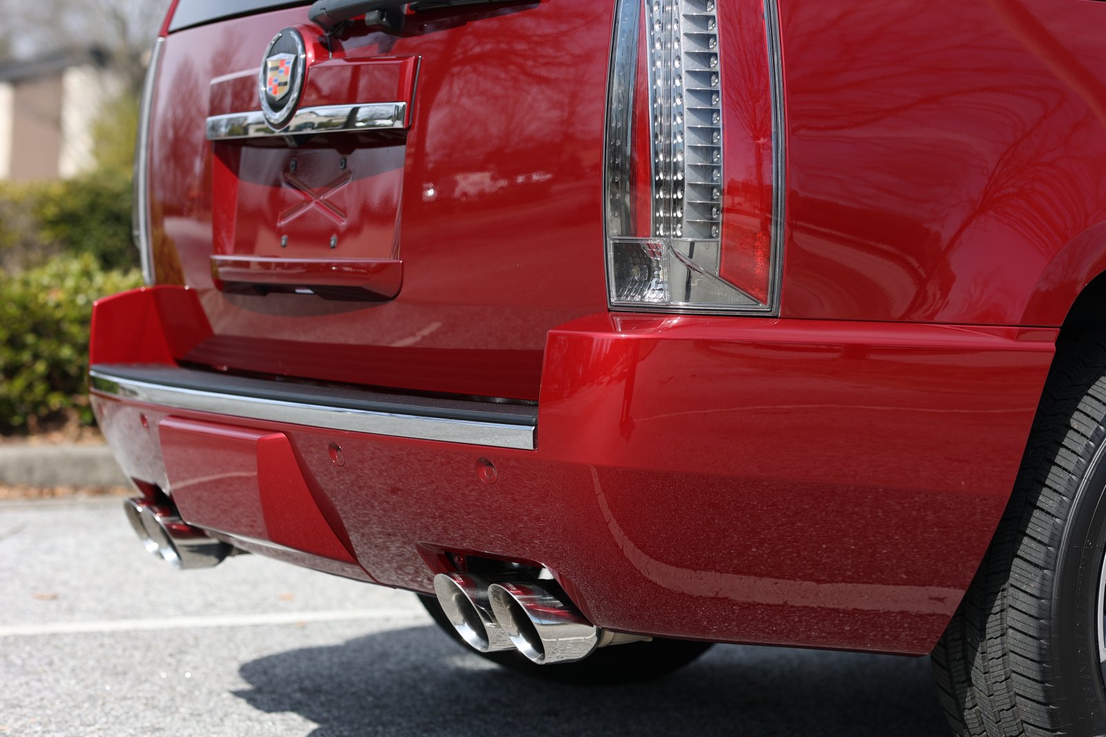

Done.

That turned out sooo nice. There are so few 11-14 Platinum and Premium Escalades that have the dual exhaust set up here in SoCal that I never knew it was a standard factory option, let alone an option not to have it too.
GM really lost out not offering the dual exhaust option on their other models. I’m pretty sure with the Explorer rollover scenarios occurring with Firestone, every manufacturer wanted a full size SUV mantra that said lots of hp to keep you safe when needed mindset.

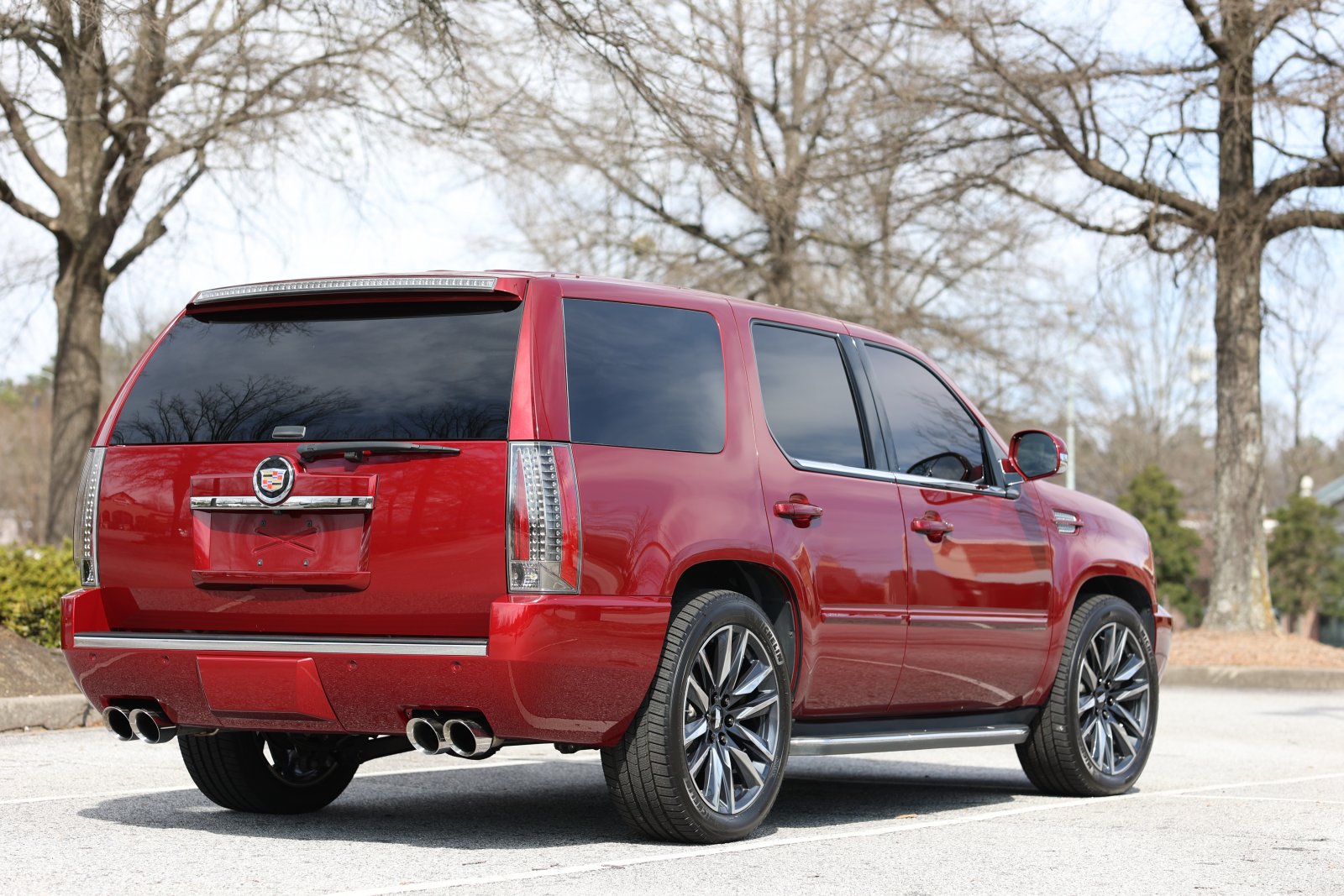

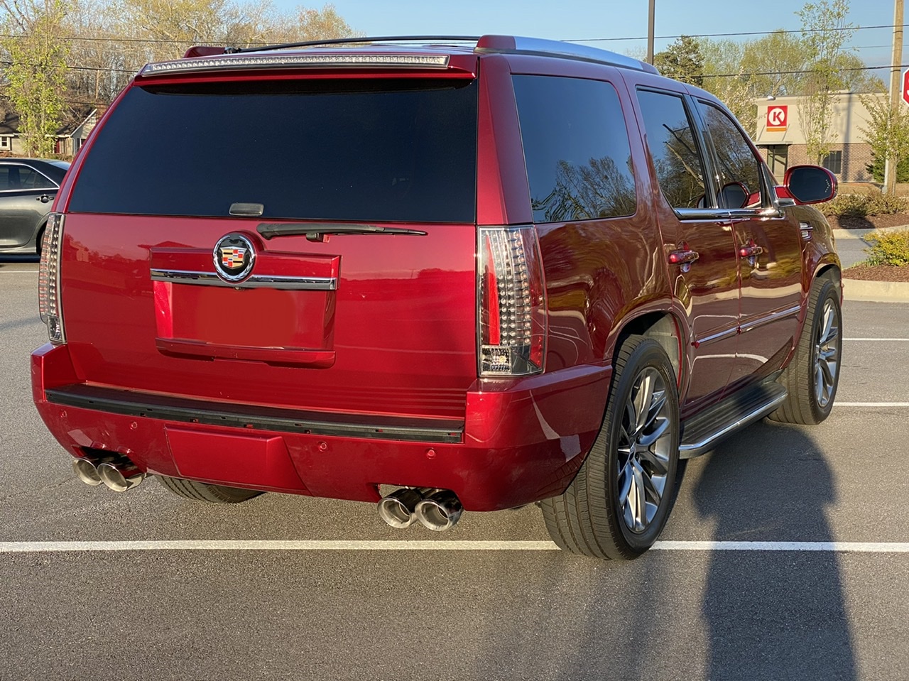

Yes, it turned out great. I’m very pleased with it. I’ll be doing the Platinum/Premium front fascia next.
