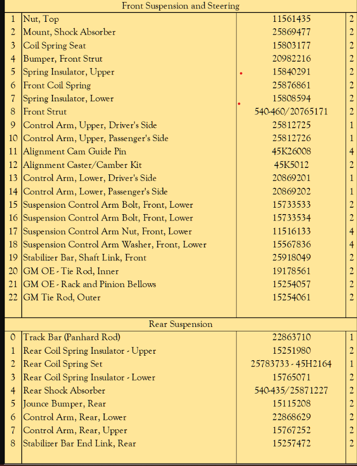

Good Morning - I'm in pursuit of rebuilding the front suspension (and likely rear) on the following:
2012 GMC Yukon Denali AWD
VIN:1GKS2EEF0CR167640
I've gotten several bids and from what I gather the shops either want to put all new MOOG assembled parts OR another has proposed to replace just the ball joints, struts, and stablizer links to keep me with my oem equipment that doesn't appear to have issues in their opinion.
The vehicle has 157,000 miles on it and I'm thinking I'll order the parts and have all OEM parts installed. It's been a headache figuring out exactly what I need with accurate parts numbers.
I got this from @swathdiver :
I'm doing my best to get all the cross references correct as his build wasn't for a Denali.
Is this effort going to make much of a difference or am I overworking myself and should consider an easier route?
Also, any guidance on parts I can feel confident will fit my unit would be much appreciated.
As always thanks for all the support/guidance you gurus provide!!

I did this job in my driveway on our 2007 Yukon XL Denali at around 190K. If you're having a shop do the work then the only advantage I see to replacing the control arms instead of just the ball joints is that you'll get new control arm bushings, which also do wear out. Also, I only replaced the outer tie rod ends instead of the inners as well, as mine were still quite snug. In all, I replaced:
-Upper and lower control arms with ball joints included
-Outer tie rod ends
-Sway bar links and bushings
-Brake pads and rotors
-Had a shop perform an alignment afterwards

Ok, this is what I've come up with. All parts were first checked over at ACDelco's website using your VIN and RPO Shock Codes, Then I triple checked with GMPartsGiant, GMPartsDirect and the supplied PDFs, again using your VIN only.
For the rear springs, the combination numbers listed are for ACDelco. GM OE is 25783732 and probably discontinued.
Where conflicts exist, I'm inclined to defer with ACDelco's website but you have to decide for yourself on that.
Are your upper controls cast iron or stamped steel? If stamped, then a different part number will be required.

@swathdiver - Apologies on the late reply. This vehicle was broken into over the weekend and....they got me good (possessions but no damage to the vehicle).
THANK YOU very much for putting this together. I did a similar search and came up with variables that were slightly inconclusive (discontinued parts and not much help from the parts guys at the local dealership). It appears that rock auto (assuming I entered 75% of the right part numbers is MUCH cheaper than the AC delco/GM parts giant/etc).
I'll be ordering soon and hoping I don't mess it up.
Also, I believe my uppers are forged? It's an AWD and a magnet will stick to them......

You're welcome and sorry to hear about the truck being broken into.
While I have purchased from GMPartsDirect and GMPartsGiant, their shipping costs usually price them out of the game but they are a great resource for looking up parts.
It is my own intention to defer to RockAuto over Amazon, the latter does not give out cool car magnets! Scrutinize your orders, RA has left out parts from larger orders before but they are good about making things right.

On the uppers are we going with forged? I believe the mechanic said "the magnet" was the way to tell?? Any input there?
They listed welded uppers and forged. If you don't see weld marks near the bushings, use the forged ones. I do not know if they are both compatible with the same or use different knuckles, otherwise I would prefer forged. Unless we're jumping berms or running through the Baja Peninsula at 60 mph, does it really even matter? LOL
