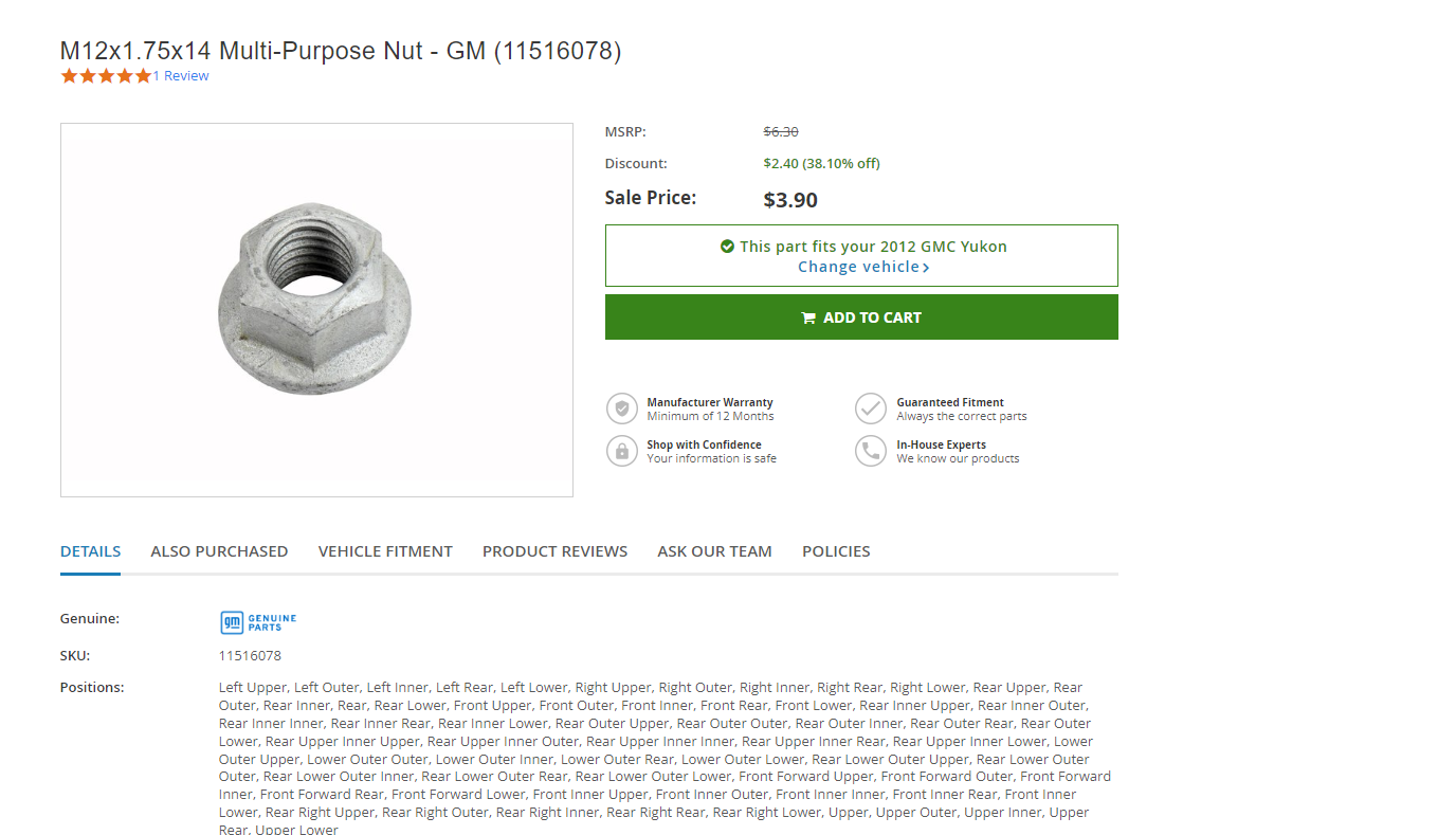

unless you live in the rust belt you don't need 1/2 of that stuff, nuts and bolts and several other parts can be re used.

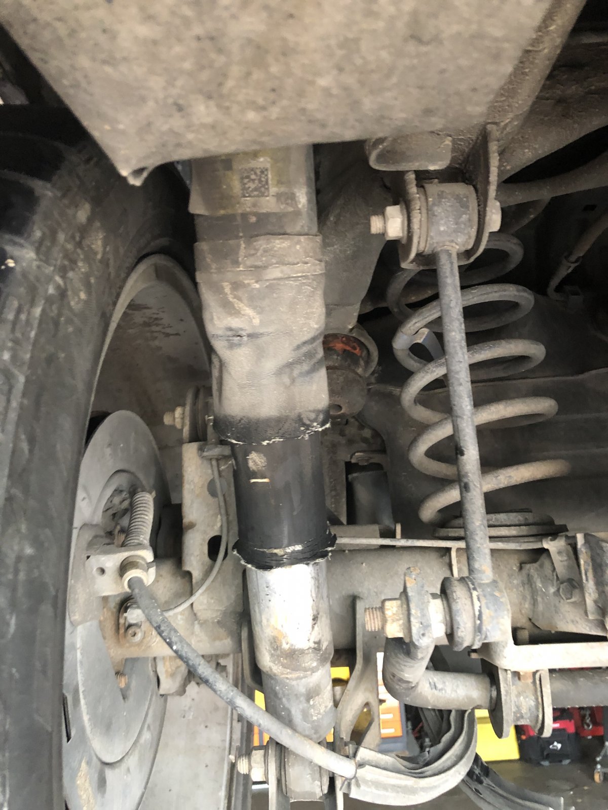

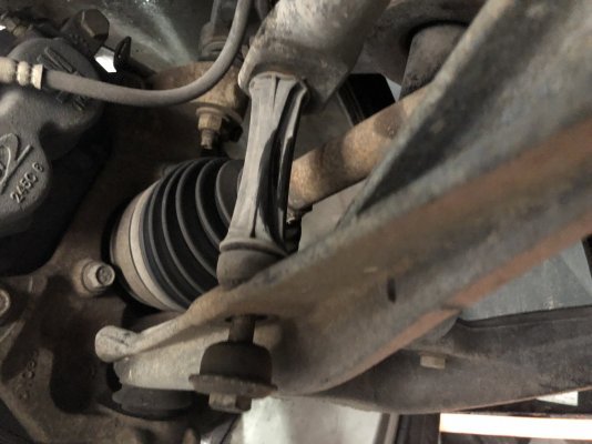

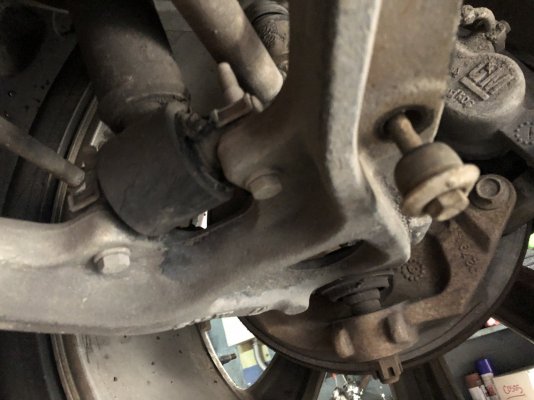

rear control arms probably do not need to be replaced unless you can see the bushings wiped out otherwise they are very stout, same with the panhard, even the springs are questionable to be replaced front or rear. I would stick with the guts of the system. shocks front/rear, air compressor (if operation is questionable), upper lower controls (front)
front struts can be rebuilt using all the original parts except the shock it's self, again inspect the old parts first if they are not cracked or show other signs of distress then they are fine. Steering parts do wear out so those can/should be replaced.

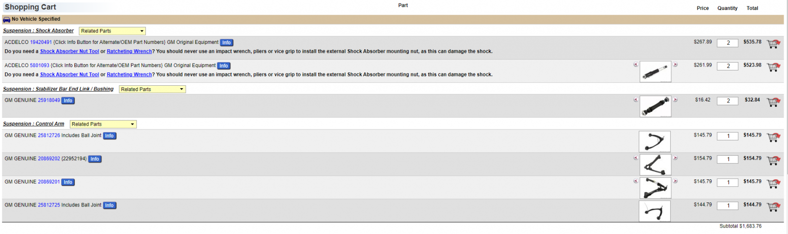

The trouble I would have is which Moog parts? Which "OE"? Moog has the better CK line and the economy, I'm going to sell it tomorrow, RK line and along the same lines, there is GM Original Equipment, ACDelco Professional/Gold (sometimes same as OE) and then there is ACDelco Silver. All different levels of quality and pricing and unless specified, which do you think a shop would use to maximize its profits?

I had a mechanic a few months back cuss me for asking which MOOG parts he was putting on.....Guess I'm a control freak and/or have trust issues because I don't believe them at all.
That said - I do think I found the right guy in Mechanic C (referenced above) that will let me supply the parts and has been verified as an honest person.
Just need to get the parts in!!!
