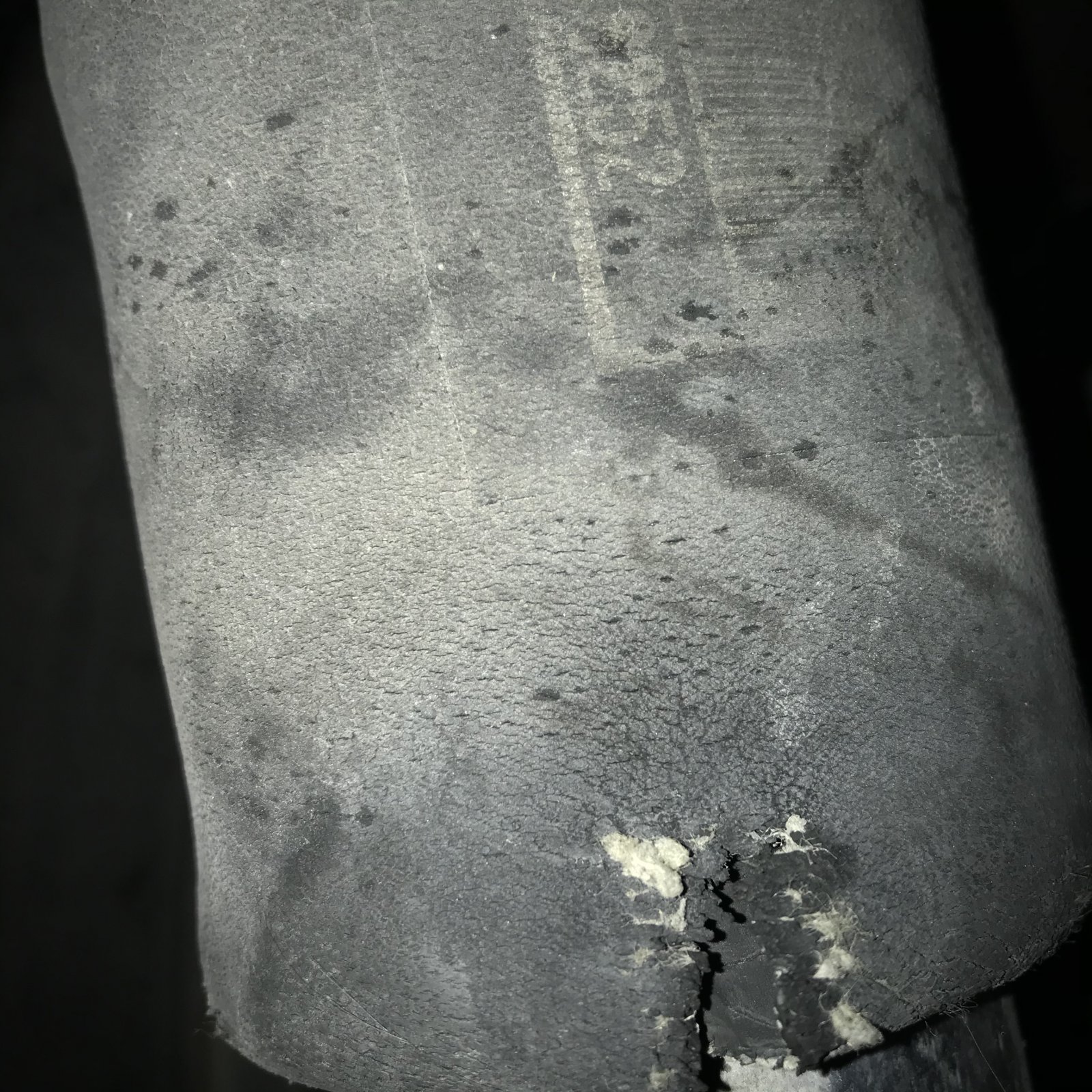

I got a 2012 Yukon Denali bought private sale. When I was looking it over I noticed the driver side rear air bag was blown. The compressor was running for about a few seconds after start up...I didn't count it... maybe more like 10 then 5. Someone not on this forum suggested pulling the fuse to the compressor while I drive it home or until I can get it fixed later this week to keep the compressor from running. Any thoughts on that? Is that gonna work and keep that compressor good if it is not trashed? Seller claimed he did not know it was blown so he did not know how long it had been like that.
You can pull the fuse if you want. If you’re getting new shocks soon, not sure I’d mess with doing that.

I think you suggested Arnott shocks....just do both now? I think the guy I bought it from said you could just put a new air bag on them....? But, I am thinking just do new shocks with the bag on them...right? It has 155xxx miles on them and he has not replaced them.

I would replace both rear shocks as I am sure they are both used up. I recommend the AS-2708's. They also retain the Auto Ride function.
