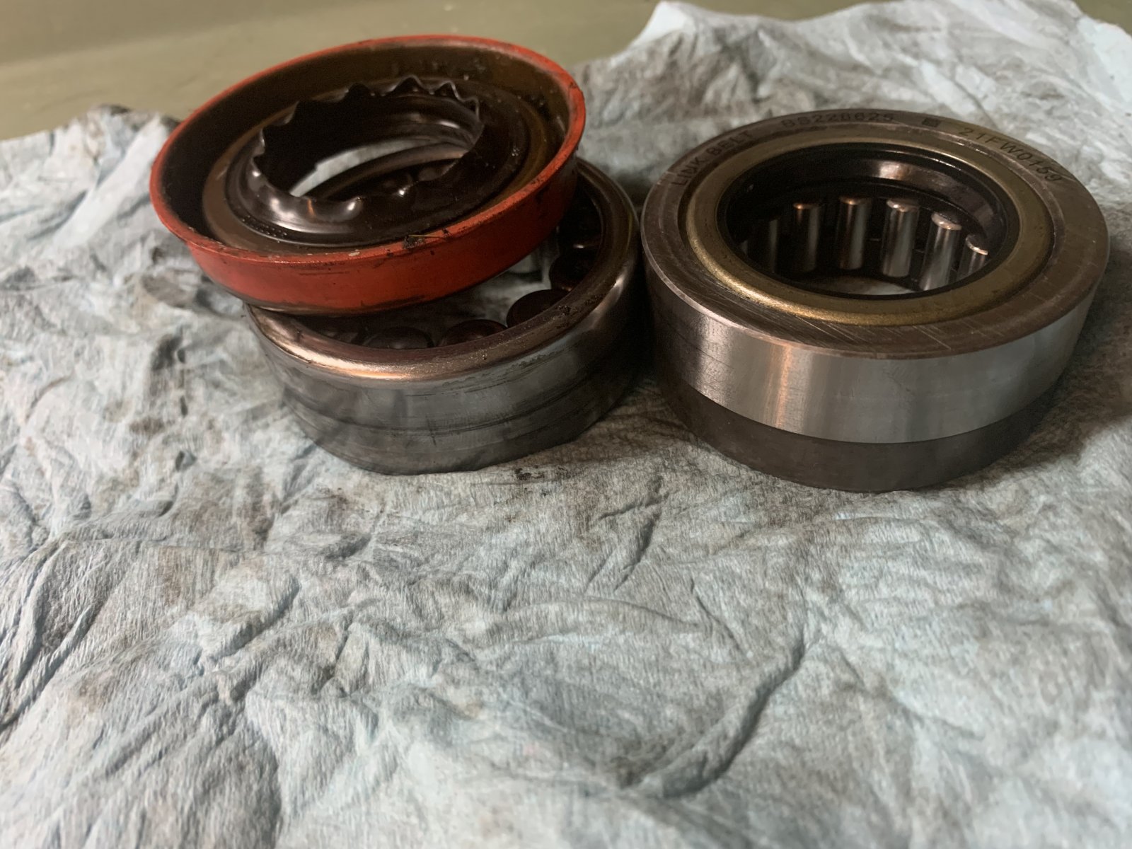

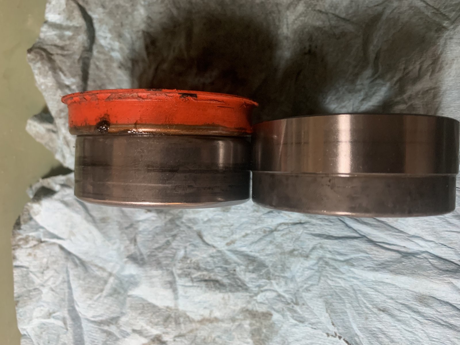

I ordered Timken for my 2011 Tahoe LT off of Sixity auto. Different bearing depth with small built in seal versus stock bearing with separate stock seal. Im
Sending these back and going back with the stock arrangement. 220K mile preventive maintenance. Replacing tone rings while im in there.

Factory bearings are Timken or Koyo. What you are seeing is a repair bearing and seal unit used when the wear surface of the axle shaft is damaged. They move the bearing to a new position.

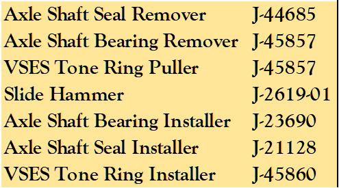

The J-45857 and slide hammer is the best way to get these parts out without damaging the other. I also bought the Performance Tool W89326 and coupled with a commercial slide hammer set pulled the bearings but ruined the tone rings. It barely fit but it did the job.
The inside diameter of the axle tube is graduated so that you cannot put the tone rings in too deep. I used the J-45860 but you could get by with a large socket. Same with the J-23690. The seals could be installed with a 2x4 or very light taps of a hammer. I've done it both ways over the years.

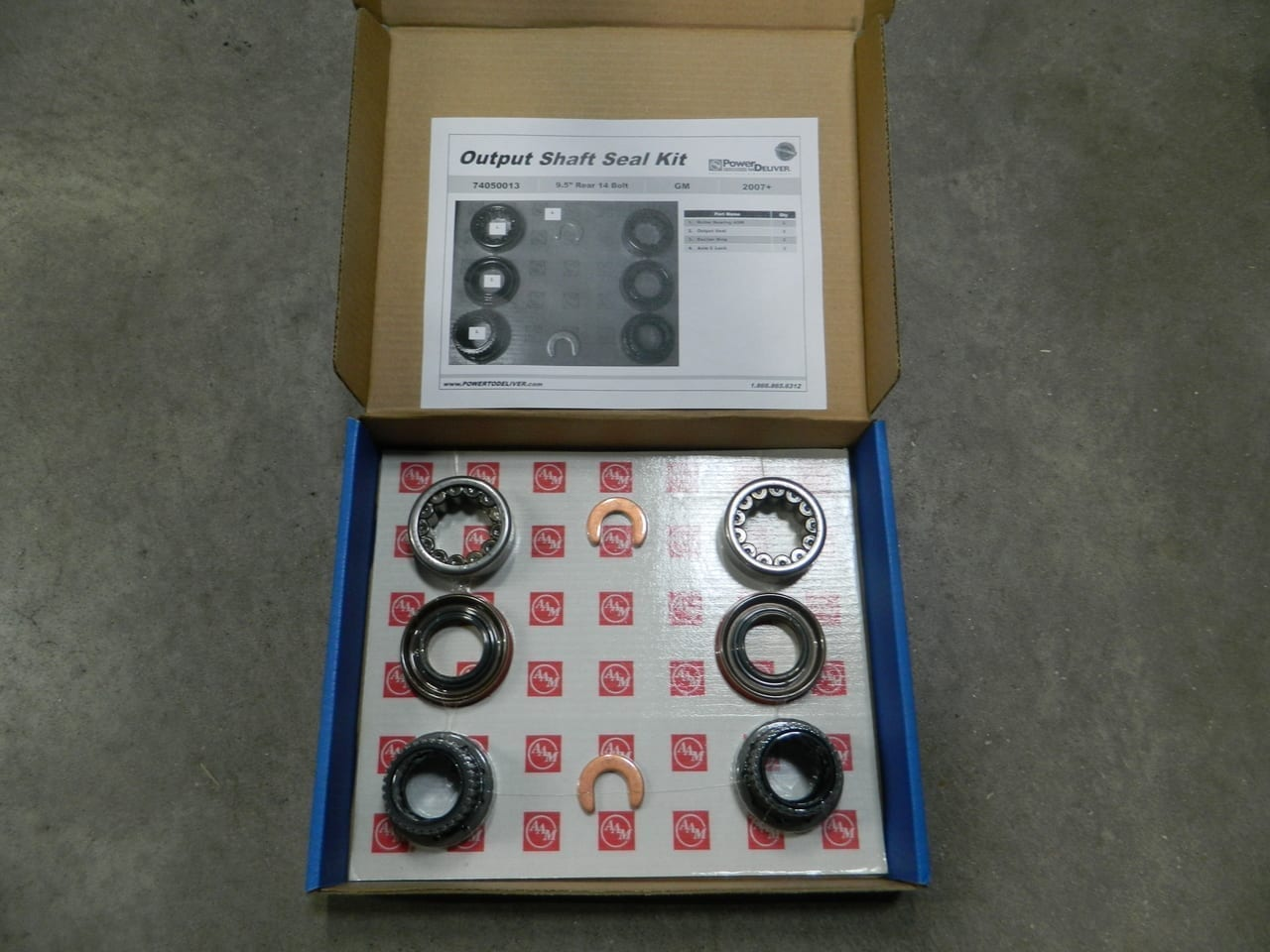

My 2014 all wheel drive Escalade has the 9.5 inch 14 bolt rear differential. The 8.5 in uses different bearings and seals. You might want to get under there and take a look at what you have so you get the right parts. Koyo bearings were OEM on the 9.5 in.... And come in the kit from AAM. (They build the axle assembly for GM)
At 168,000 mi, I had some excessive end play in the axles. The cause turned out to be the c-clips that retain the axles. Those come in the AAM kit by the way, along with the koyo bearings.
To pull the bearing without damaging the tone ring, I picked up a set of blind hole bearing pullers. One was slightly too large, turned it down on the lathe to just the right size. 5 lb slide hammer pulled it out easy enough.

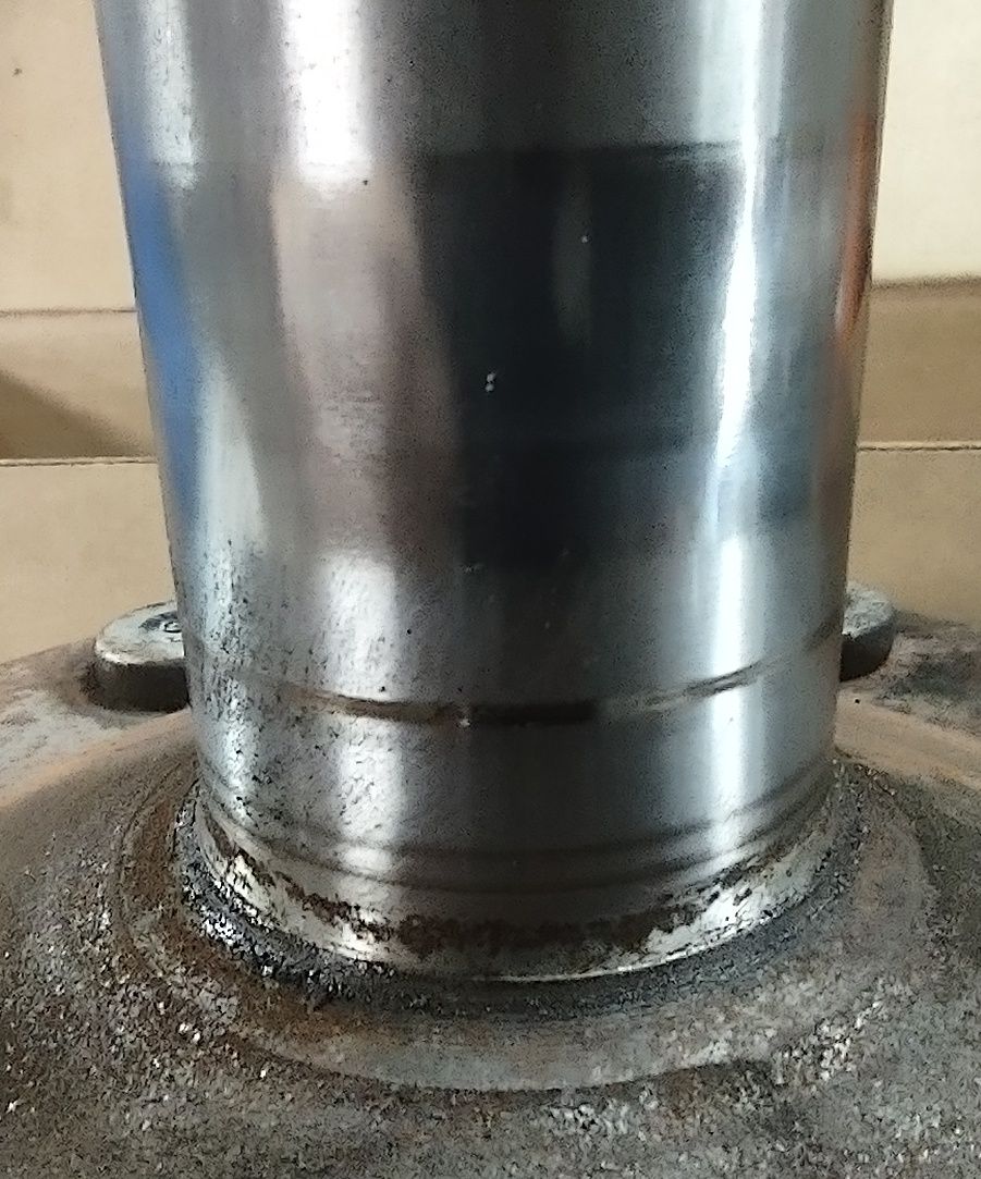

The where on the seat clips was quite visible. Here's a new one from the kit next to the old one
The groove from the seal can be cleaned up. However at a set of new axles from Spicer, so went ahead and installed them
I tend to go a little Overkill, taking care of things while I'm in there.... But it's all done and ready for another 168,000 miles. Next time maybe I'll just replace those c clips and save some money :)

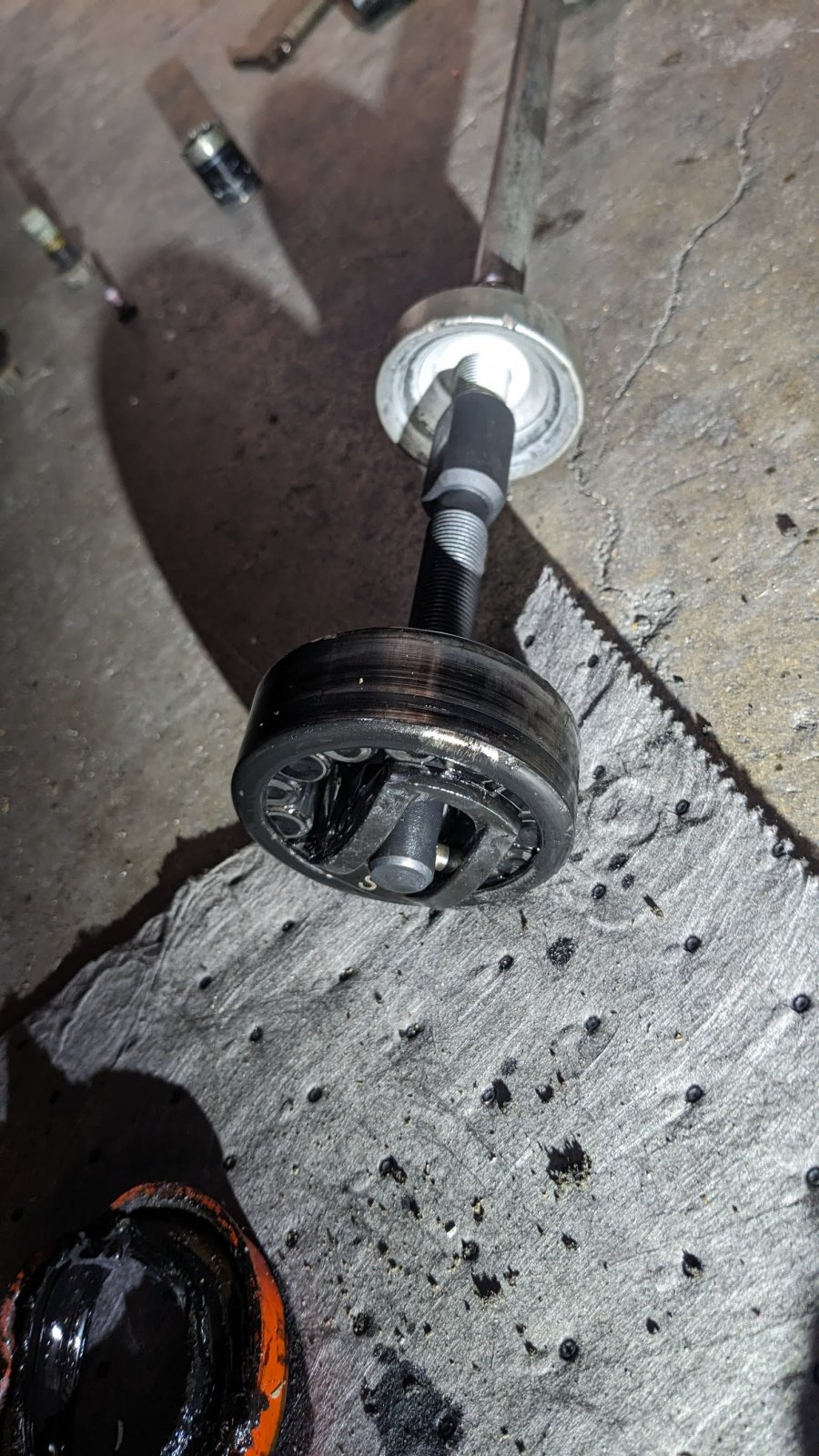

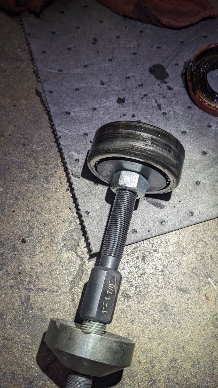

is the one I used. got the part number from another gm board buried in a axle bearing thread. you'll need a slid hammer for this to screw into.

That's the one I used that barely fit and wrecked the tone ring. Maybe it was me.

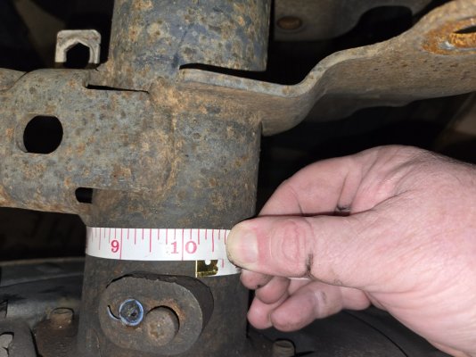

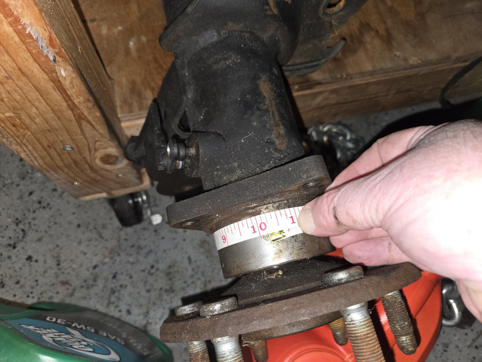

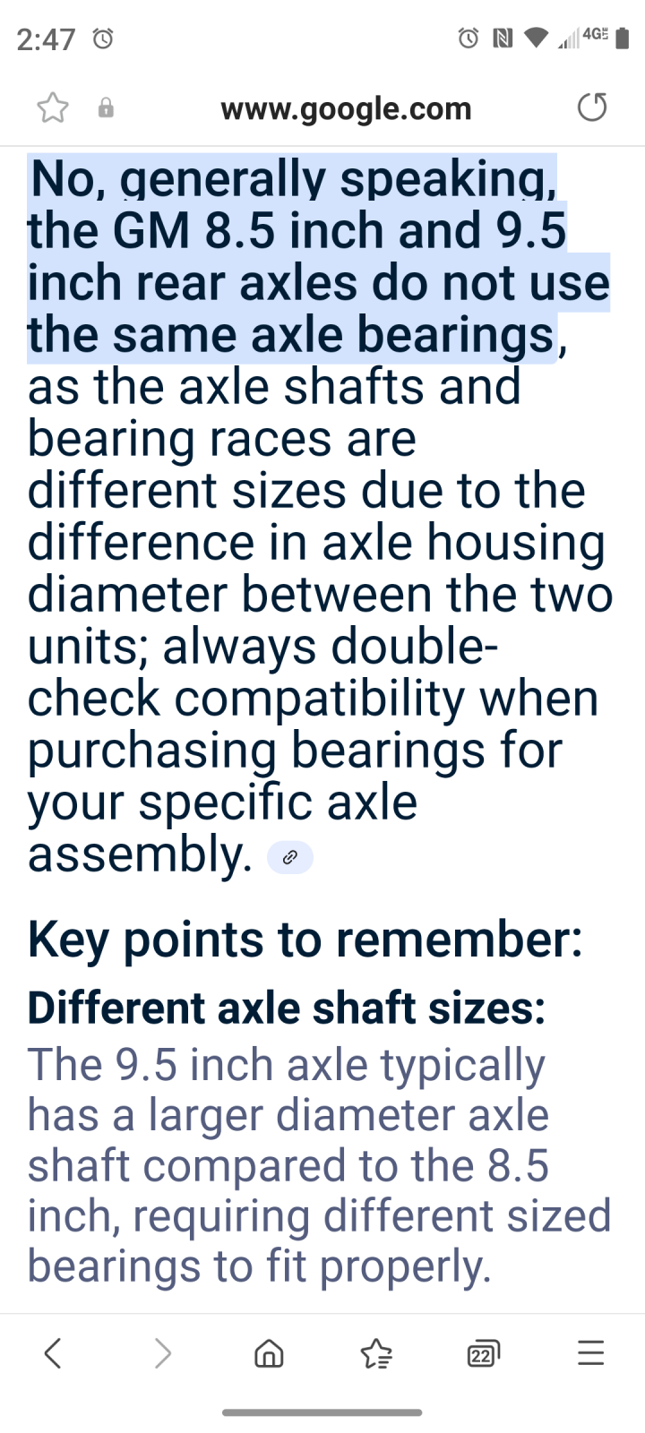

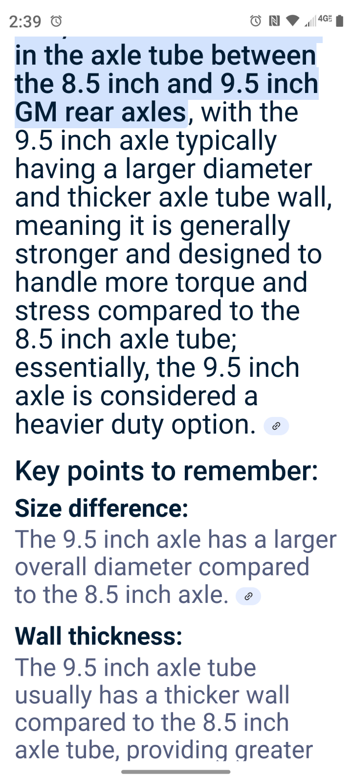

Oh boy, where are you getting this information? Google?
Ok, this ought to settle it. The axle under the work bench is my spare 9.5" out of a 2011 Escalade. The axle on my driveway is the 8.6" from my Yukon XL.
These are Saginaw axles used on the GMT900 wagons and pickups. My pickups have the same 9.5" axles, just different brackets of course as they have a leaf spring rear suspension.

huh. slid right behind the bearing for mine. I used it twice, once for the oem bearings and once to pull failed timkins back out. no tone ring issue.
I did you the one on the small size that only grabs the rollers, not the outer race.
maybe I just got lucky my tone ring is installed slightly further back?
21,299
30,254
The tone rings only go so far back, the tube is stepped to stop them. Maybe the tone rings were just coming apart when we put the tool in there. The factory one fit better and was slimmer but the slide hammer threads didn't match. Either way, you've shown us that it does work and it's certainly less expensive than the factory tools!
