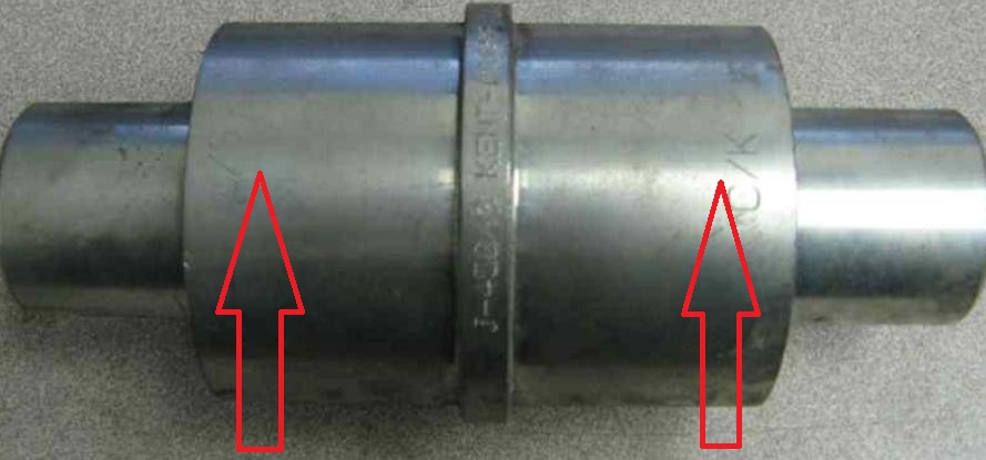

J-45857 is also designed to remove the VSES tone ring. The VSES installation tool is J-45860 and they are hard to come by at present. Paid a pretty penny for one recently.
They are definitely pricey...lol.
How does this tool install the tone ring? Does the ring rest against the raised lip of the tool? If so, what sets the depth? Tool flush with axle tube or does the lip stop at where the bearing seats?
If I know the seating depth, I may be able to use a socket.

The tool you mentioned, the J45857 has than thin lip on the end and likely just barely fits between the two to not damage the ring like you stated. Does that Kent Moore tool attach to a slide hammer or more of a 3-jaw hub puller that anchors to the axle tube?
I didn't catch that, cool! The Kent Moor tool attaches to a slide hammer.
It drives the tone ring in to a certain depth. There is a lip in the center of the tool that stops it at the axle tube. It appears that it was made for another application as well, so I would only be using one side to seat it to the proper depth.
If you want, send me a PM so that I'm reminded to get my phone and measure it for you. Will try to take a picture and upload it.

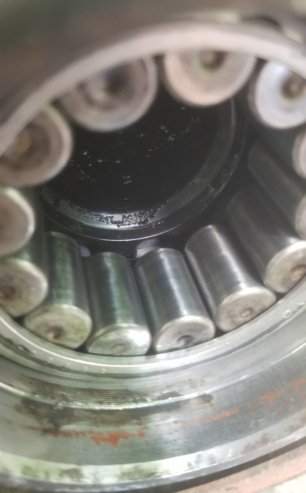

I went with Yukon axles and OE bearings. The tool I used to pull the bearings and tone ring was the OTC 6542. This will tighten against the rollers and has enough depth to grab the tone ring using a standard 5/8-18 threaded slide hammer.

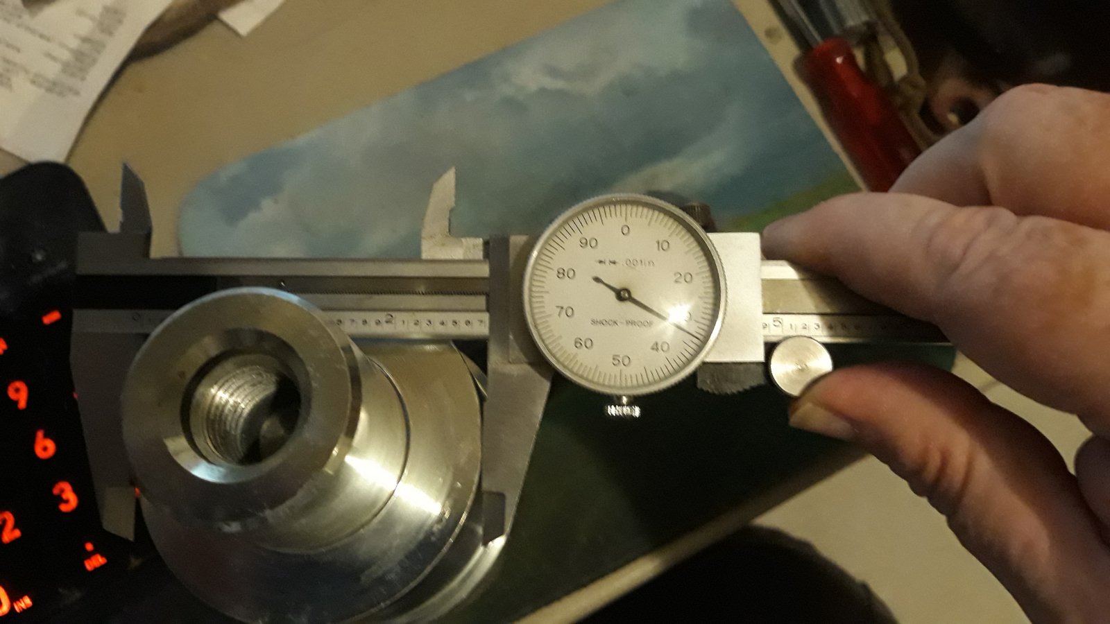

Thankyou @swathdiver for the seating depth. Do you by chance have a caliper to measure the OD of the tool that drives the tone ring?
This is the OD I need.
I managed to damage a new one and it looks like I need to contact the rolled edge only of the tone ring. This where I believe the tool contacts the tone ring.
Using a telescoping gauge the best I can to measure the diameter of the tone ring race in the axle tube, I came up with about 2.750-2.752" for a max usable diameter...or about 69.90 MM....70MM looks to be a bit tight.
My install tool I used was 65MM dia and it caved in the outside of the tone ring outer race, even with trying to contact the outer rolled lip.

I come up with 2.733 on both sides.
Thank you!
I took my HF 72MM seal installer down to a local machine shop, and for some beer $$, he turned it down to 2.735". I added a couple thou for tolerance and I didn't want to go smaller than the OE tool.
I did a test run on the old tone ring and it went in with no issues.
The Kent-Moore tool will also square the face of the tone ring with the axle tube when it seats which is a big plus, using this modified tool I had made, you should double check with the depth gauge end of a caliper...which again thanks to @swathdiver is roughly 45MM deep. I have the painter's tape set at 43MM by eyeballing the end of the axle tube, gives me room for final adjustment. I think you have a couple MM of wiggle room but not much less than 45MM.
ahh so you can replace bearings without touching the tone ring? that's good.

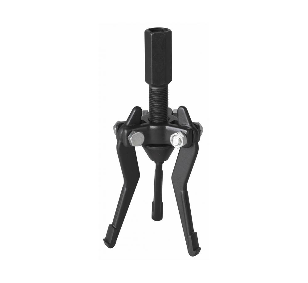

You will need a blind hole puller like the one pictured, to grab the rollers of the bearing. There's not enough room between the tone ring and the bearing for one of those flip-out style attachments like this, least I couldn't get it to work. You have about 6MM of gap between the two.
I was able to almost finish yesterday, just need to add fluid and test drive.
Here's the proximity of the tone ring to the bearing...it's close, maybe 5MM
Pulling the bearing by the rollers worked just fine, that outer race is tough enough.

ahh. so it's a physical thing. the 3 jaw puller back a few posts would pull it it without messing up the tone ring?
