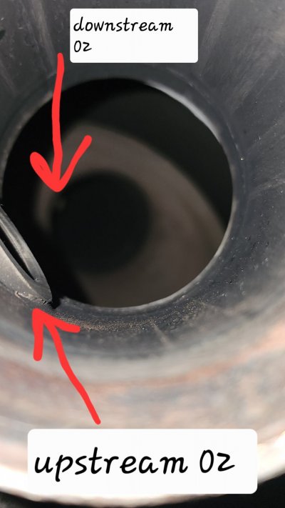

recently bought this vehicle and come to find out all 3 catalytic converters are hollowed out I had changed all 4 oxygen sensors because I had permanent code p0430 and p0420 codes SUV runs fine and all I can even pass smog inspection no check engine light I can remote start it I'm just wondering how the hell can it pass smog and why no check engine light ?

was taken care of except the fact there was vacuum and exhaust leaks "exhaust manifold gaskets, intake manifold gaskets, exhaust pipe to cat gaskets" so I'm pretty sure instead of paying for all that work he had someone hallow the cats out maybe because they where damaged ? I fixed all leaky gaskets myself and that's how I noticed them hallowed
