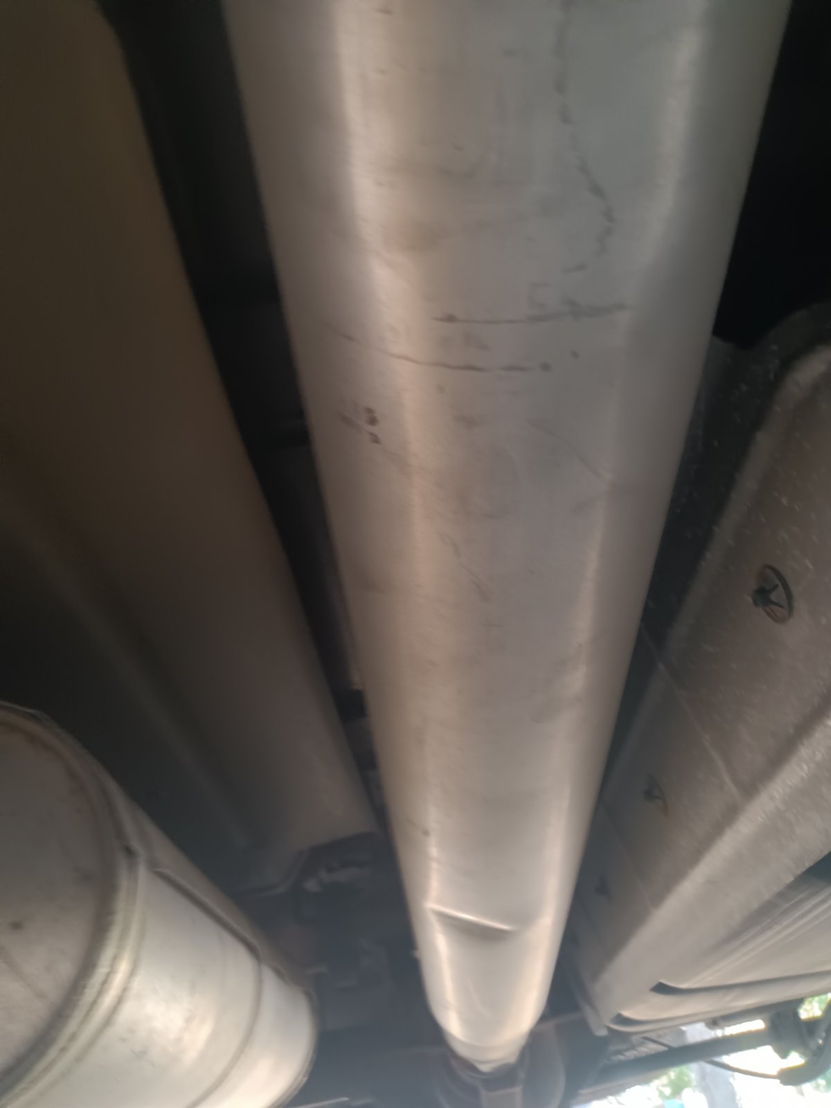

UPDATE: Jacked up the front - front right tire moves side to side and the front left moves side to side and a lil up and down.
I know the tie rod ends are bad, can see them split and can roll them. Seems like the wheel bearings are probably shot too.
The plan is to take it to a more thorough and old-school mechanic and have him take a look before I go down the rabbit hole.
At this point, I'm already doing the front rotors/calipers/pads/hoses, might as well do the hubs/inners/outers - the U&LCA ball joints I'm sure should be replaced as well but I think I'll wait and see if there is any improvement first with the items mentioned above.
I was somewhat skeptical of all this drive shaft talk - but then I saw this (in the pic attached) - a big ass dent/crease in the drive shaft. Looks like it was hit by something. Got me wondering if this could have anything to do with it.
How would one determine if the drive shaft is bad or out of alignment?

@rmaker When you take it to a shop they should be able to figure out safely if the driveshaft is out of balance
Foggy
Jul 25, 2019
1,423
1,951
KS
You will have to find a driveshaft shop specifically .. They can build/rebuild driveshafts
And are able to balance them..
The dent prob doesn't affect the balance much. And your post
stated your vibrations are Up Front... I'd get the known worn out stuff addressed first.

is that your drive shaft? if so just replace it. it's bent
if you Google a drive shaft shop near you, they should have a balancer. but I can tell you a dented shift, just replace it with one of gm. most shaft shops can build you one but I believe oem is better

UPDATE - So I took it to the old school mechanic to give a proper once over. He determined that the left wheel bearing and the right inner tie rod are in fact bad. He also says that the drive shaft is bent and should be replaced.
He quoted me on just the one-wheel bearing, tie rod, and drive shaft. I told him to go ahead and replace it all, both inner/outer tie rods and both hub assemblies. He won't let me provide the parts which kinda sucks but at this point, I don't really care. Just want to get it on the road safely.
He did say I could provide the drive shaft which he quoted me at $675, so if anyone has any info on a new drive shaft i.e.. part #, good replacements etc let me know.

Then he said, oh it's discontinued so I can give it to you. I asked how am I supposed to determine the correct part, and he was like good luck.. WTH?
I would never buy a driveshaft from a dealer. I've been having driveshafts built locally for 50 yrs without issue.

A bent driveshaft will give a full-on vehicle vibration at highway speeds and tend to come in waves, like a slow sine wave...usually makes the rear view mirror vibrate as well.
