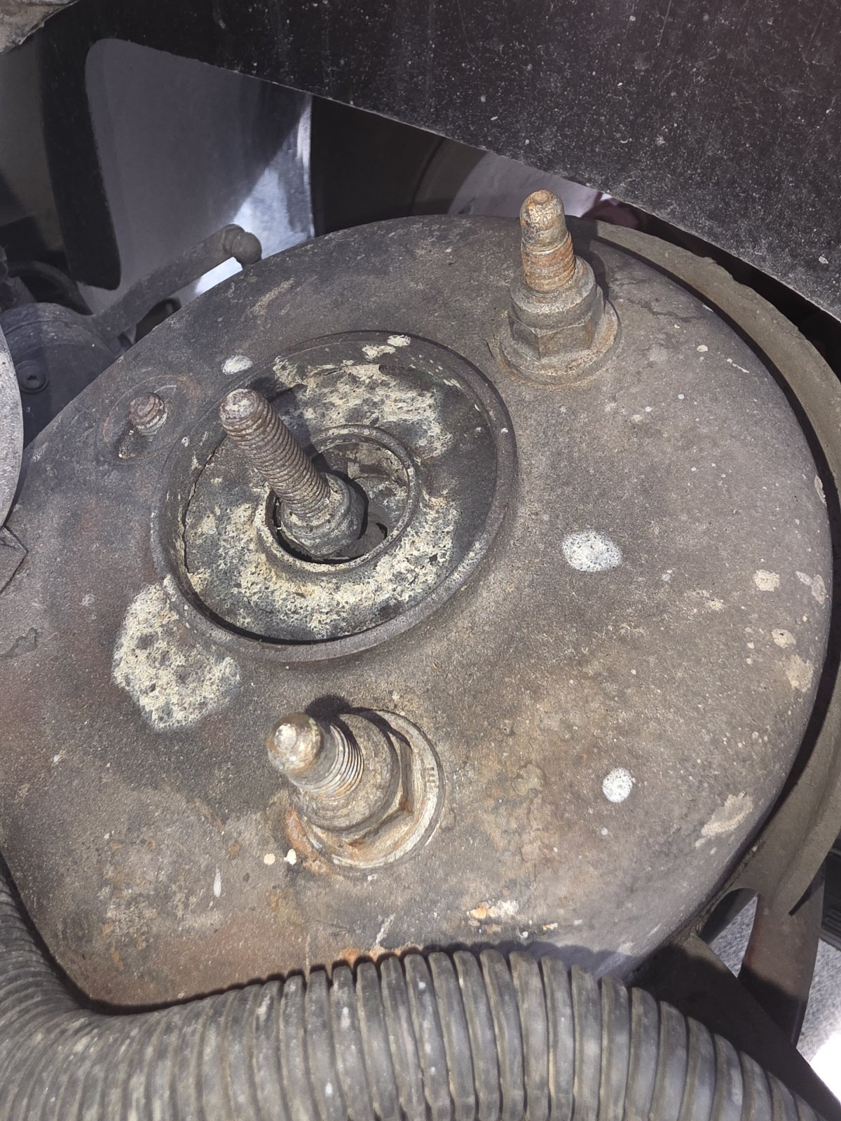

guy from norcal
Jul 15, 2012
703
541
Check the top of your struts. Make sure it doesn't look like this
