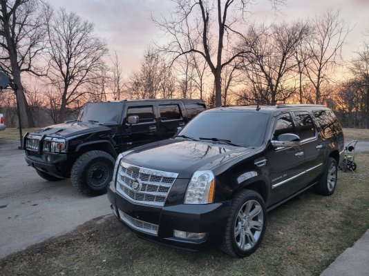

Hi, new to the forum and have been reading quite a bit. A lot of knowledgeable people and great info so thanks guys! I have a 2011 Escalade 6.2 L94 that im doing a dod/vvt delete with btr truck norris cam because one of my lifters started chirping.
A few questions that still remain unsolved for me is mostly about the oil pump and plugging the oil valley. I've read mixed info about using the oem high volume/flow pump, for some people its too much oil pressure, too low for some. So i have no idea what to use. any insight will be greatly appreciated. My truck has 220k miles on it, unsure if original motor but likely it is.
Is using the gm non afm valley tray is sufficient or should i use the valley block off plugs in unison.
Here's the parts list from ams racing
-BTR (Brian Tooley Racing) Truck Norris camshaft (Specs: 212/22X .552"/.552" 107)
-BTR Beehive Spring Kit
-BTR hardened 7.400" length pushrods set
-Delphi LS7 Lifters with plastic trays
-MLS head gaskets set
-Complete head bolts set
-GM Crankshaft bolt
-GM 3 bolt camshaft gear
-GM LS2 front timing cover with sensor, bolts, and gaskets/seal
-GM non-afm valley plate
