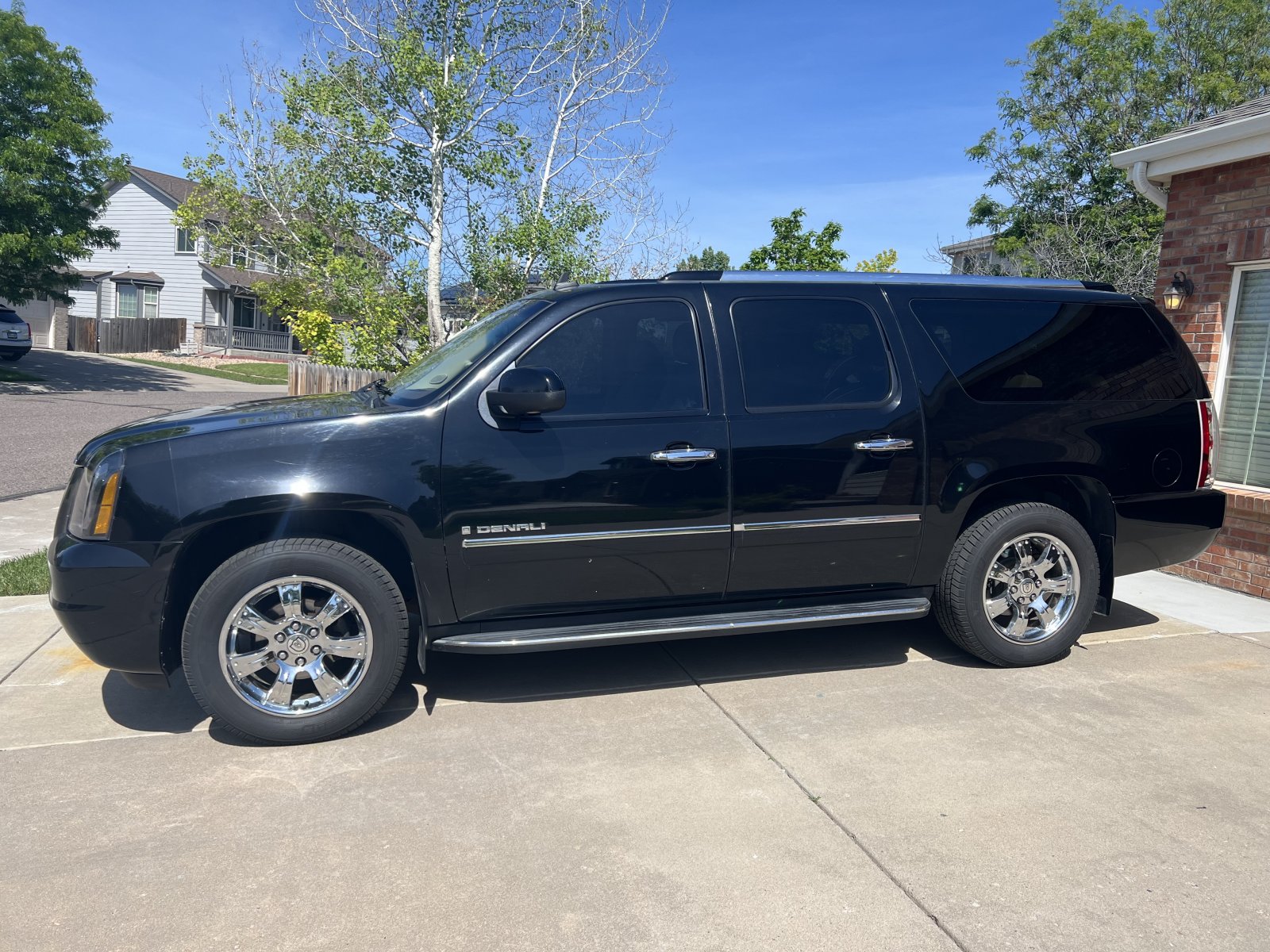

I could probably drive it there and it would make it. I’m just really bummed I’m in this situation so quickly after buying this thing. The past few weeks have been super tough.
Yeah, it sure is a bummer. But once done and gone over, you won't have to think about it for a long time.
Our corporate knowledge teaches us that when the 6.2s get overheated, they tend to drop a valve guide. The earlier 2007-2008 6.2s had a habit of breaking a valve spring on #7 or #8 at around 165K miles more often than the later years. If the engines were fed a steady diet of 87 instead of 93, by about 100K miles they were breaking pistons and piston rings.
That said, they are great motors, have two of them in my pickups and going to someday put one in my Yukon XL.

I'd say change the oil and put in 15w-40 to drive down, and keep the rpms low and engine load low. Denver to CO springs isn't too bad of a drive if I remember correctly. It may make it.
Or put 20w-50 in it and trade it.........I'm not really serious, but it could be an option. I had an acquaintance 20 years ago that put 80w-90 in an old camaro to mask the rod knock when he got rid of it. I could never do that to a person........maybe a shady dealership though.
I did trade in a 2009 Denali because all of a sudden it started drinking oil on a road trip. It was a beautiful black XL. But, I was tired of the piston slap that never went away and dropped it like a bad habit for a pristine 2017 Denali. I don't feal bad because the salesman said it would go to auction because it had 165k. Somebody got a nice truck for pennies I'm sure and put a motor in it.
I have a beautiful black XL! Only issues on the inside is one of my doors sometimes doesn’t unlock and chrome coming off door handles. I think it is totally worth saving. My family really like riding in it and it would be a shame to let it go.
I think that my truck is having an oil consumption issue and the rod knock is because it’s gotten too low on oil before. If i tried to sell this thing to CarMax I’d be lucky to get $3k - $4k. I want to see if it’s possible to get either a rebuild or new engine put in.
Interesting idea with your friend doing that trick with his Camaro lol
