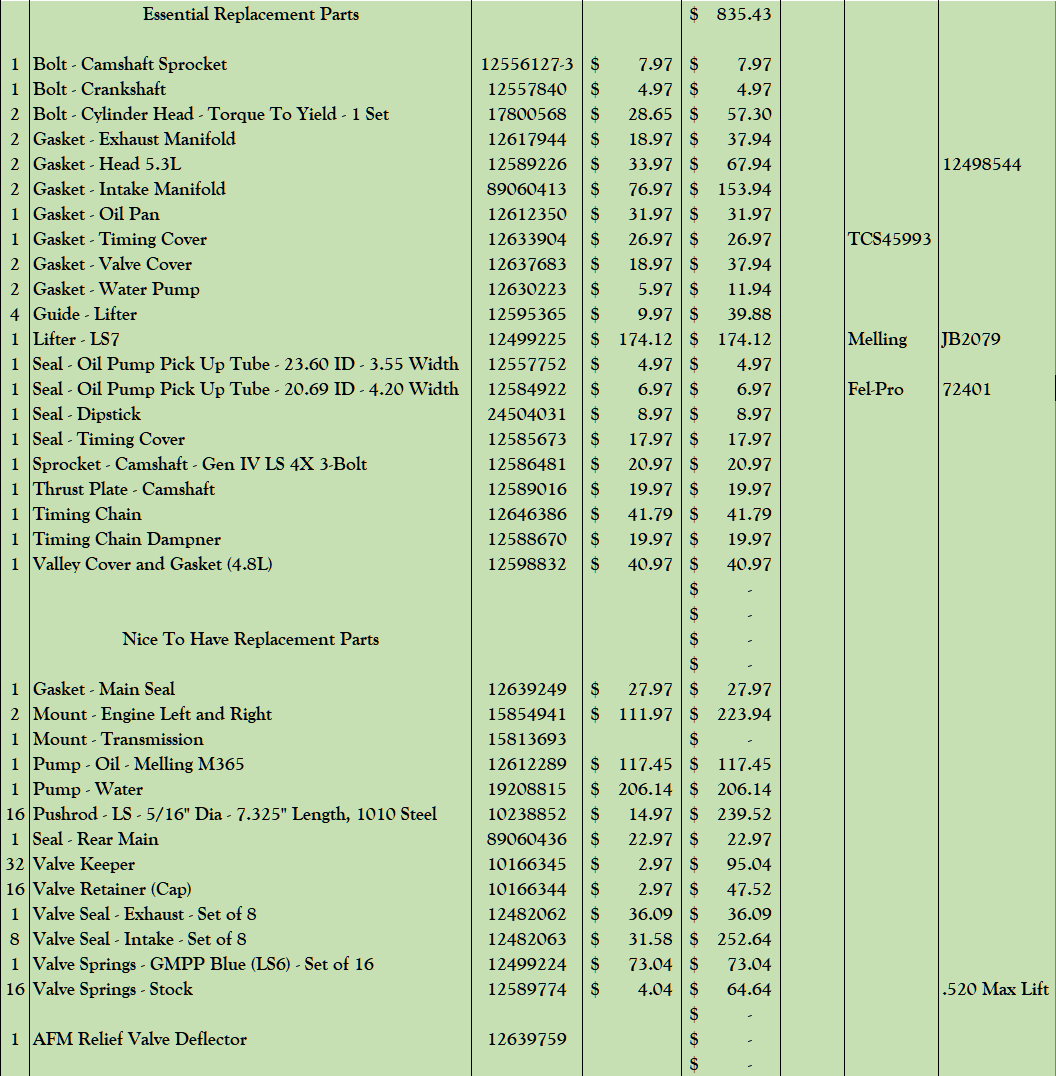

I made this list in 2017 while contemplating deleting AFM in mine, might have to update some part numbers:
No camshaft in this list, the ones I like are too small for most folks. Chris' Tahoe seems to like the one he selected for his. @iamdub
