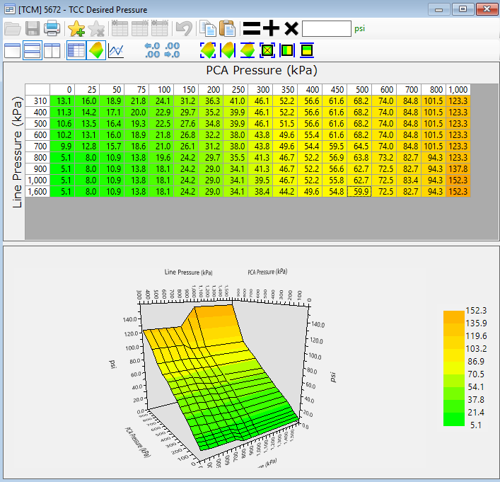

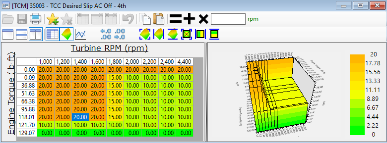

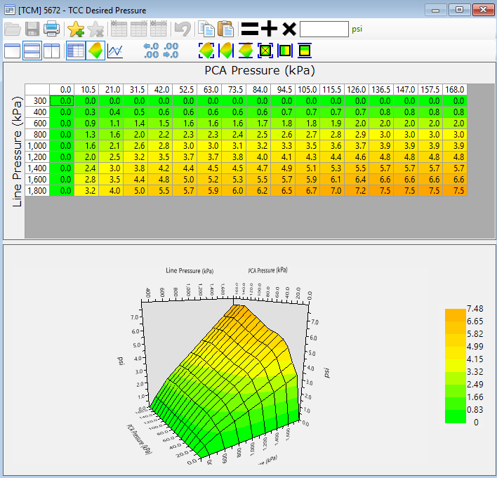

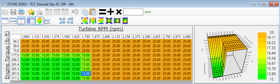

Another thought on 07-14 6l80 vs 15+ 6l80s, the TCC desired slip is different (and pca/line pressure and apply ramp)
So I wonder if one tune is more prone to wearing out the regulator valve or tcc....
'13 tcc desired slip in 4th
'17 tcc desired slip in 4th (More aggressive than '15-16 and '18-'20 which zero at 165lbft)
PCA vs line pressure graphs different and not interchangeable it would seem...
'13
'17
'13
'17

I have used the '17 and '18 TCC desired slip tables. No driveability issues either way.
Since the later ones go to 0 slip, I'm guessing later tunes may be modulating the pressure regulator a tiny bit more.
Whereas the earlier tunes will allow more TCC slippage when first you get on the throttle.
For whatever reason GM was more aggressive with TCC slip in '17 only, but then backed off again for '18-'20...
