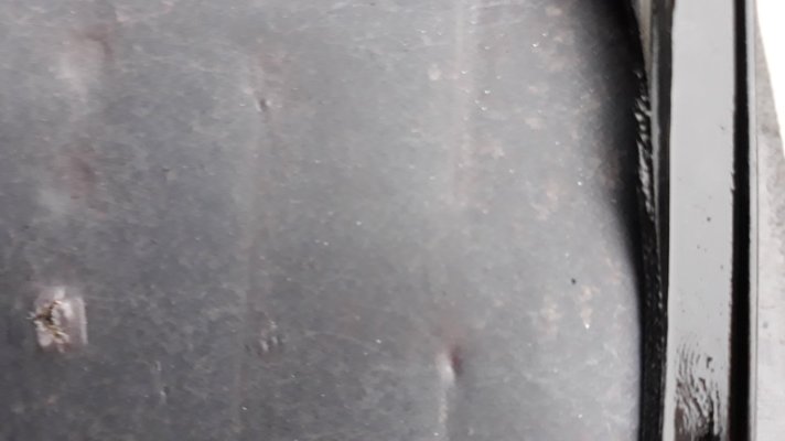

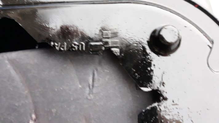

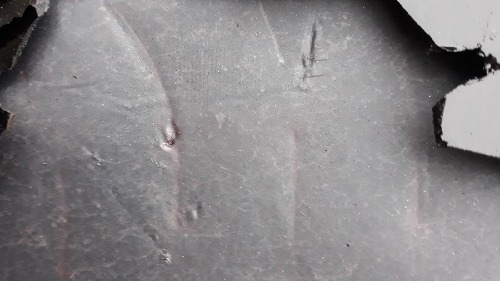

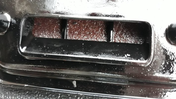

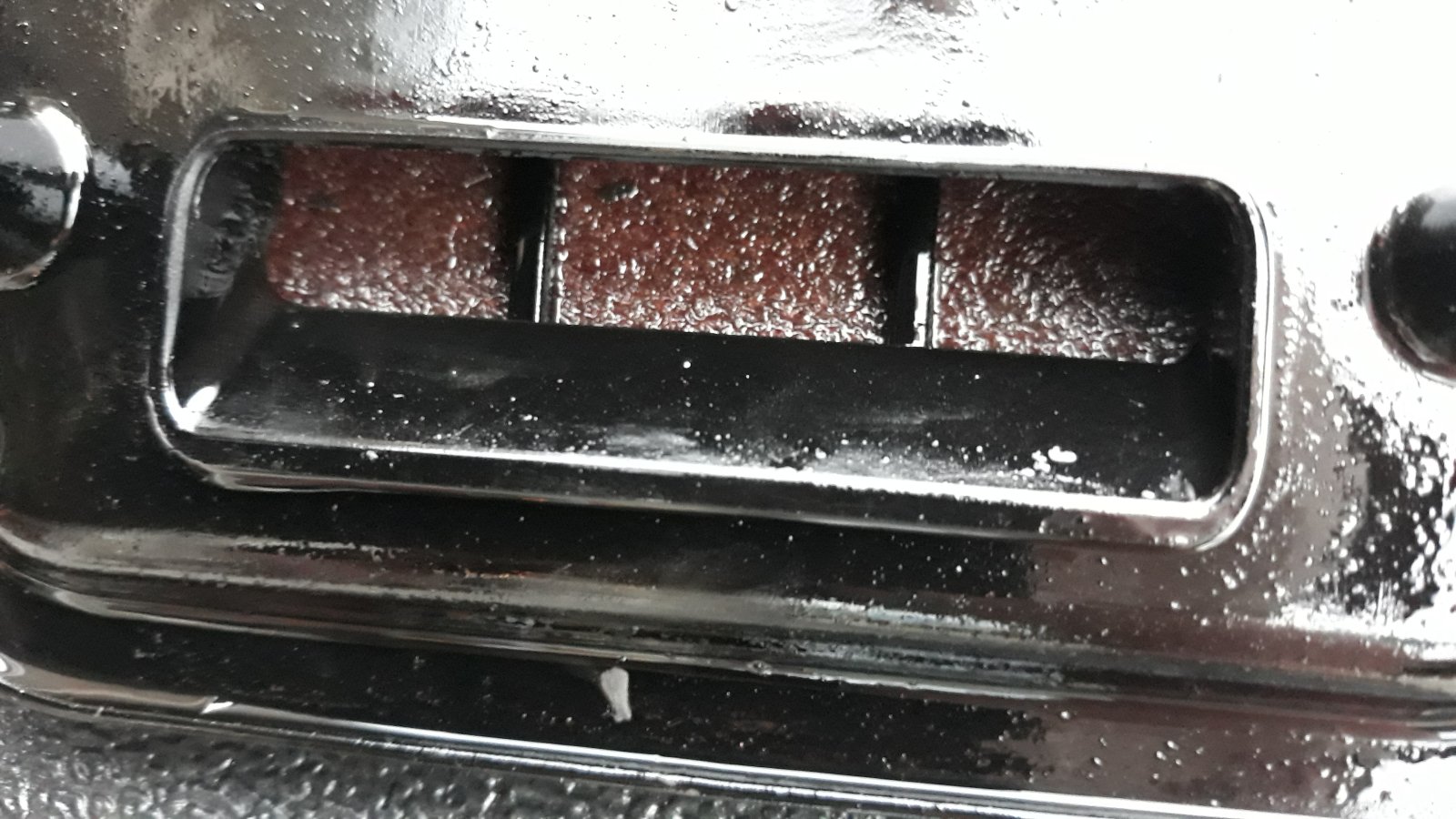

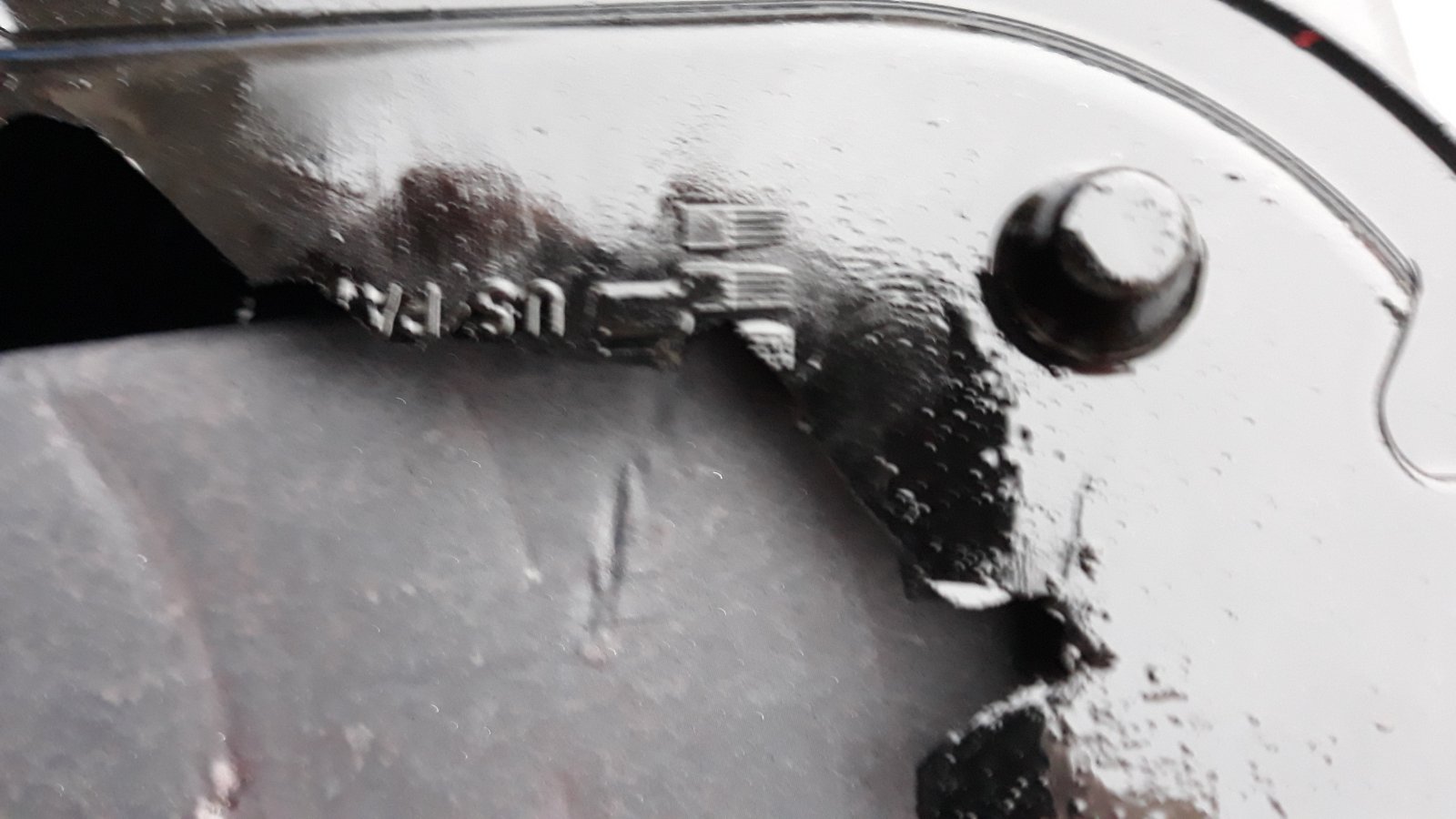

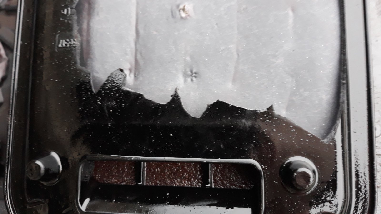

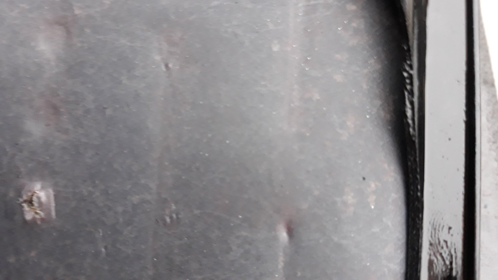

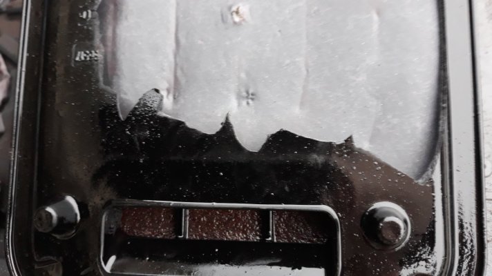

When I bought mine in 2017 it had about 113K on it. I took it to the dealer and they did a fluid exchange on it at about 117K. Next fluid exchange was done at home at around 153K and then at about 184K we finally dropped the pan for the first time. It wasn't that bad at all. So while the shop manual calls for dropping the pan and changing the filter, the dealerships don't do that anymore, they just do the fluid exchanges. Truck just is in the 221K range now and we did another fluid exchange at home again a few days ago. The fluid was quite dark but smells normal. Took a sample to send off for analysis, this transmission's 2nd or 3rd so far.
One of my 6.2 pickups is also due for the transmission fluid to be changed. She's in the 130s now and we did it at around 90K or so. All fluid exchanges so far.
The third truck, our 2012 6.2 Sierra had its transmission go out in the 130s (TECHM). She has had a 6.5" lift and running 35s since almost new. One daughter drives the truck and refused to change the fluid. A refurbished transmission and new torque converter were installed and she also refused to change the fluid in that one. The fluid was really dark like mine last time we checked. Now that she's married, her husband will change it soon.
Here's a photo of the inside of my filter at 184K:
