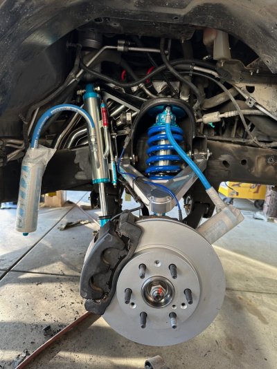

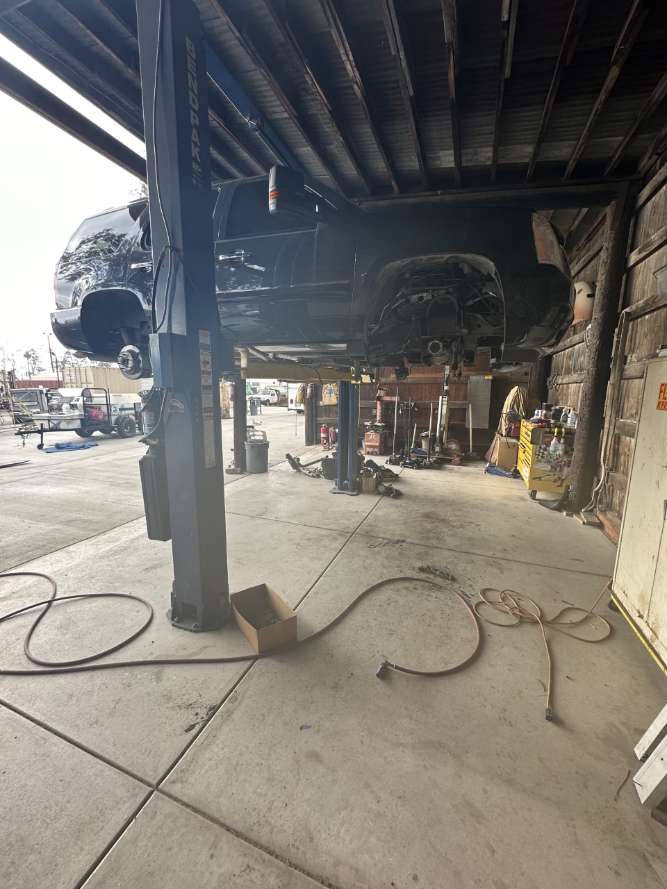

Recently purchased an '08 Yukon for a nice family tow & mild offroad vehicle. Hoping to have everything completed by the end of this year for a few upcoming camping trips. Along with replacing the front suspension, it was in need of some maintenance work.
So far I have replaced:
Front and rear brake rotors & pads
Front P/S cooler
Transmission cooler lines
Transmission service
Oil pan gasket & added splash guard in pan
Updated valve cover
Both upstream o2 sensors
L & R Front diff brackets
Service both front and rear diffs & T-case
Engine service
Plug wires
Both front hubs replaced
Plans for the front and rear suspension are pretty set. I might end up making a few changes along the way but so far this is where I am at. Keeping the rear stock and just replaced the factory air shocks with OEM. Replaced rear coils with HD Moog's. I also plan to add some 2.0 2" bump stops. I want to keep its towing capabilities the best I can.
Front as follows:
Mazzulla long travel kit
Added shock tower
King replacement coilover
King 2.5 2 tube bypass
Heimed front tie rods
Reinforced LCA mounts
A lot more ideas to come. Here are some progress photos.
