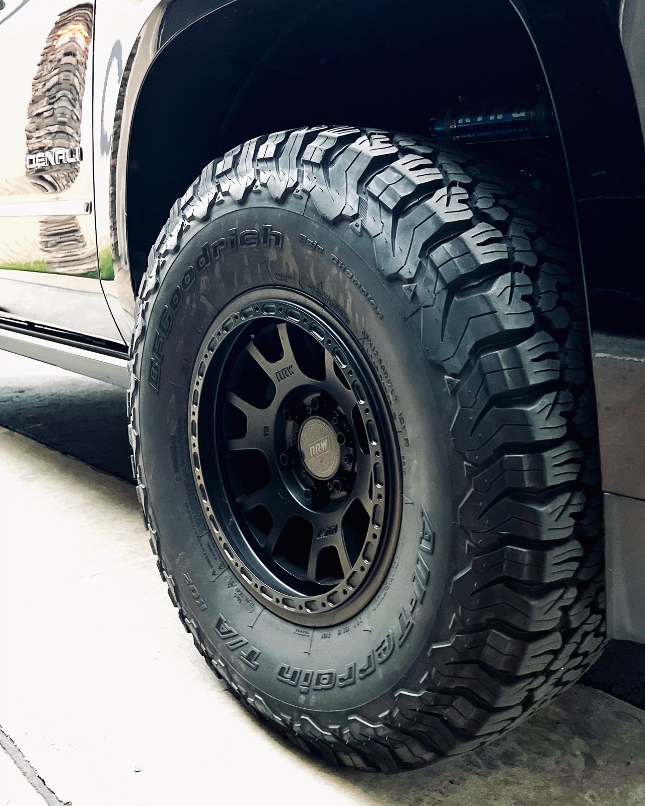

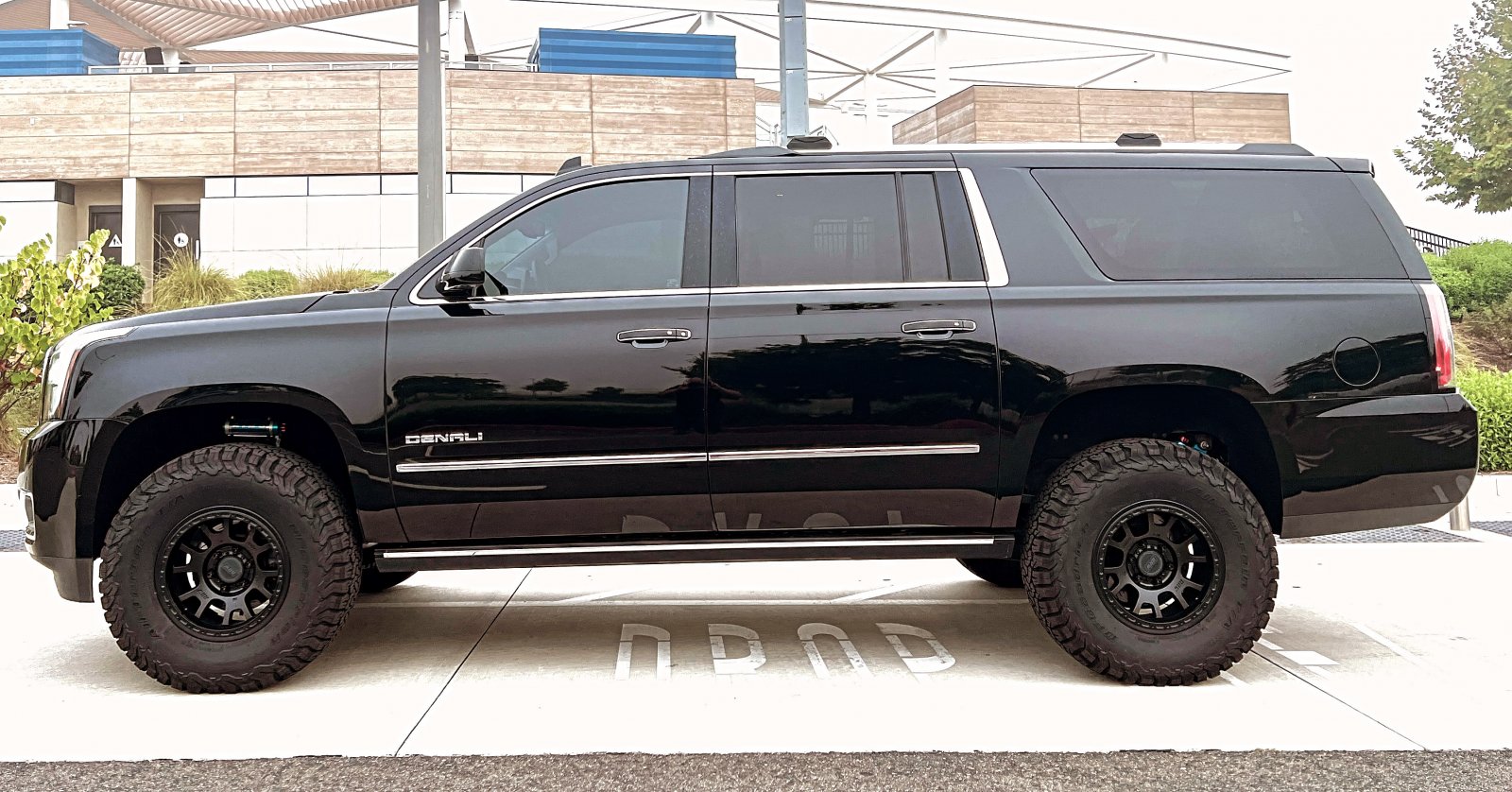

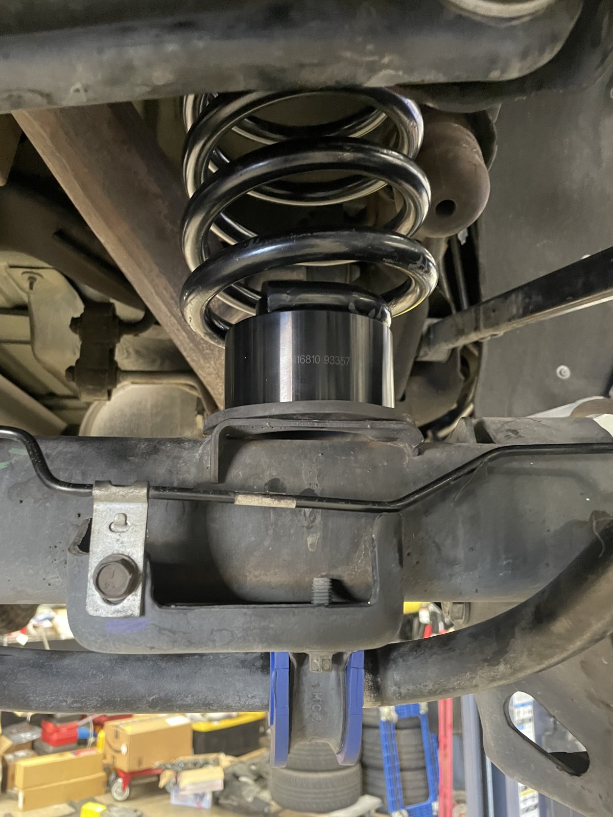

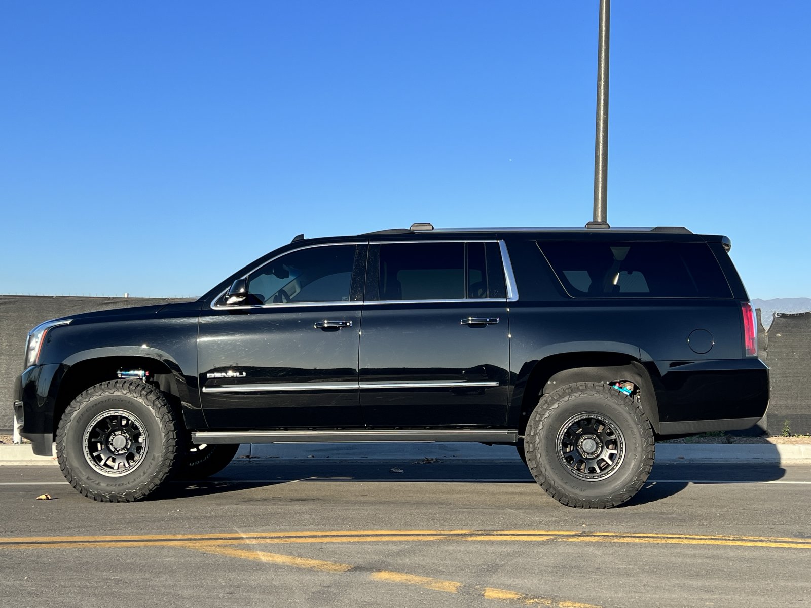

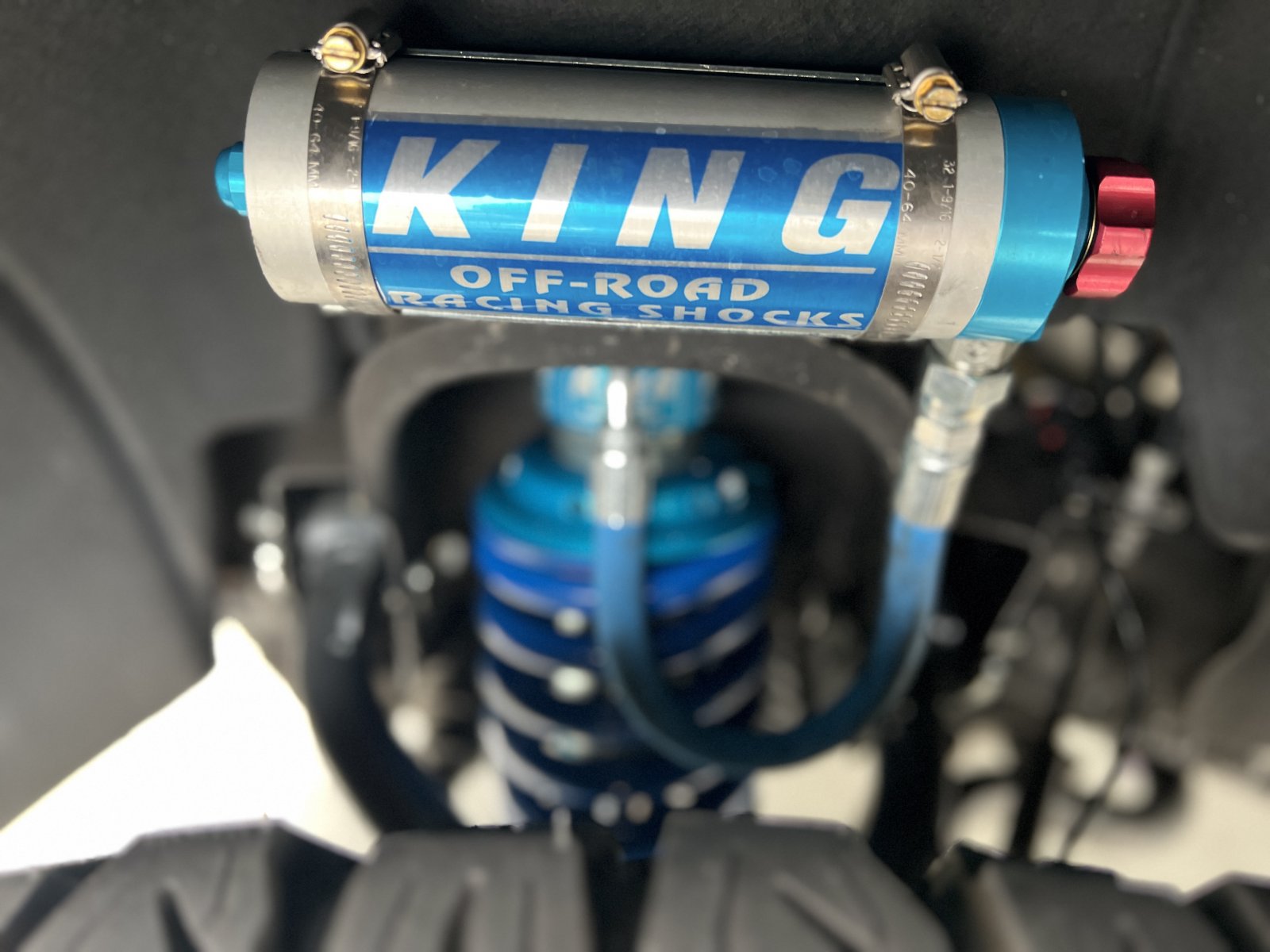

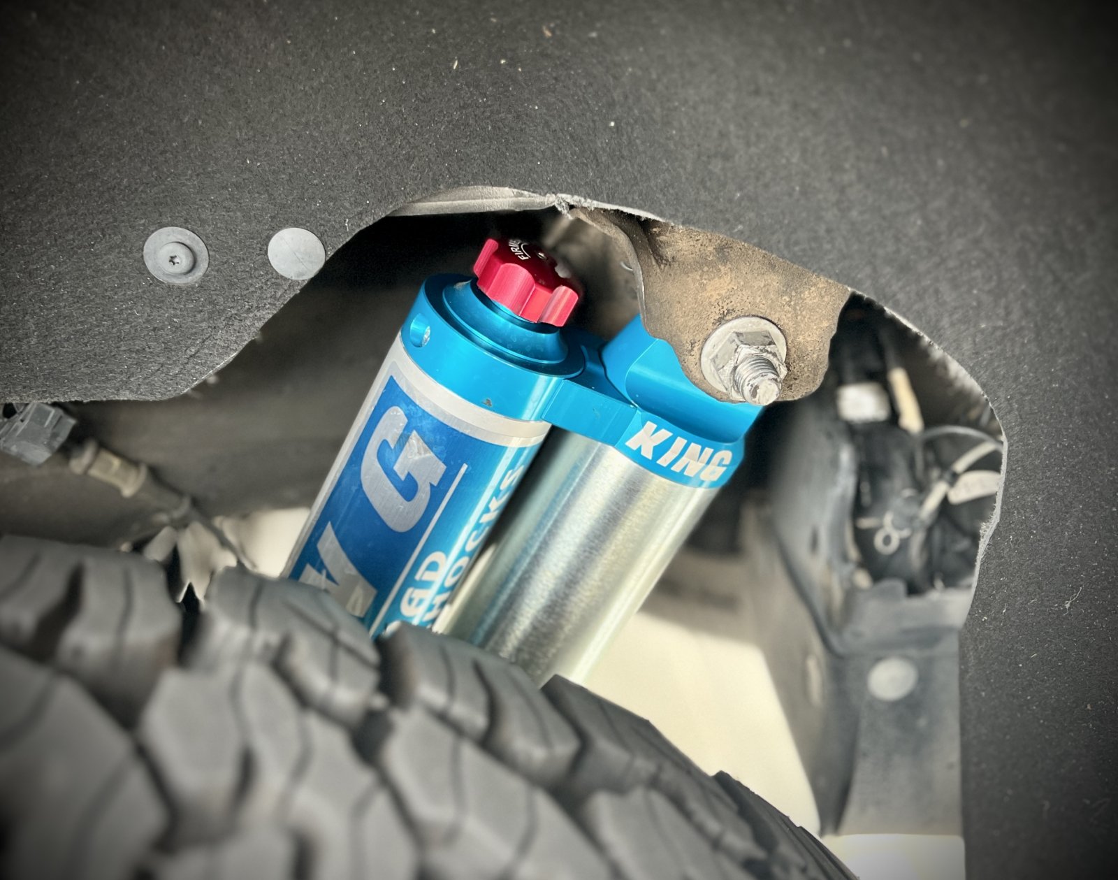

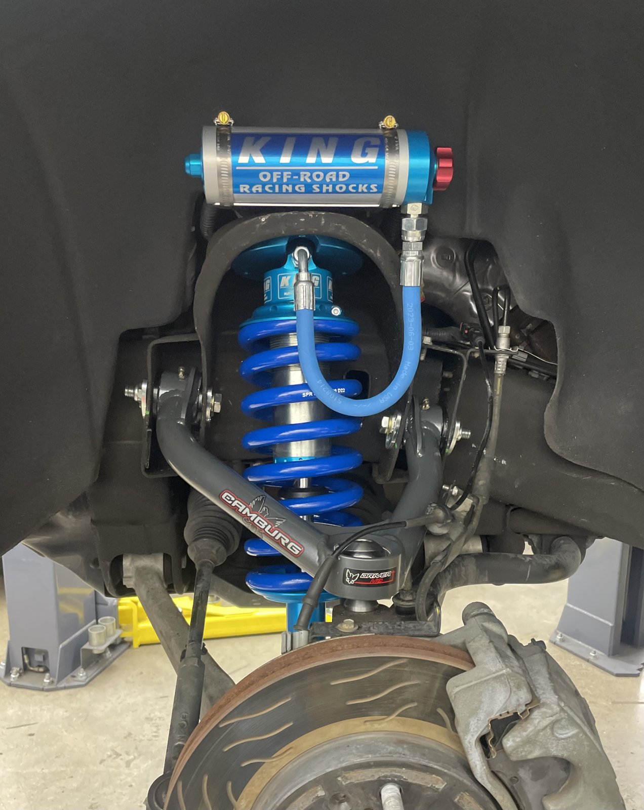

I wanted my rig to have a slight rake to support my roof top tent and camping gear. The rig will be used for occasional camping trips and “off roading”. But for the most part mall crawler and soccer mom duties.
Here is my setup.
Front:
King 2.5 External resivor w/ adjusters
Camburg Upper Control Arms
Kryptonite HD sway bar endlinks
Rear:
King 2.5 Piggyback resivor w/ adjusters
Moog Rear Springs
2” spacers
Other:
Magdelete Bypass module (plug in play)
“SoCal Fender Mod” (My version of the NorCal mod)
Fender liner trim
Removed end cap for the front stock retractable running boards
Banks - Pedal Monster
Shift Technologies - transmission thermostat bypass mod
Wheels: Race Relation Wheels (RRW) RR5-H
17x8.5 0 offset (slight poke)
BFG K02 35x12.5R17

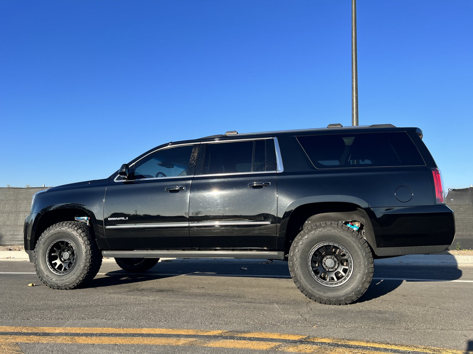

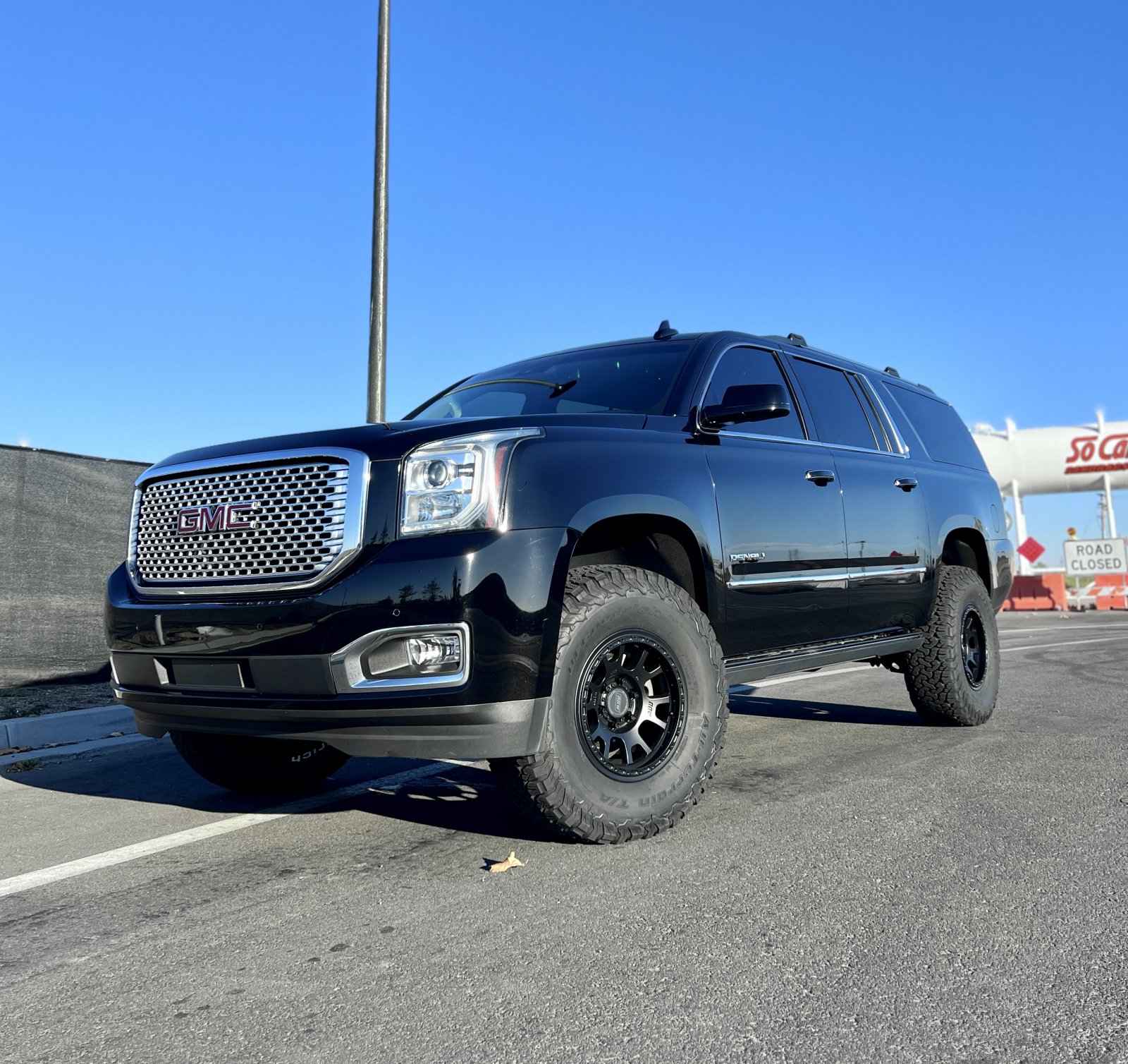

Couple of more pics

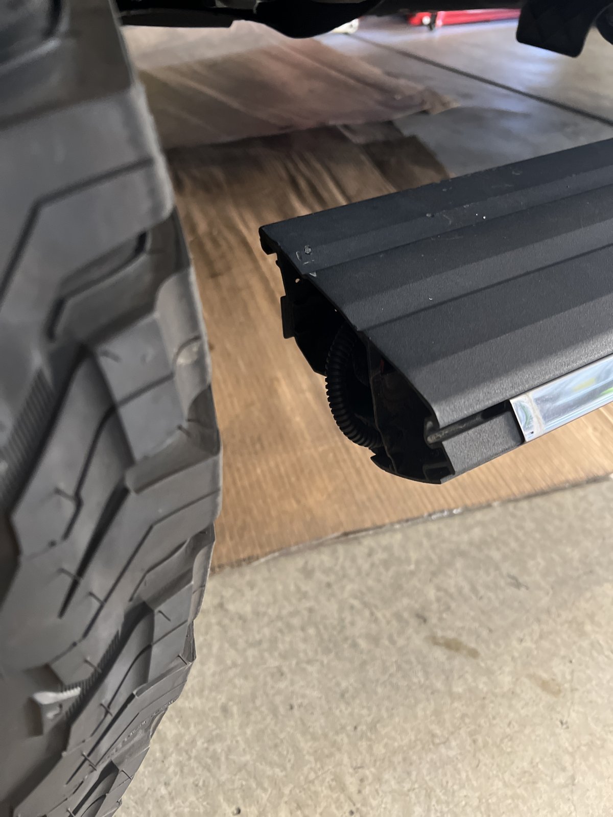

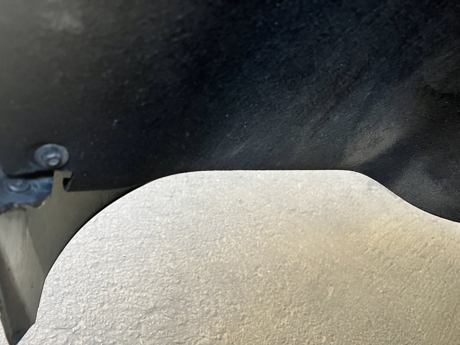

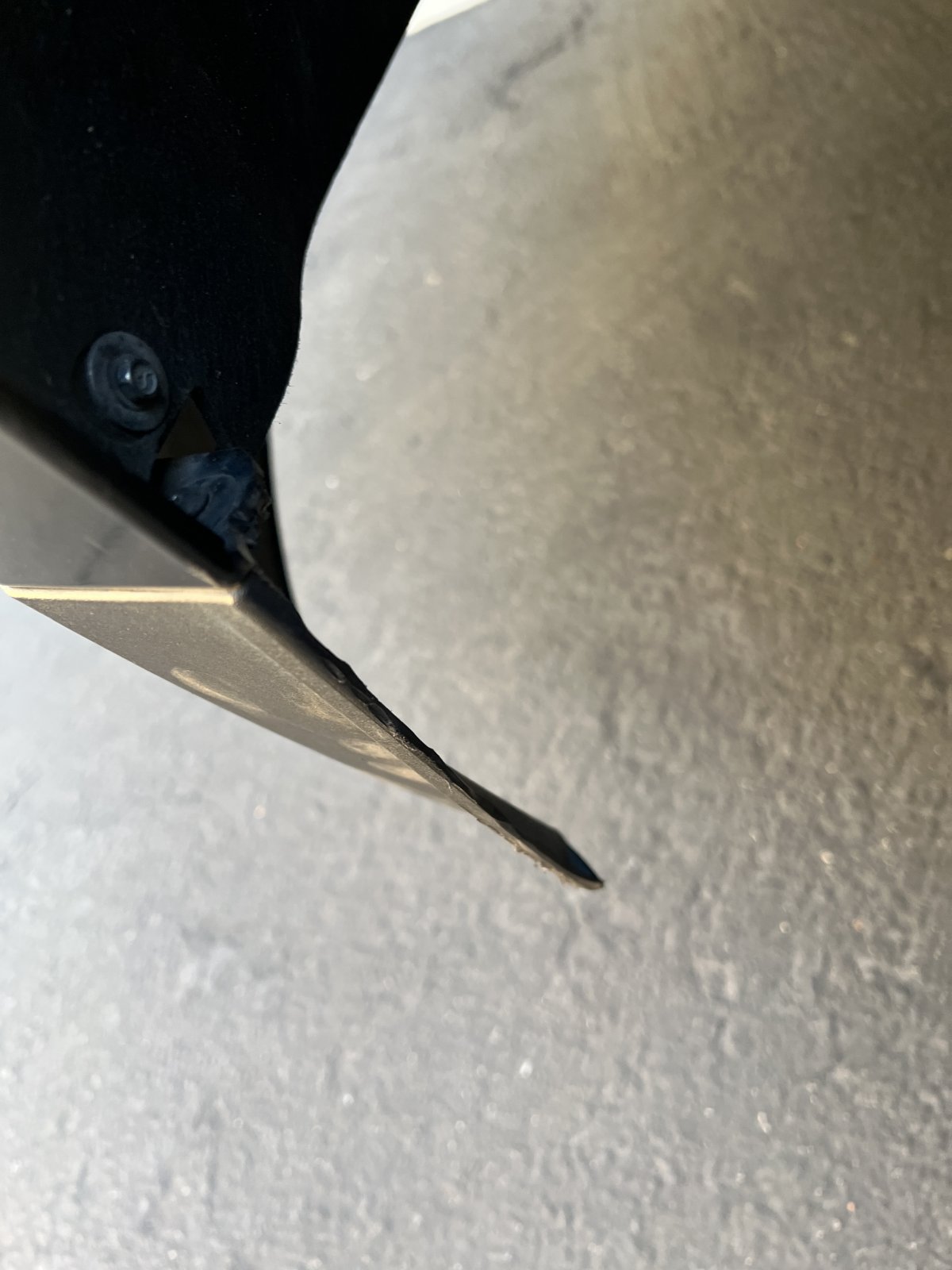

Looks awesome! I'm running a similar set-up but only 2.0s in the front and 33s. Would you mind posting a couple pics of where you had to trim in the front? Mine rub a bit at lock.
J
Jisnis
Apr 11, 2015
34
21
The rubbing for me happens at close to full lock. I took out the bumper support pieces in the front (where fender liner bolts up too) and front valance. Then I trimmed the fender liner in the rear. I still get some rub but I didn’t want to cut the liner too short.
