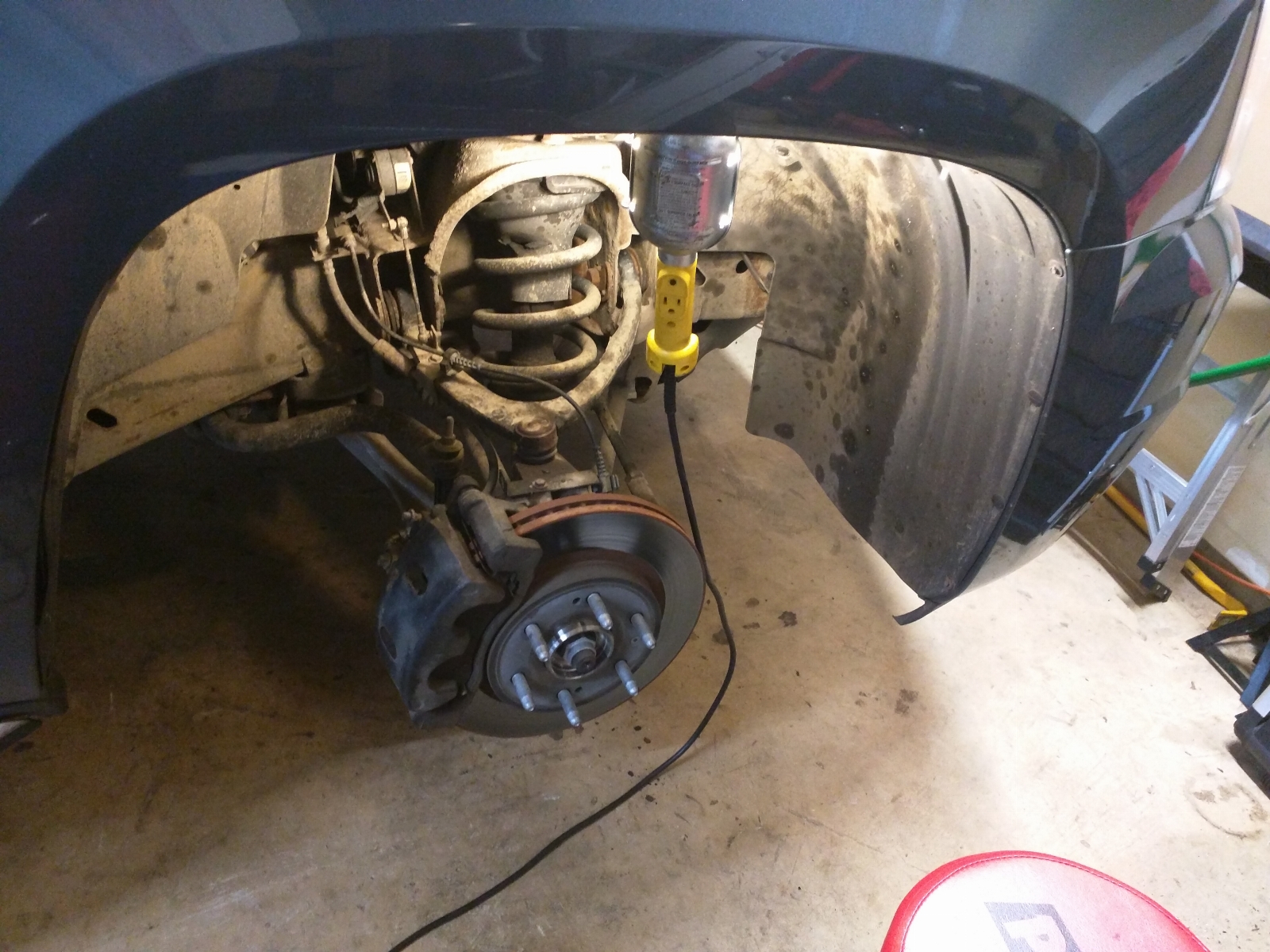

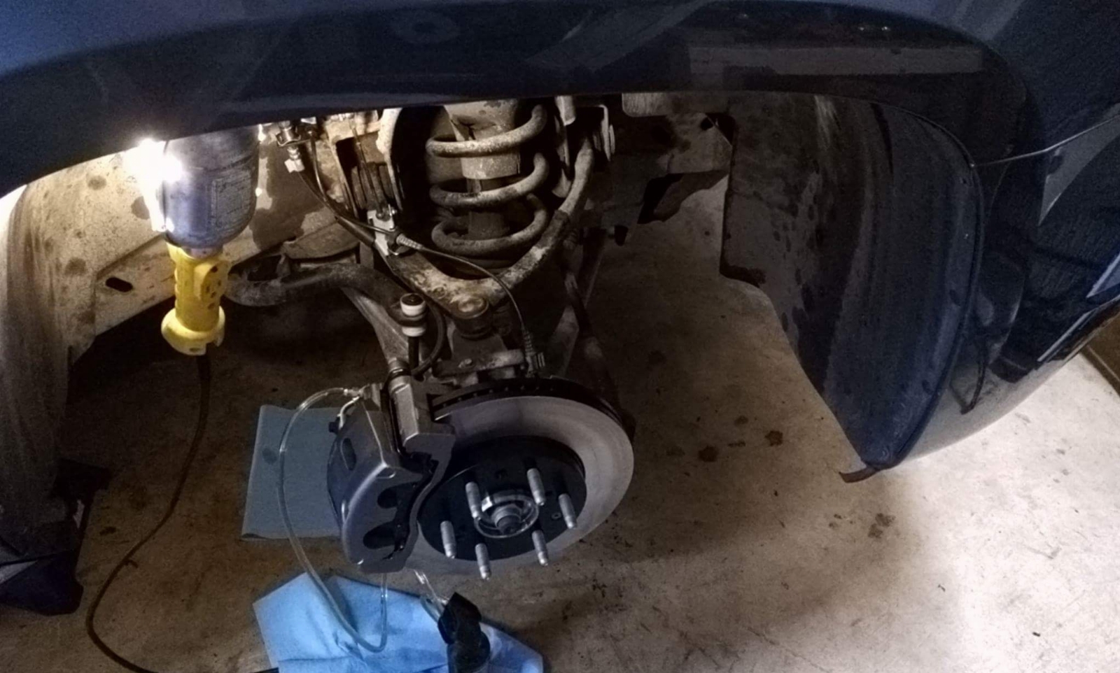

A couple days ago my passenger brake locked up. Smoke was billowing out. This is the wheel a shop in Denver replaced a wheel bearing on. They did something, maybe damaged a brake line. Anyways I replaced the caliper, rotor, pads, line, and for fun the end link.
This rotor is blue from heat.
All new parts.
I have a new caliper and line for the drivers side. Also have a new drivers side hub for a long weekend.

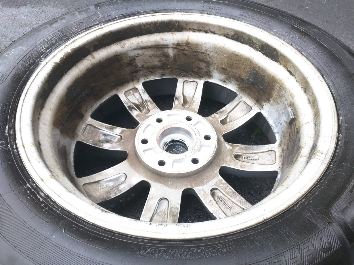

I agree. I was livid. On top of all this when I was 13 hours out of Denver I found my passenger wheel coated in thick oil. The idiots missed a zerk fitting and blindly pumped a fist full of grease right next to the backside of the rotor. I guess it heated up and when I hit a bump would make contact with spinning bits and fling all over.

This is the oil covered wheel. Probably 3rd round of wiping down. I had just finished the outside face. This was pristine silver.

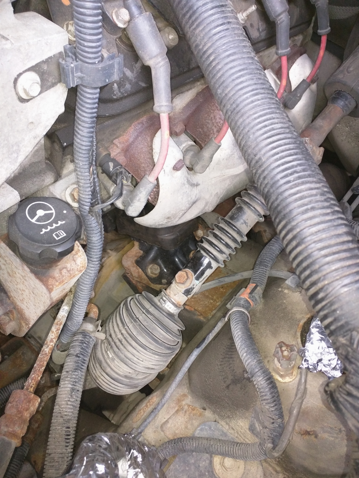

New motor mount. The old one was trashed. I think my tune stressed the stock one too much.
