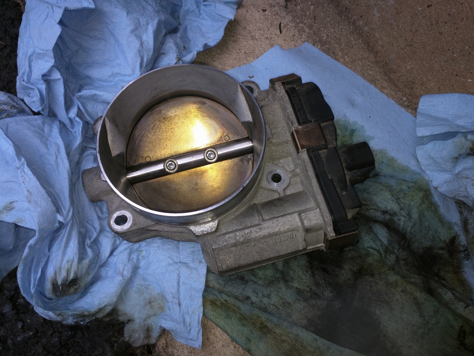

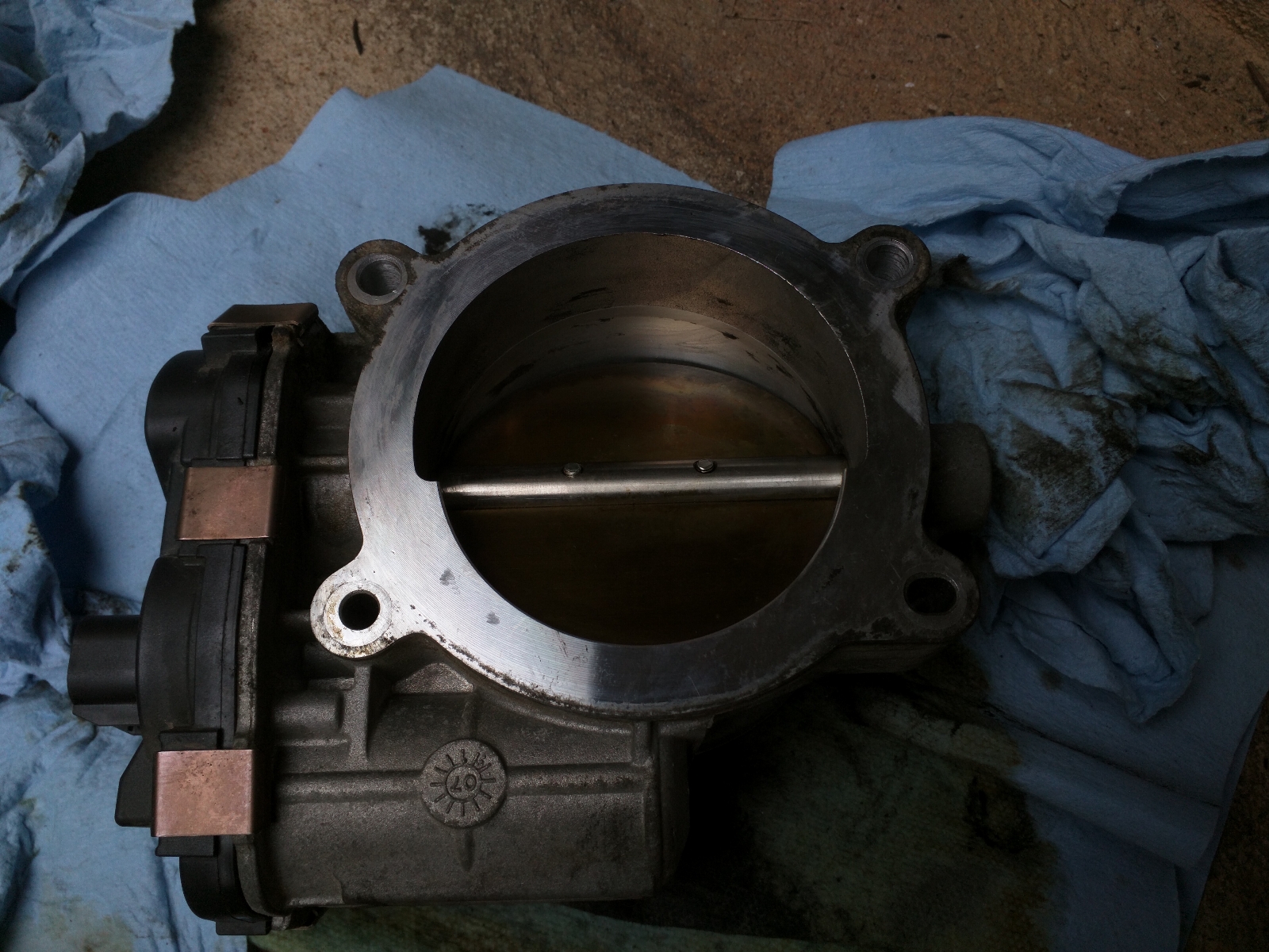

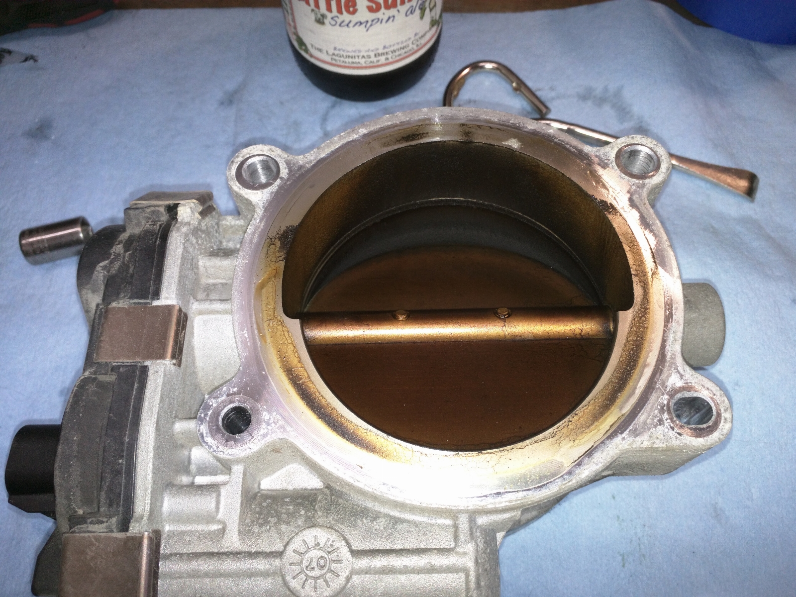

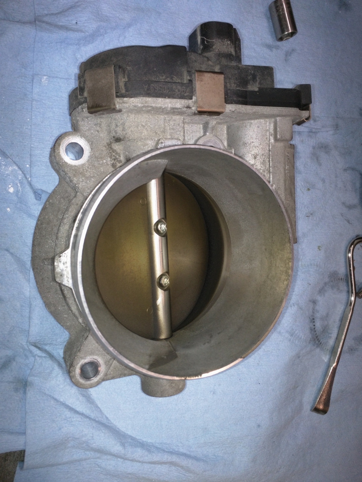

I'm working on making my idle smoother. I did 3 things.
- reprogrammed the pcm to idle a higher at 625 rpm
- cleaned maf. Use dedicated maf cleaner.
- cleaned throttle body. Use dedicated cleaner for this as some destroy coatings and the plastic.
Holy moly this is dirty
After cleaning
The pcm takes time to relearn the throttle body after it's disconnected. Shifts are weird and throttle response sucked. I did a few drives on the highway and it's better now.
Overall the Yukon idles nicer. I'll post later if this changes. It's nice that it idles like a luxury (sort of) vehicle should.
Ohh and I read some idle lumpiness is inherent to the engine design. The 6.2 and other engines have heads that flow so well it's hard to get a super controlled volume of air at idle.

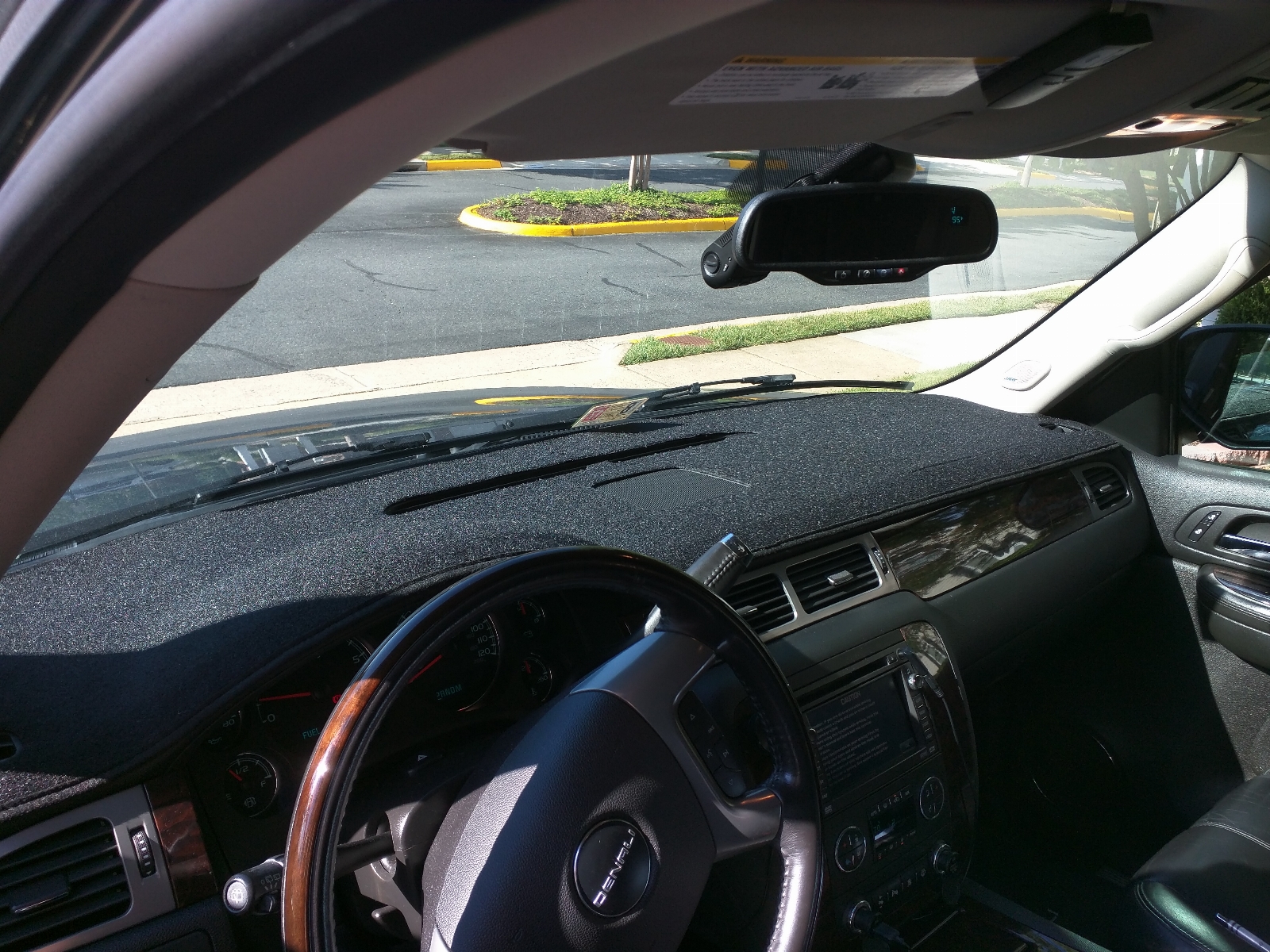

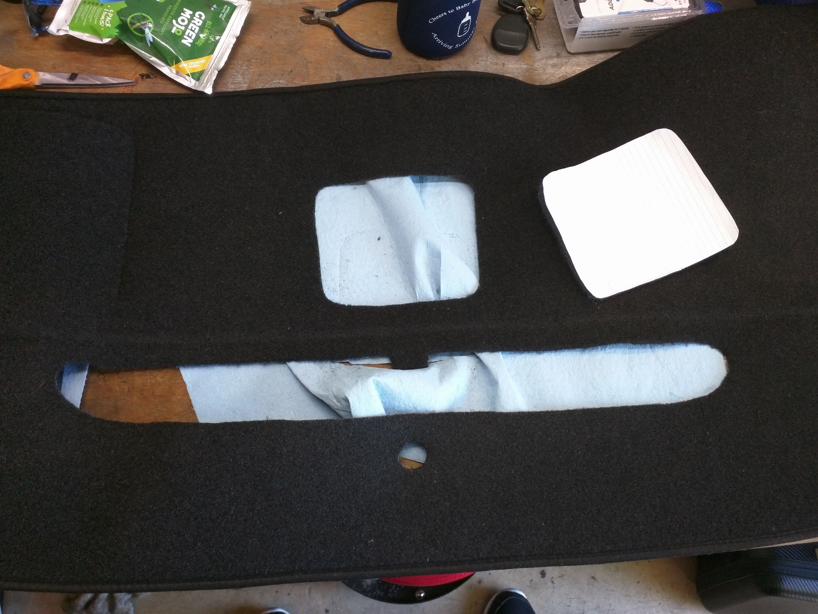

My dash is cracked. I have no interest in removing the dash. I took the lazy way and got a dash cover like my grandparents use to do. The first one I got was the wrong color.
The next one I got had no hole for the center speaker. My bad. I'm too lazy to return again so just cut the hole myself. If I can build a trans I can handle some cutting!
It fits and looks better than cracks.
Beyond that I have my engine tune down and am fixing some things in my trans tune. She runs like a ***** ape!

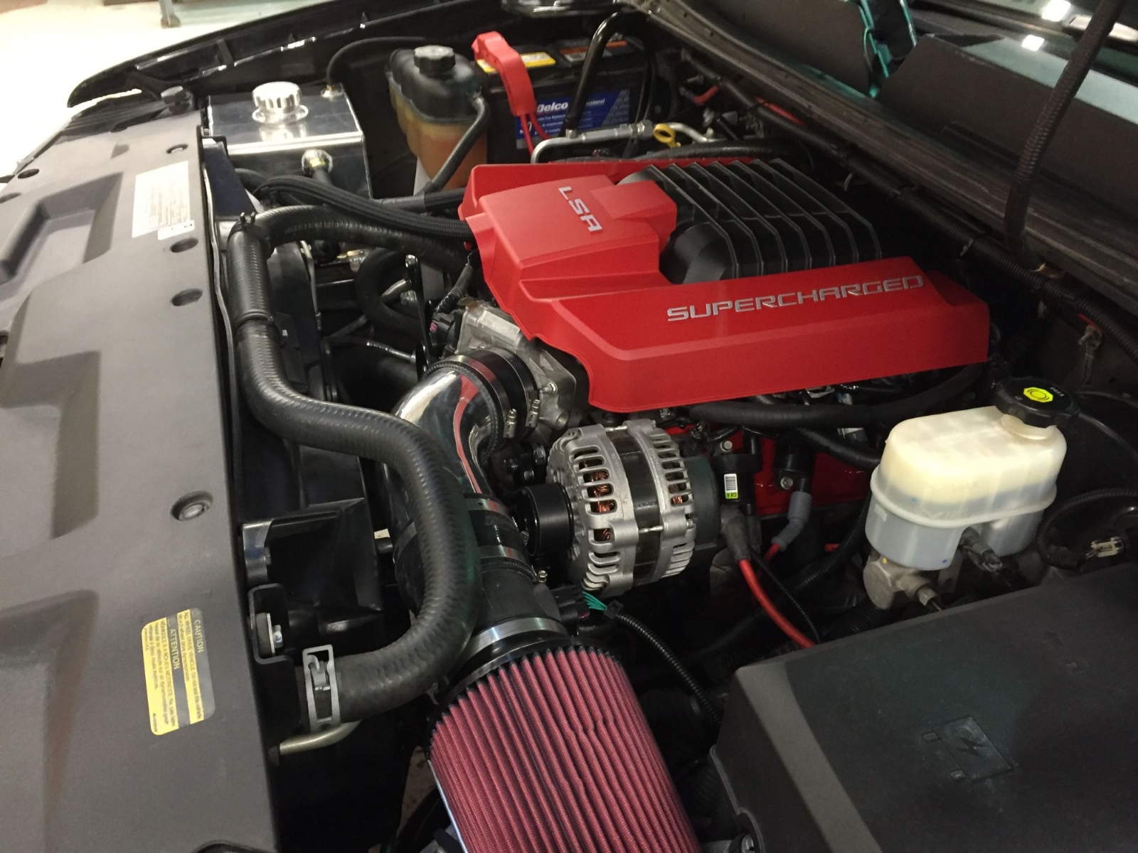

Next in the plans, LSA blower. I've had a turbo car, time for a supercharger. This is my goal!

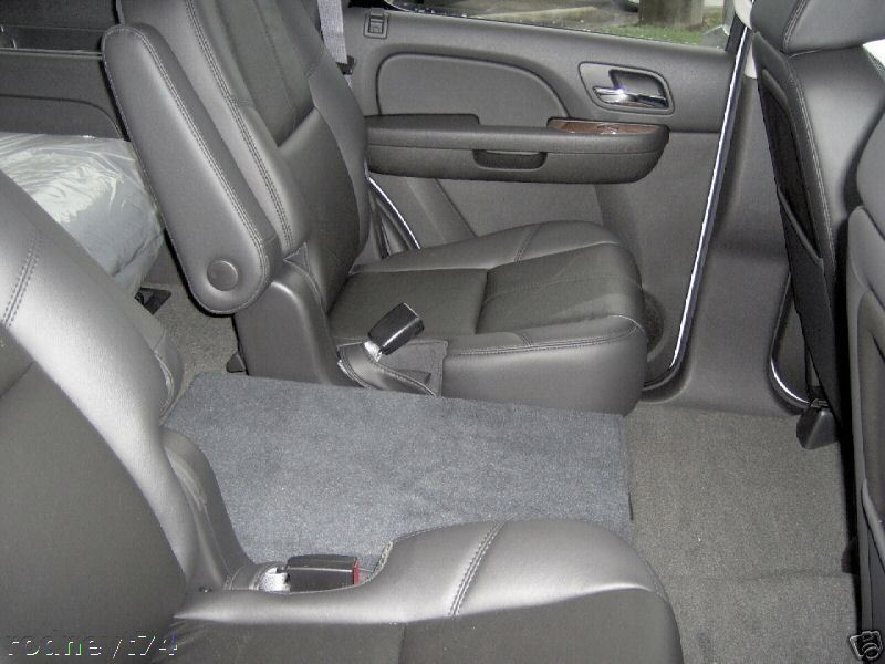

Before the supercharger I wanted to finish sound and the interior. I picked up a sub kit that fits between the captains chairs. It has a 12 inch "square" kicker sub and a is a bit taller than in the pics.
It arrives in a couple weeks!
