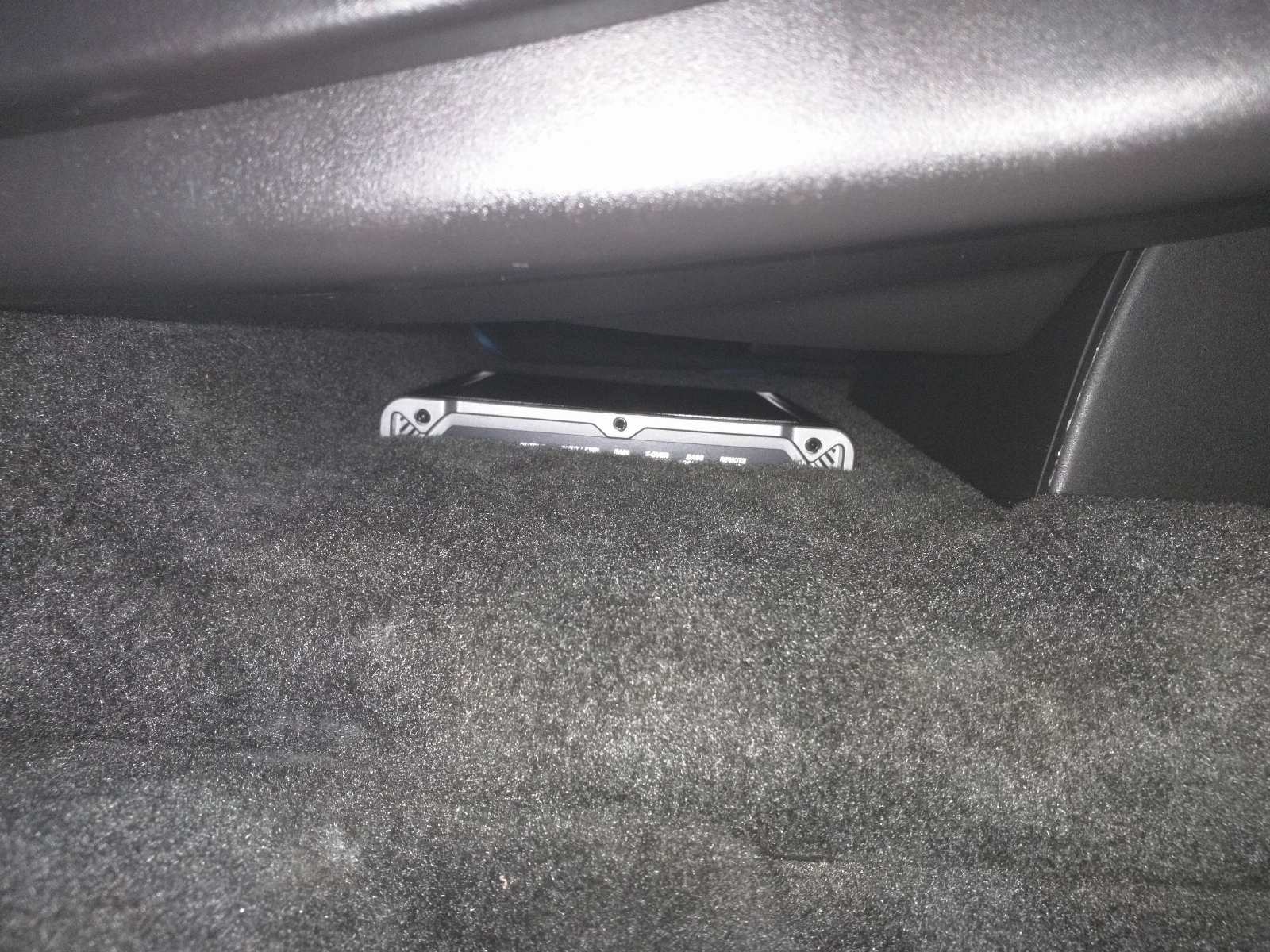

I got the sub in. Kicker solo baric s12l7 with 700watt rms amp. Gotta clean up the wiring now.
It's not broken in yet but first take is holy shit. I've never had this much sub. I'm getting old and can't imagine why someone would do anything more!

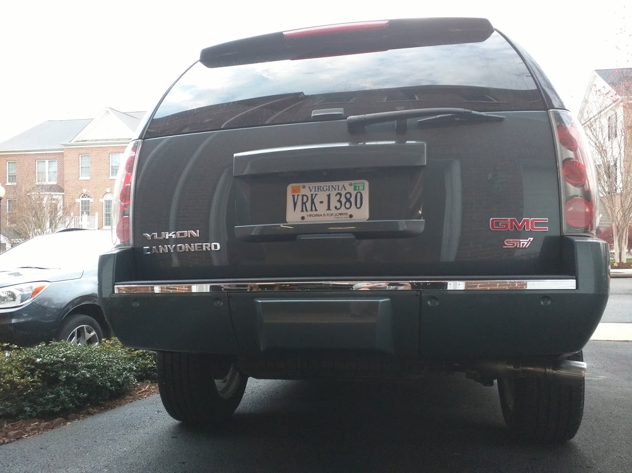

I did a SLP resonator delete. I need to clean up the cuts since my hack saw had a hard time with the stock 3.5'' pipe.
Im not sold on the looks. I might remove the tip and install something more hidden. The resonator is gone, thats all that matters.
It does make the sound louder. The inside isn't louder when driving normally. Getting on it and cold starts are louder for sure.
