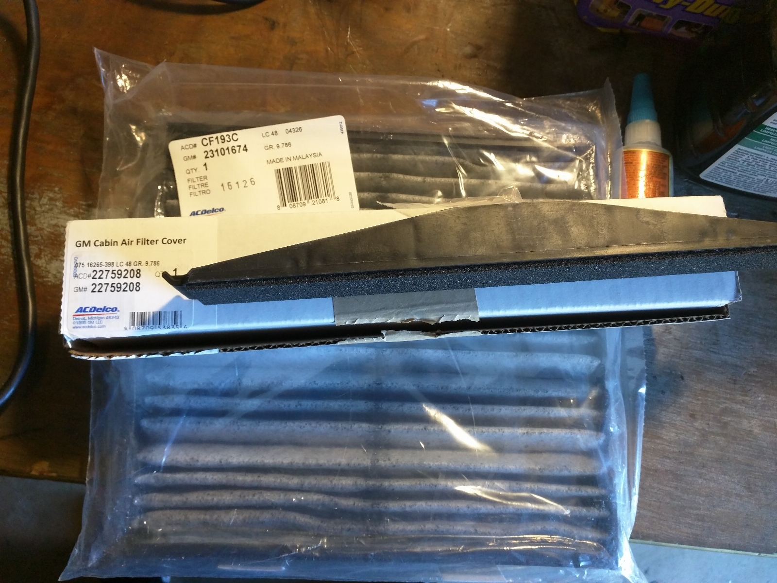

I've got a kit coming that allows for a cabin filter too.

Also, what kit is it you have on the way for the cabin air filter?

It's an official acdelco retrofit. You cut a hole like where the nbs filters are, insert a filter and use the new part to cover the hole.
I'll post pics and part numbers when it get it.
EDIT: I asked my wife today if she smelled anything. She said there was a complete lack of smell. Before she said it was musty like an old sock. I got a carbon filter with my kit as well.

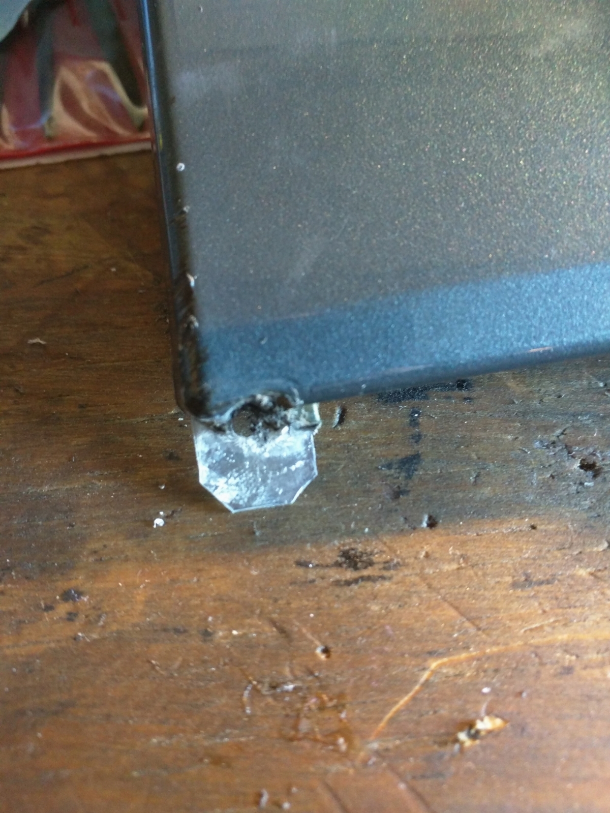

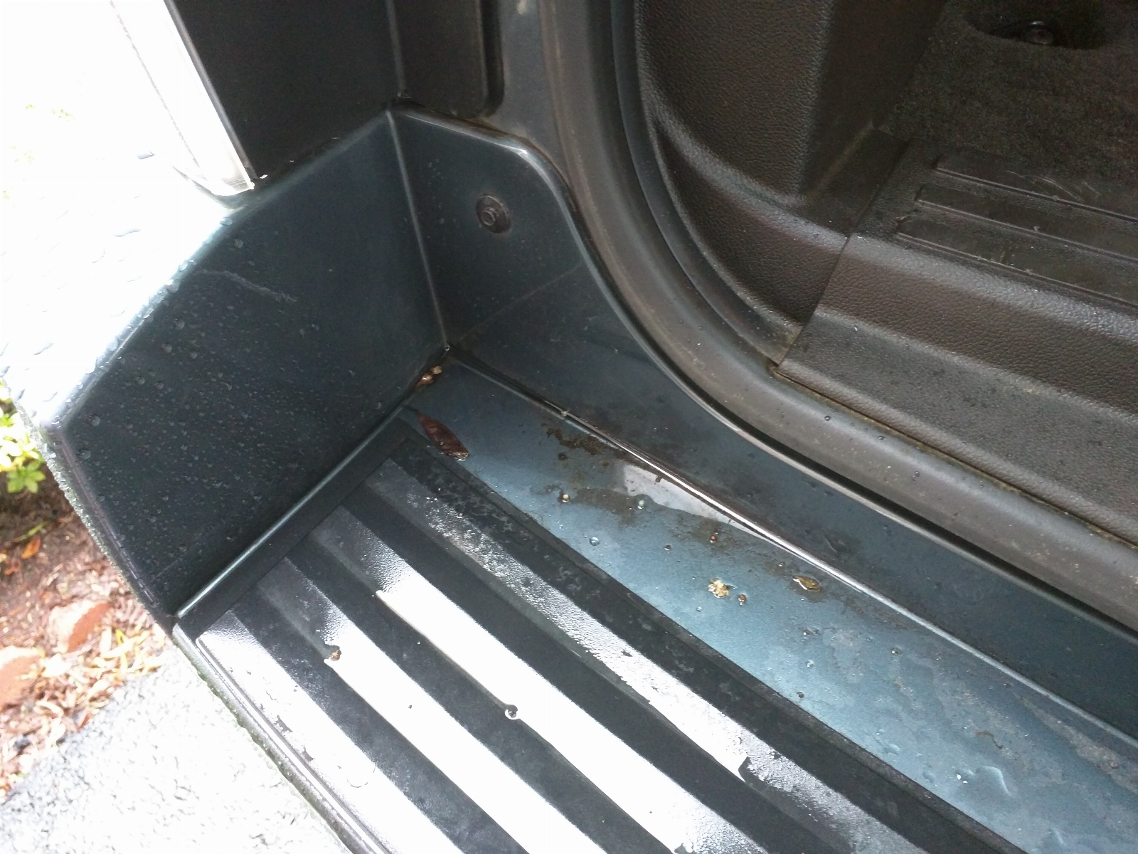

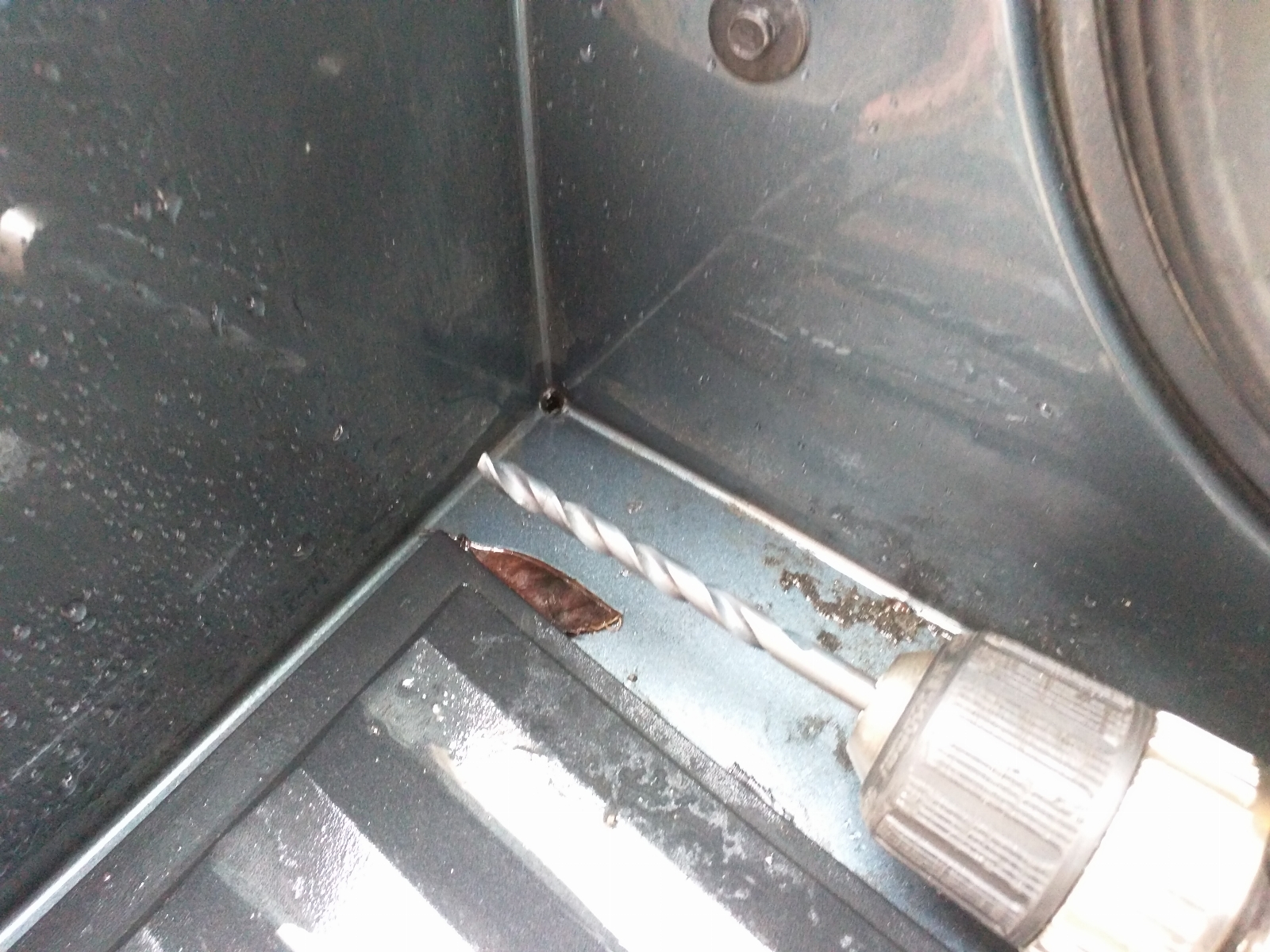

This is the pooling causing my hatch to rust. I park on a hill.
I drilled a hole in each corner. Much better!!

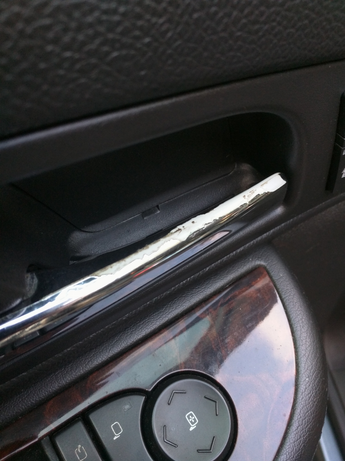

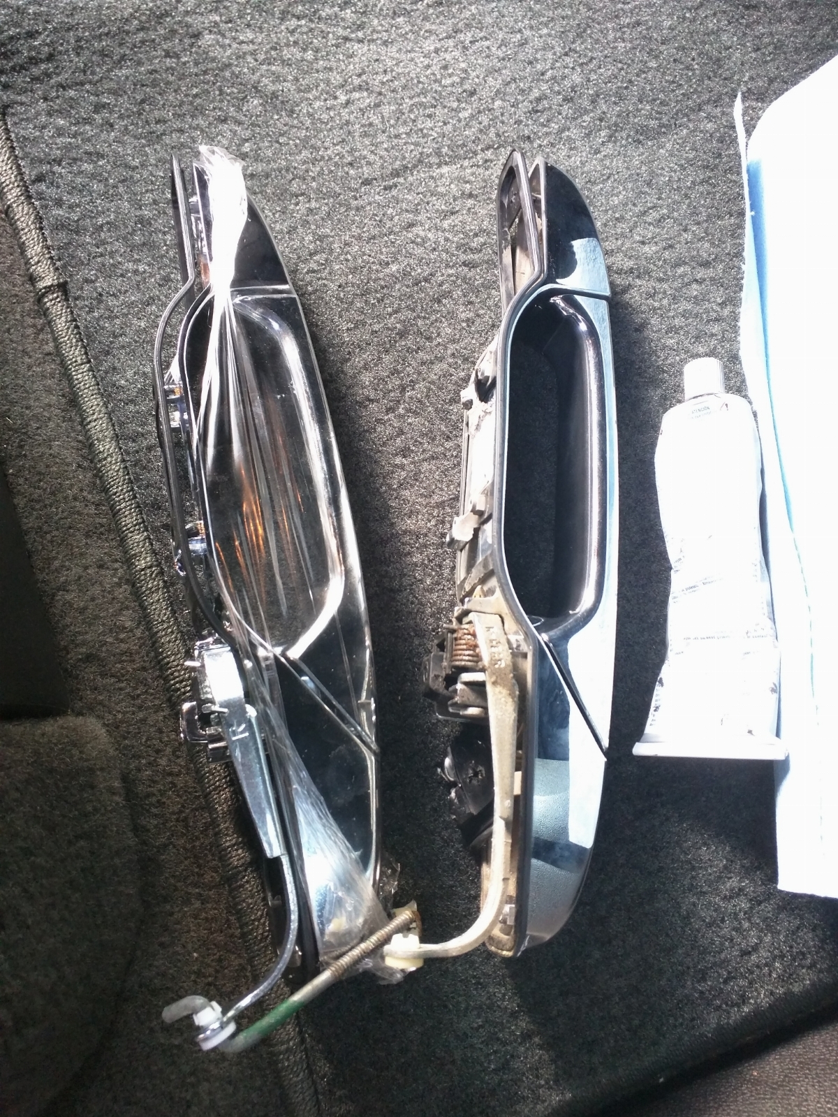

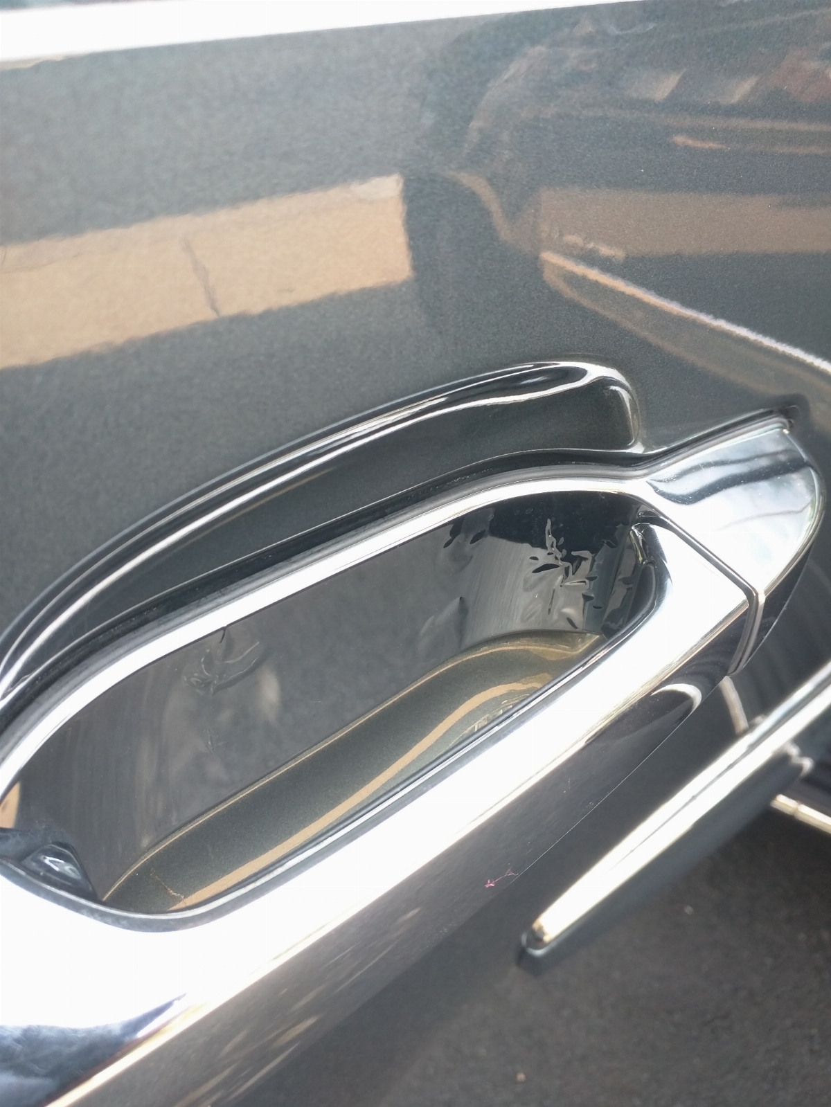

Drivers door inside handle had peeling chrome so I replaced it.
Passenger rear door handle chrome was loose and bubbling.
New part

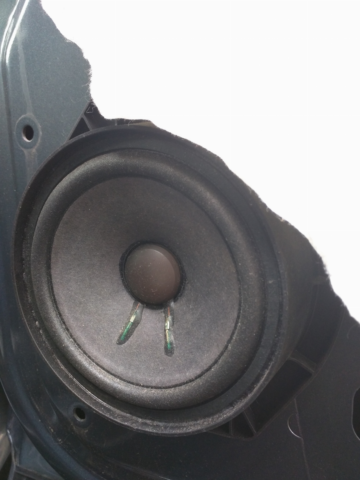

The speakers aren't rotted like my last nbs Yukon. Yay!

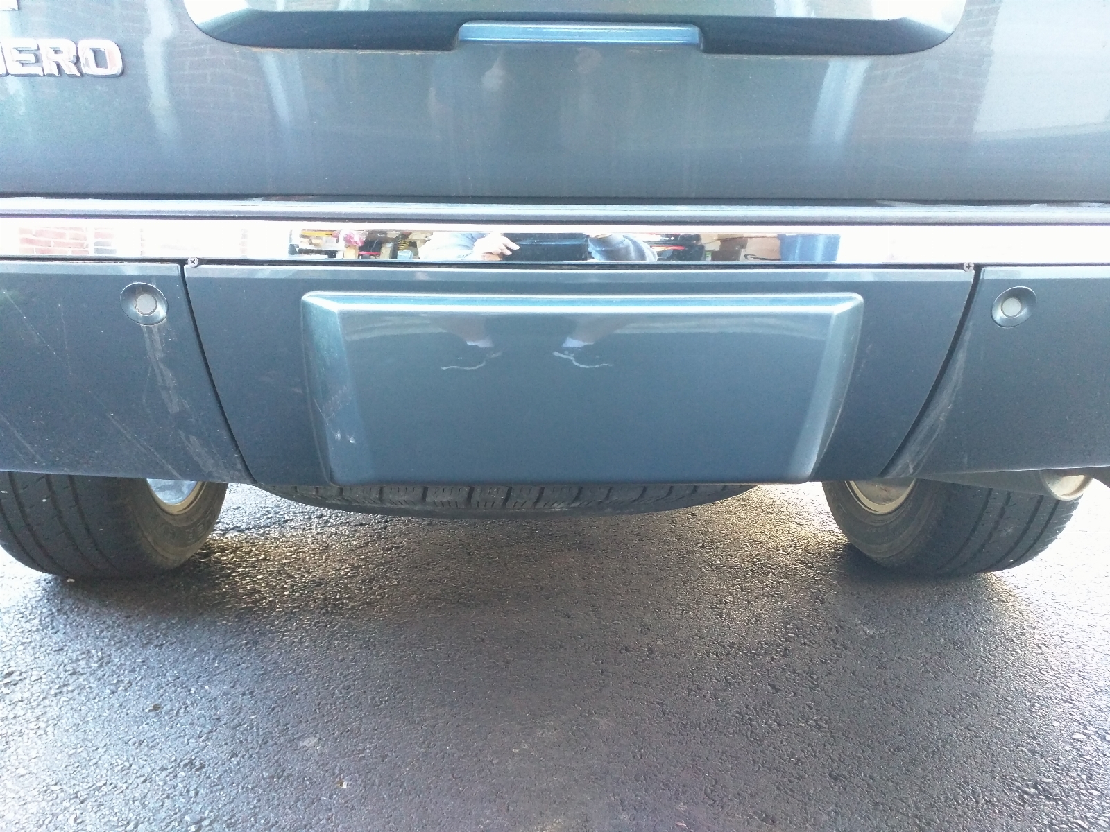

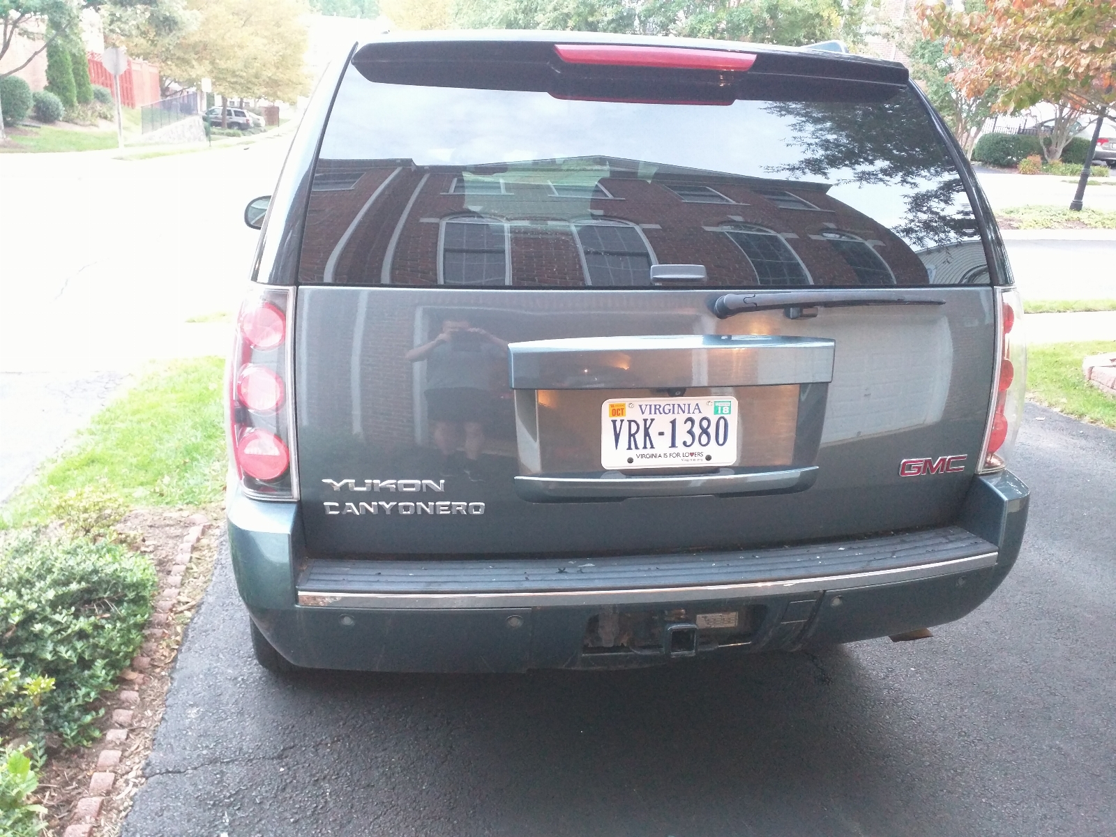

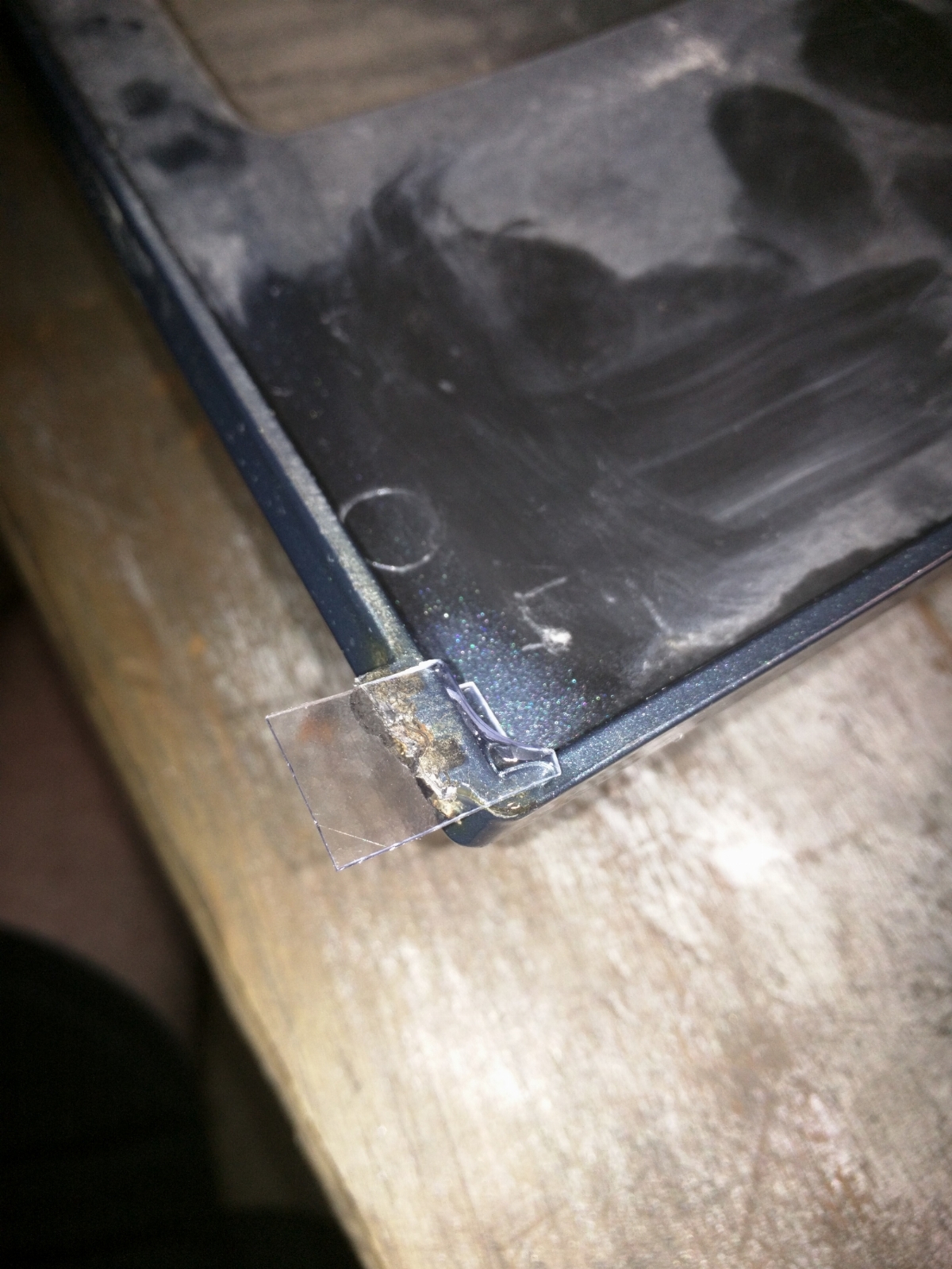

Hitch cover was ripped off instead of properly removed by previous owner. WTF?! I'm trying to build up new tabs with plastic bits, glue, layers and time.

About how much time & effort are required to chance the inside door pulls?
My driver-side and passenger-side handles could use such treatment.
30 min per door. I'm slow. Get a good kit for pulling body panels and push pins. There are some good YouTube vids on pulling the door cards.

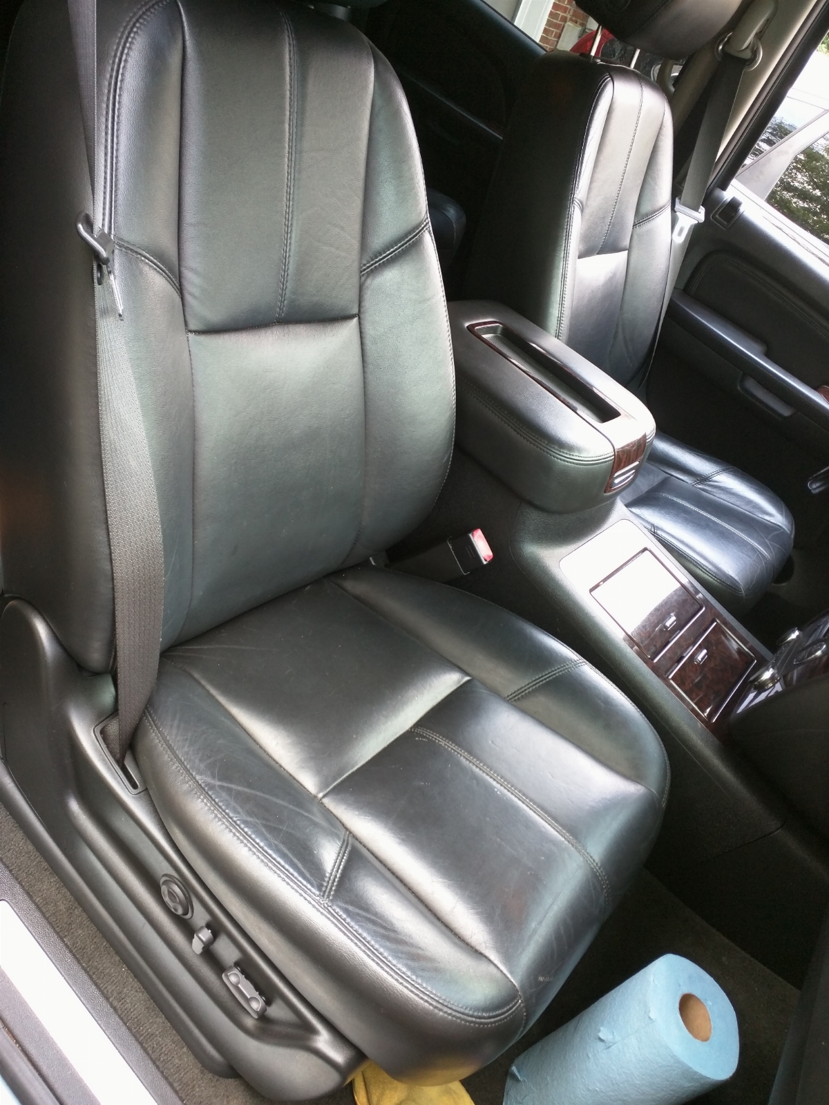

All my seats had scratches and looked like hell. I used leather dye and a good cleaner and conditioner. I forgot to take lots of pics on the scratch removal. Only this pic.
And yes, I'm posting after a few weeks of work buildup!

Cover tabs in place.
On now. Ghetto fab with screws. Ahh well.

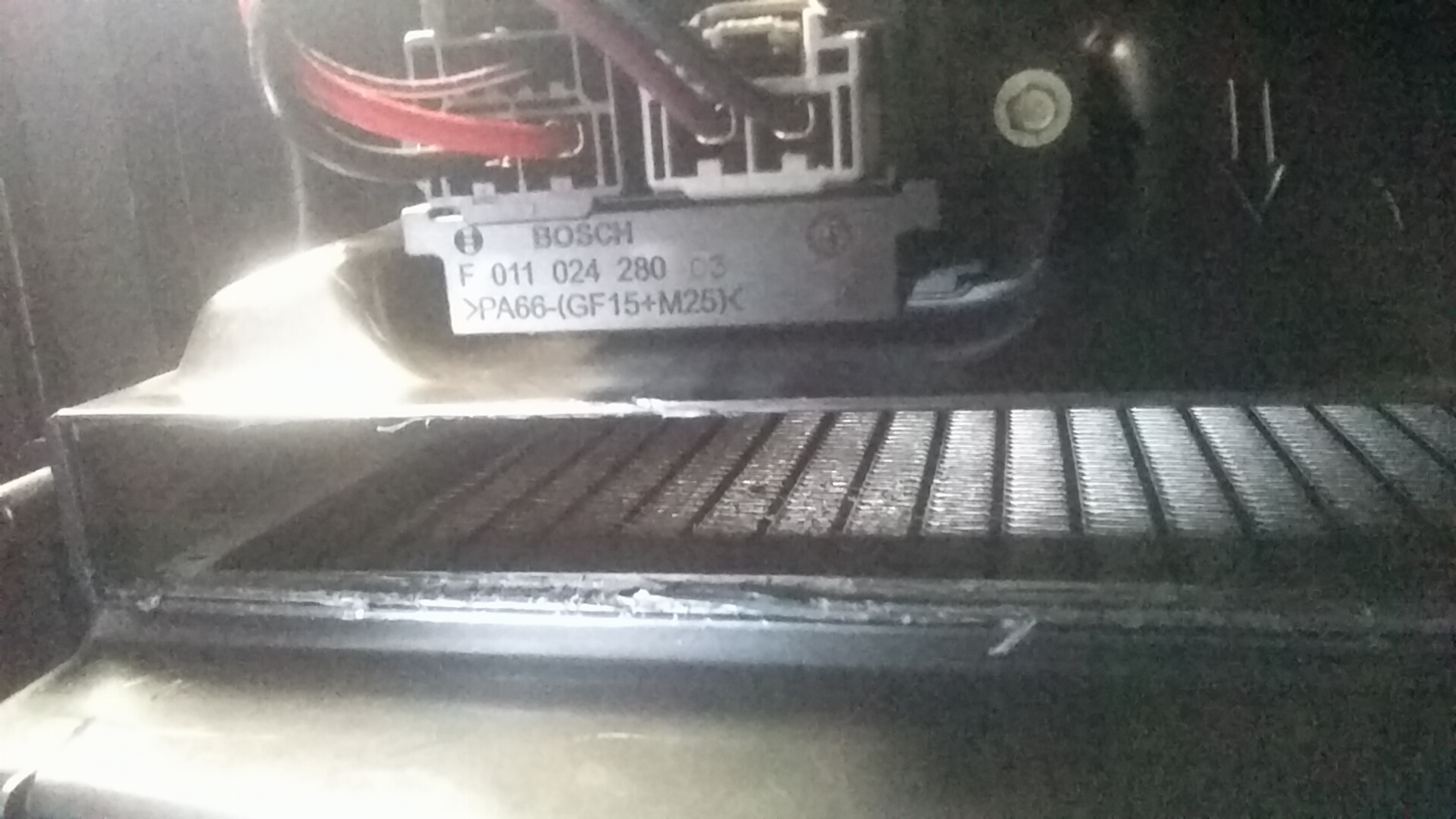

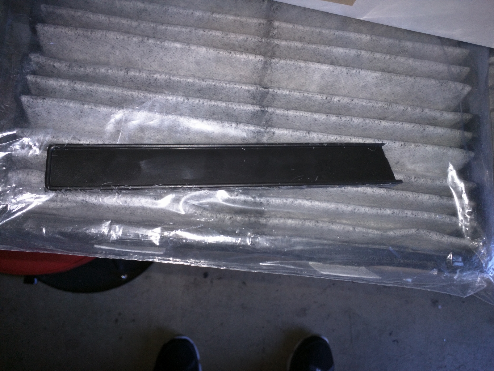

Filter kit with part numbers.
You'll cut this out. I used a razor blade. You'll see where to do this. Score the plastic then stab the blade into the plastic to cut. Be careful, there isn't a ton of space.
This is the hole I cut.

Some good work going on here. The holes in the bumper for drainage is great
Awesome! Definitely going on the next parts order. Thanks!

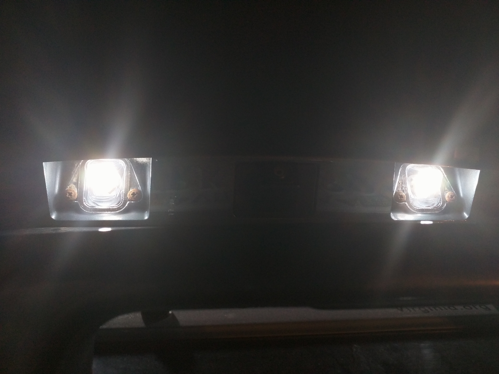

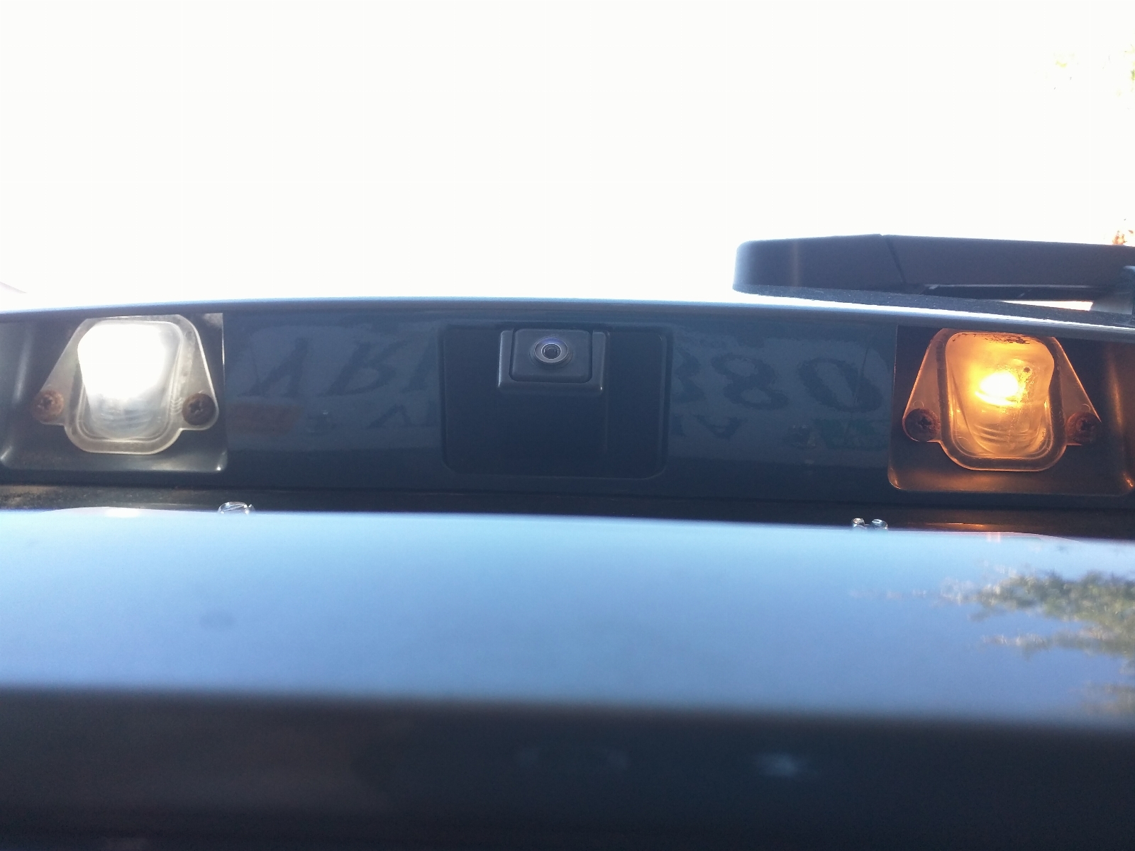

I did some led lights.
Old vs new.
Both new with new plastic covers.

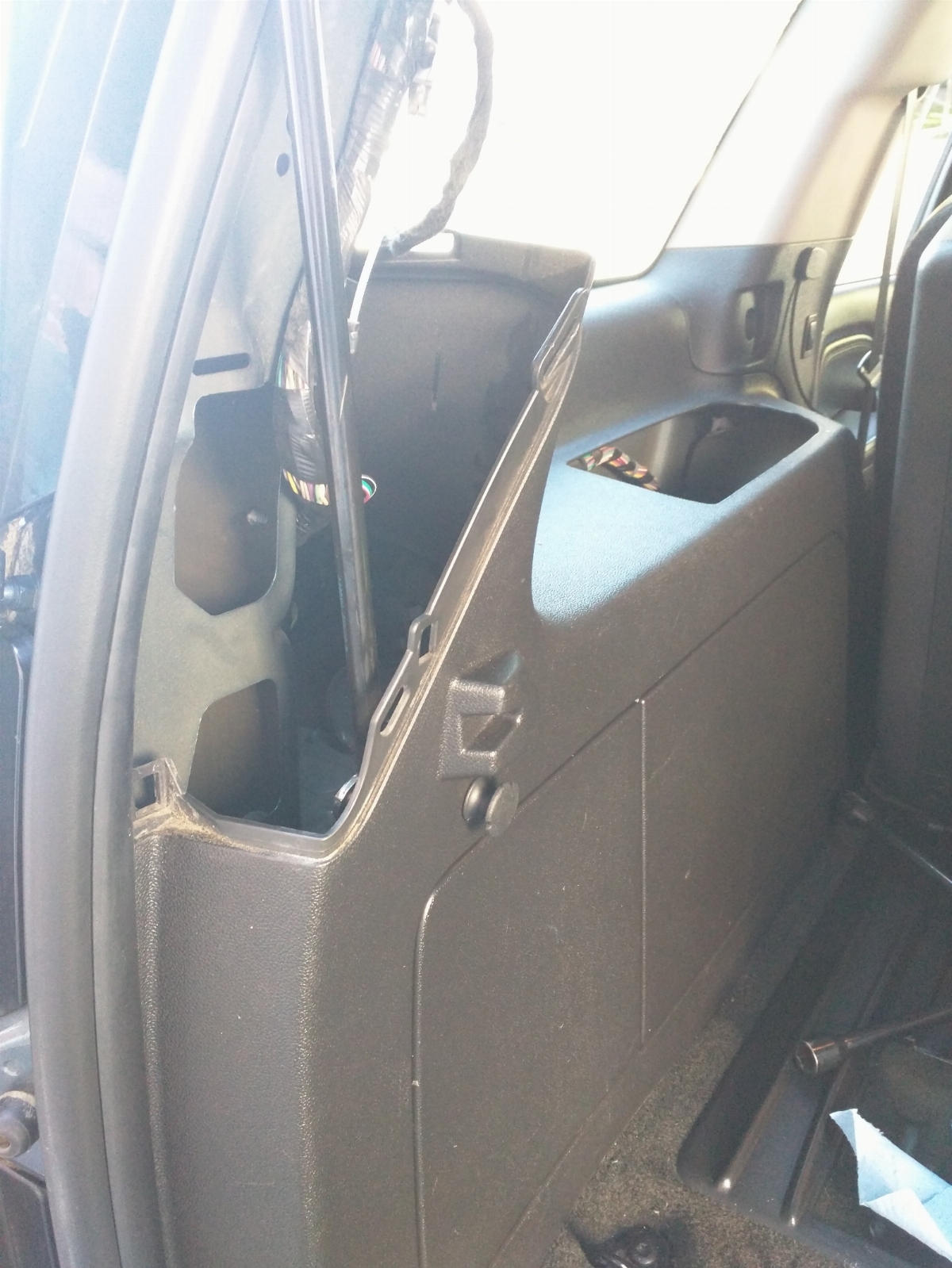

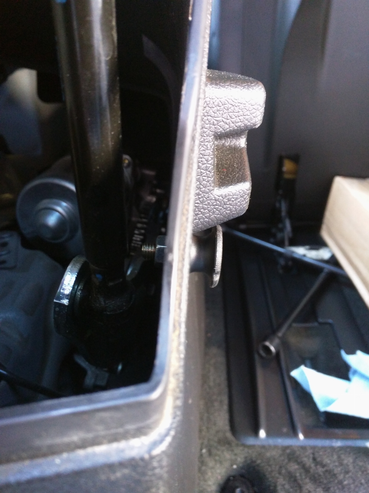

I added a cargo net. Turns out it doesn't work with auto lift gate SUVs. Great. Passenger side drill out has a spot for the hanger to screw in. Drivers is covered by all the lift gate hardware. I just drilled the plastic, and used a lock nut and red loctite.
