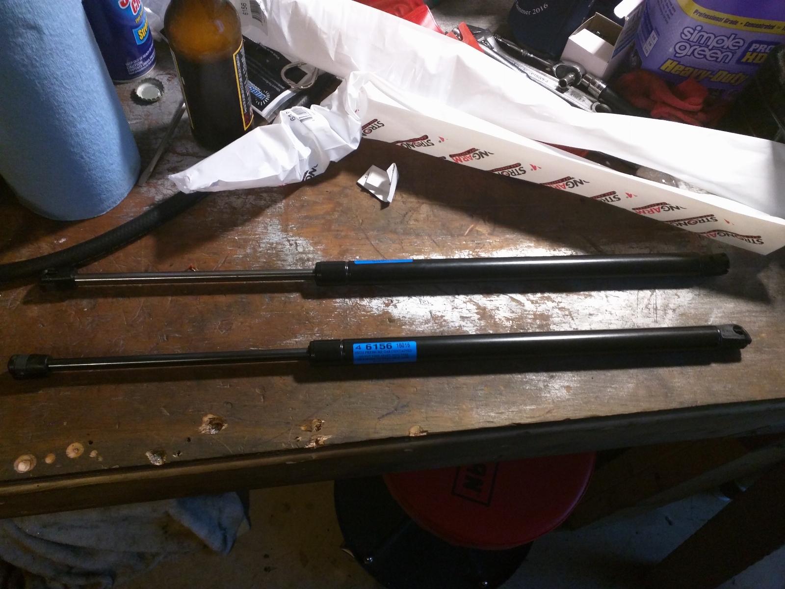

How's your shocks on your lift gate if you open manually? To test, turn your rocker switch off on the over head consol.
I'm pretty ******* manly and strong, so the shocks don't seem to have much resistance. I don't know what's normal. I plan on replacing them anyways. If that don't fix it then I'll eBay a new actuator.

I know my lift gate wouldn't open when the shocks were bad. But mine wasn't making the same sounds yours is.

New struts in. Gate still grinds a tad but at least now functions!

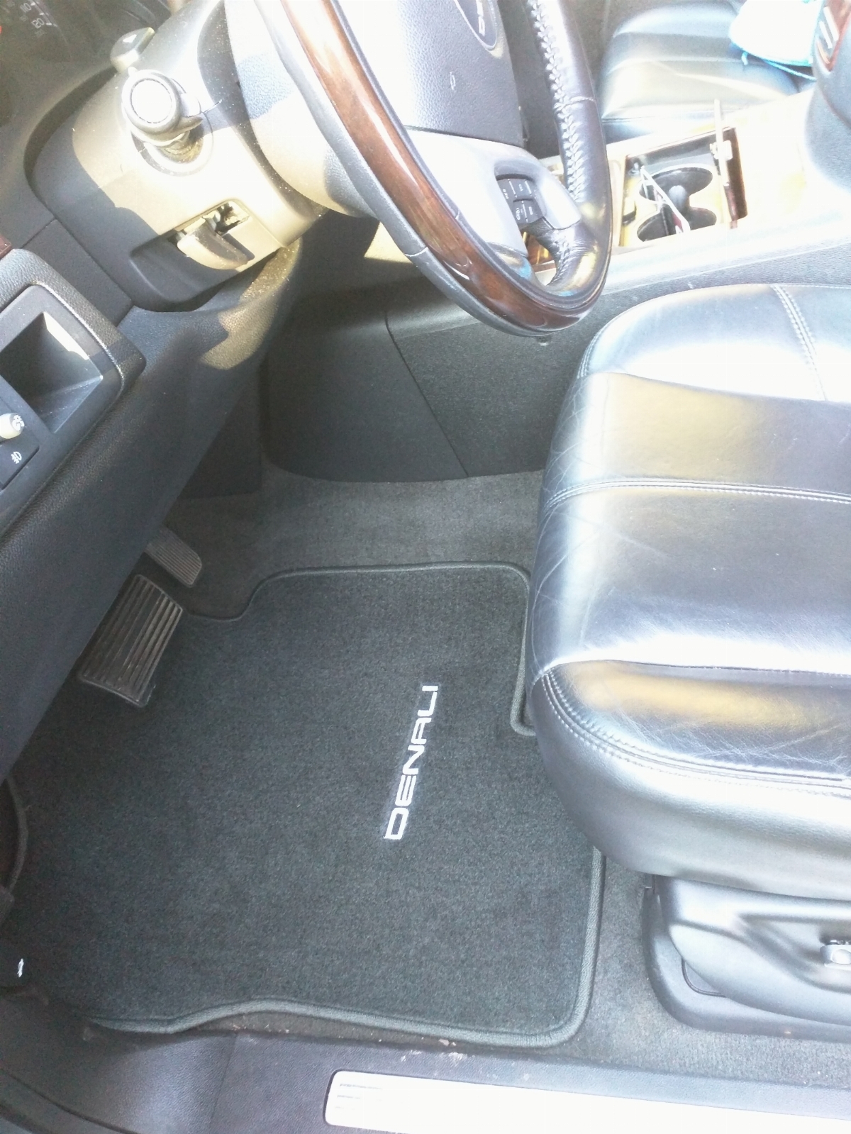

Sorry for the mundane. I'll get to engine, cams and turbos when I have a solid, comfortable platform.
New mats!
Made by....
They fit perfectly

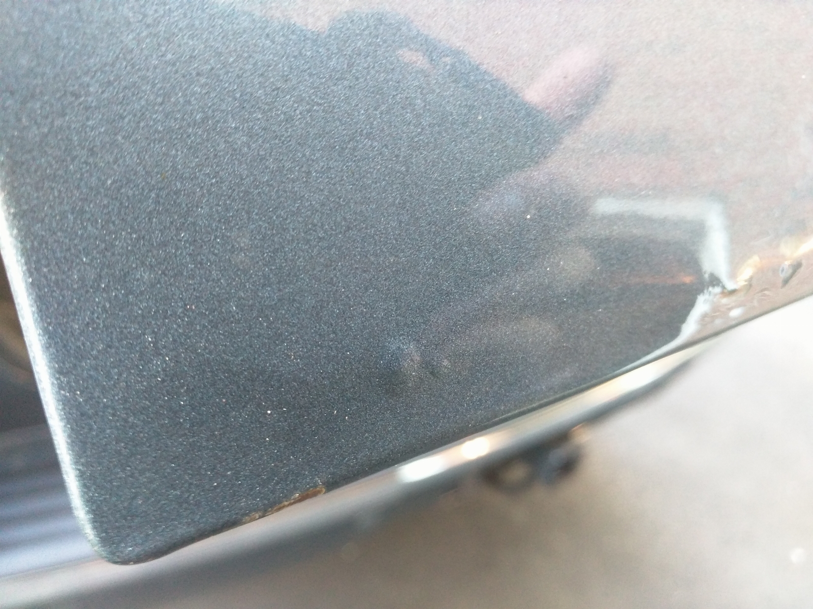

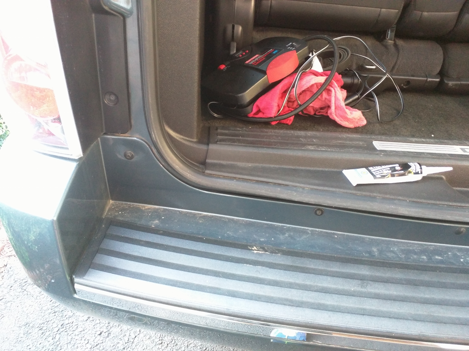

Gate paint rust...

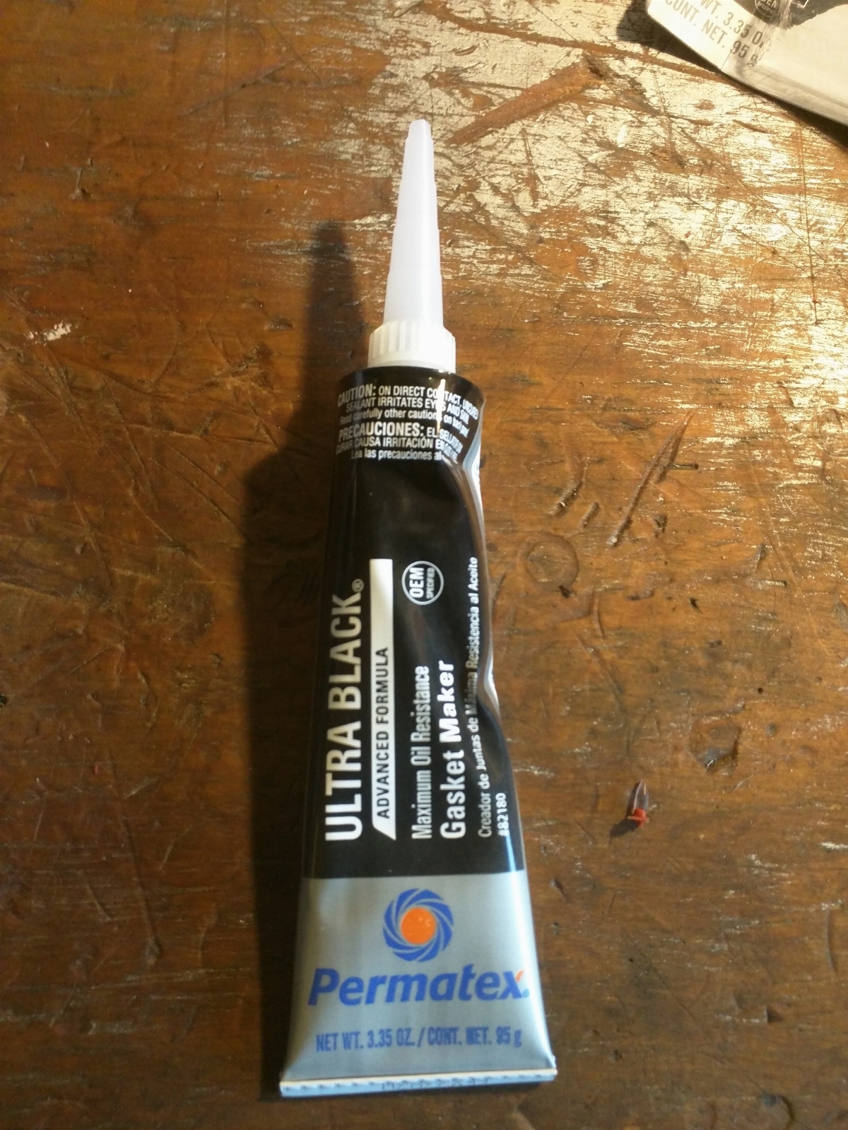

Because this fills with water...
Filled seam with this to stop more damage.

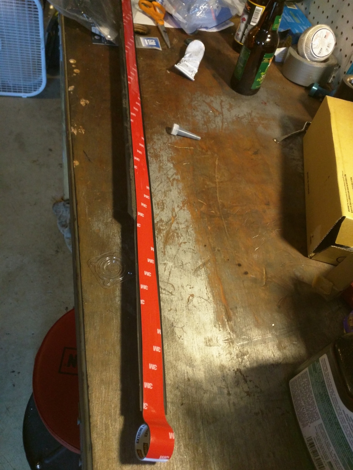

This was peeling up.
So I taped it down
Did I do good?!

Tail gate seam and rear door edge on the wheel well (non xl)are terrible designs.
Water pools and rusts the gate.
I'm thinking of drilling a couple holes for drainage in the far corners of the bumper cover. I felt behind and it would just drain straight to the ground. Too crazy?
50,938
19,345
Seems logical to me. Make them small enough holes and no one would notice and the cover is just plastic so it's not like you'd be creating a new place for the vehicle to rust :shrug:

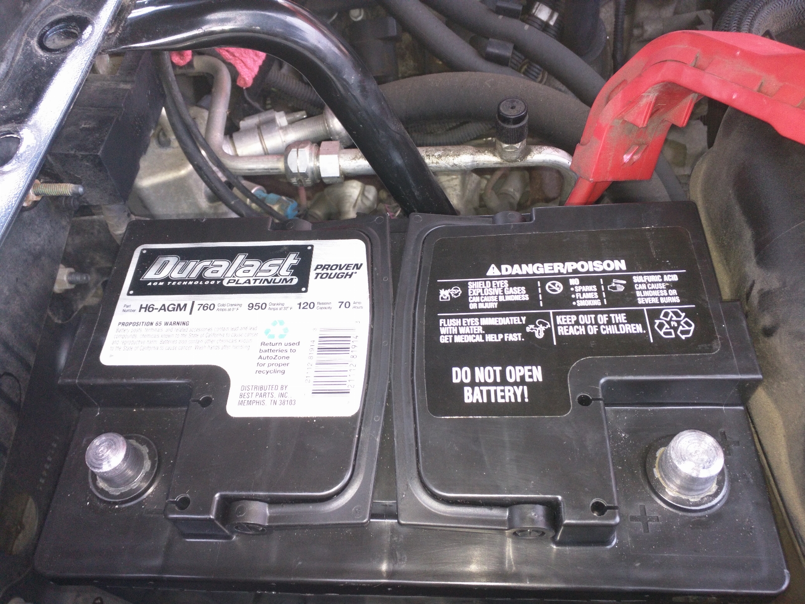

Lights were dimming when the fans were kicking on. Alternator checked out ok. Battery was 5+ years old.
I picked up an AGM battery. People are religious about battery manufacturers. As far as I can see is that there are few makers and many names. I find a local place and get the biggest damn battery.
