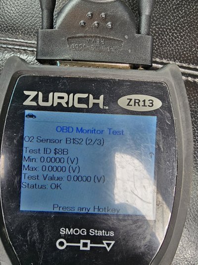

A little more info from me trying to figure stuff. I put my small little scanner on the truck and started looking if the O2 sensors were working right. The front O2 sensors(B1S1 and B2S1)were registering values, but the back O2 sensors(B1S2 and B2S2) were not registering anything all zeros.
Zero point zero zero zero or less may mean something, but
rear O2 sensors typically read UNDER 300mV, except possibly during WOT-PE or Cat Protect.

These were the values for both bank 1 and 2 cat and O2 sensors b1s2 b2s2

statue of both is OK.
the rear o2s are after the cat, as said about if the cat is working they should be very slow to basically nothing. if they cycle like the fronts, you have bad cats.
most likely but you're issue, but could become an issue if you run it to long with a dead miss. can plug up the cats.
Get that ecm flashed and go from there?
