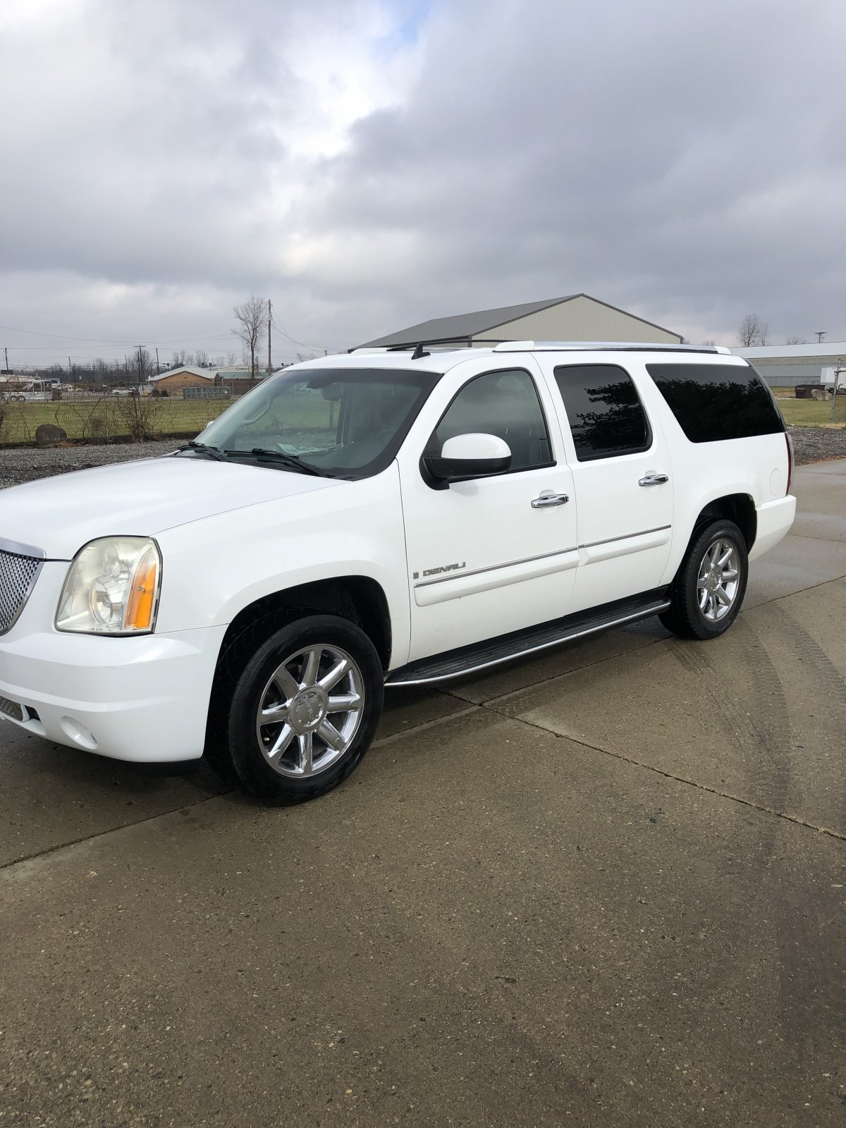

Here it is if anyone is interested.
Wolfbraid
Aug 30, 2018
283
272
Winston Salem, NC
Looks really nice. Well the dealership of course will be way too high priced, check out Jasper Engines, they usually partner or have local shops in the area, engines carry a good warranty

Just my opinion, And i am a mech with optimism. I look at the pic and say "i can fix that" but at 59 im wise enough to know that it is a huge amount of work, alot of potential collateral parts and fluids with an unknown finished product "ie service stabiltrak". 221k is alot of miles and with two kids and life keeping you busy i say cut your losses, $7k is a tough hit but you can recover, detail it and list it for $3,350 with the miss disclosed and move on. Buy your wife another car.

The motor is the sucky part of it, needing replaced. The "fringe" repairs like the hubs is normal maint I think with those miles. Mine went out on my 01 Silverado at about 175k. The truck really nice, maybe a jasper motor is worth putting in?
