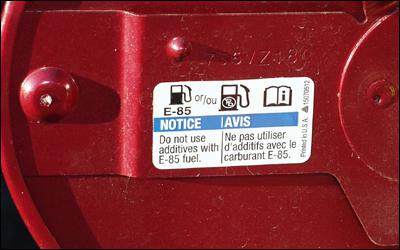

First of all, the VIN says I have a LMG engine, but there is NOTHING on the gas cap or on the vehicle that indicates flex fuel. I understand that some parts for FF are more expensive (even though I won't be using it, the maintenance cost will be part of my decision making) The part number for the spark plugs at the last service is 19417955. Can anyone tell from that if it is a FF? And if not, is there a way to look at the engine to tell????
The gas cap may have been replaced with a non-FF OEM or aftermarket. I believe the only difference is the color. The only way to tell if it's FF by looking at the engine is to ID the injectors. You can double-check your build specs by looking at the RPO label on the inside of the glove box lid. Look for "LMG".
Look inside the fuel door; there should be a small sticker there to tell you if the truck is E85 compatible. The different color gas caps are somewhat interchangeable so yours may have been changed from yellow to black.
Ha, finally found something on the vehicle that indicates Flex Fuel. Not that I'm going to use it, but good to know I do have the LMG.

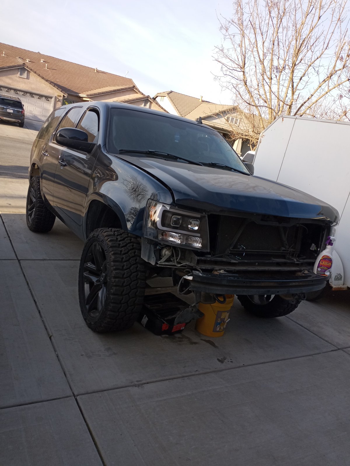

AFM delete I have the same year and model trust me you don't want my problems i have now.
Here is mine today
