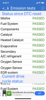

It would be interesting to have someone who uses the Range device to see what the readiness monitors look like right after removing it.
I can do that. I will have to figure out how to do screen capture on my iPhone and then upload it (Luddite alert), but I think I can figure it out. The last time I looked at it, there were like four things not ready.
I was planning on trying to figure out exactly what trip criteria I needed to accomplish to get my unit in full ready status after I pull the Range. If I stick with the Range device, I really don’t want to be running in AFM mode much, as it seems like the switching back and forth, especially with long layoffs from full AFM mode is asking for trouble.
I will figure out how to do screen capture and uploading of pictures, seems I have to relearn that process each time I do it and I know there are better ways than the way I do it.
I will try and capture the I/M pages of my scanner after I pull the Range dongle and then do a drive cycle to clear them. I will see if I can find the GM drive cycle guidance and perform it once to see if it will clear all the readiness flags left by my Range removal.
It will be good to know anyway, so if I go down the flash route, and have to go back and forth, I can minimize AFM mode time.
So here are the screen shots of my Cheapie ODB scanner’s results of the emissions readiness test after removing the Range dongle.
467E322A-D301-4F9C-89E0-3F2B6DFE6E59.png AAAB03A4-793F-4016-AA3F-415BF390A4DB.jpeg
I warmed it up because they mostly looked like temp related items, but didn’t do the trip test yet. Same result.
I have a generic GM Trip criteria and will try that to see if it is met a single time, they will reset.

From what I've learned about emissions readiness from the other vehicles I've worked on over the years.... if your I/M emissions readiness lights are not green "complete", you will not pass (at least here in CA).
The only one that will not matter is the EVAP test. It can be "incomplete" red. This is straight from a smog tech I talked to. EVAP test takes a long time to actually set under certain conditions (less than half a tank of gas, etc).

I have heard of the AFM plug-in modules. And after removing it, you would probably have to do some drive cycles to get all the emissions readiness green (except EVAP) and then you would pass smog. A cheap scanner will tell you that info. I have 2 BAFX OBDII scanners $21 (with the Torque Pro App $5), one I keep in my car, and also a more expensive bidirectional Foxwell NT530 scanner with various car makes software for the cars I work on.
