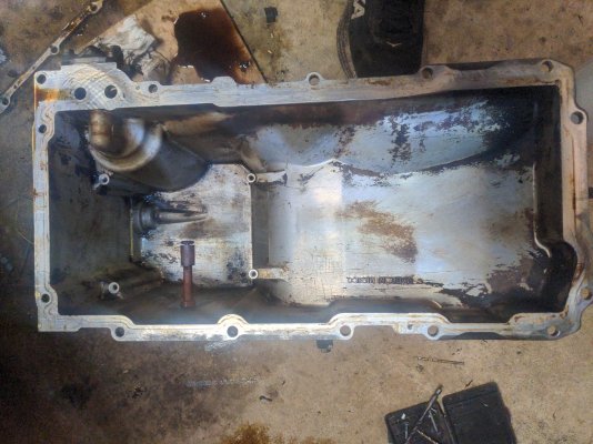

I had noticed this light tapping a few months ago, and I do mean light compared to some of the ones I heard on youtube. I thought it was the oil pickup tube o-ring (oil pressure was about 20 psi hot). I ordered a pan gasket and fel-pro oil pickup tube o-ring from rockauto and did that not very fun job. I will attach pics of the oil pan, 130,000 miles and my dad always just put dino in and followed the gauges oil change timing. A little sludge but nothing horrific, I ran a magnet through the bottom of the pan and cut the filter open. No metal in the pan and the screen on the pickup tube looked fine as well.
I get it back together and fill it with pennzoil platnium 5w-30 and an acdelco filter. Ran it for a while then noticed the ticking again, maybe about 200 miles later. Most of my trips to town and work are 15-20 miles so on a really short trip I wouldn't hear anything at all. But when I pull into the garage after a decent 45 minute drive the tap is definitely noticeable and seems to correspond with the oil pressure dropping as the oil heats up. Louder under the wheel wells than from above the hood, I could maybe record it and post a vid (not sure if a mic can pick it up) but it does sound like a light exhaust leak or lifter.
So I go back to reading, the black fel-pro one I ordered was just what rockauto had listed for my make and model. I could look up the part number but it was red in the picture, the one I recieved was black. I wondered if there was just a mix up or something, it happens. So rather than guess I ordered the melling green o-ring also from rockauto which is meant to replace the red one, and got that one in. (In hindsight I think the black one is fine) The pennzoil was definitely cleaning some stuff because it got dark in the 200 miles or so since I did the o-ring the first time. Cut the filter open again, no sludge and no metal seemed fine. Didn't take pictures of that though. Put another acdelco filter on.
The round 2 didn't seem to make much difference in the sound to me, I thought maybe the pennzoil I had might have been on the thin side or something so I went and got some oreilly's 10w-40 and drained it again. Pennzoil was much less dark this time, about the same 200-300 miles since I put it in the first time. No new filter because the last 2 I cut open were fine. Oil pressure can get about 60psi when I'm getting on the interstate and oil temp isn't up, about 25-45 psi hot depending on rpm. With the pennzoil I was about 22 psi to 38 ish hot. The first time I did the o-ring I picked up a couple psi, it idled around 20 hot before.
The 10w40 did quiet it down a fair bit, but it's still there. I read about using a long handled screwdriver to listen for the sound, and I do hear a something like a metal tap on the block. Seems lower because I can hardly hear it above the engine, but under the passenger side wheel well is where I hear it best. I know exhaust leaks are common and have tried to rule that out, but usually those are more obvious cold and go away once the metal expands. This is more the opposite and the sound travels through the block, so that's where I'm at. I'm snowed in at the moment and would like my 4x4 not out of commission again, but once I can escape I'll get a valve cover gasket and check out the rockers on the passenger side. Saw some youtube videos about worn out rockers creating lash that the lifter can't take up.
I can make the budget for a crate engine if it comes to that (or do heads and lifters ugh) but I'd really rather try to sort this one out given it's 'relatively' low mileage, also I've never swapped an engine lol. If I can't find a loose rocker maybe I'll try some fixes in a bottle idk, I wanted to document all this though because I would be way more lost if others hadn't done the same. My goal is to get it squared away so I can drive it on some longer trips and not worry about being stranded in the middle of nowhere.
I'll keep the thread updated with my findings. Let me know what you guys think!

Nice. Have you checked the exhaust manifold bolts?
Is the noise always there or intermittent? A little ticking on cold start is normal and nothing to worry about.
The good news is your oil pressure is good so I don't believe you need a complete overhaul or crate engine, which is evident by your lack of glitter on the oil pan and opening up the oil filter. Good job on that, you are on the right track.

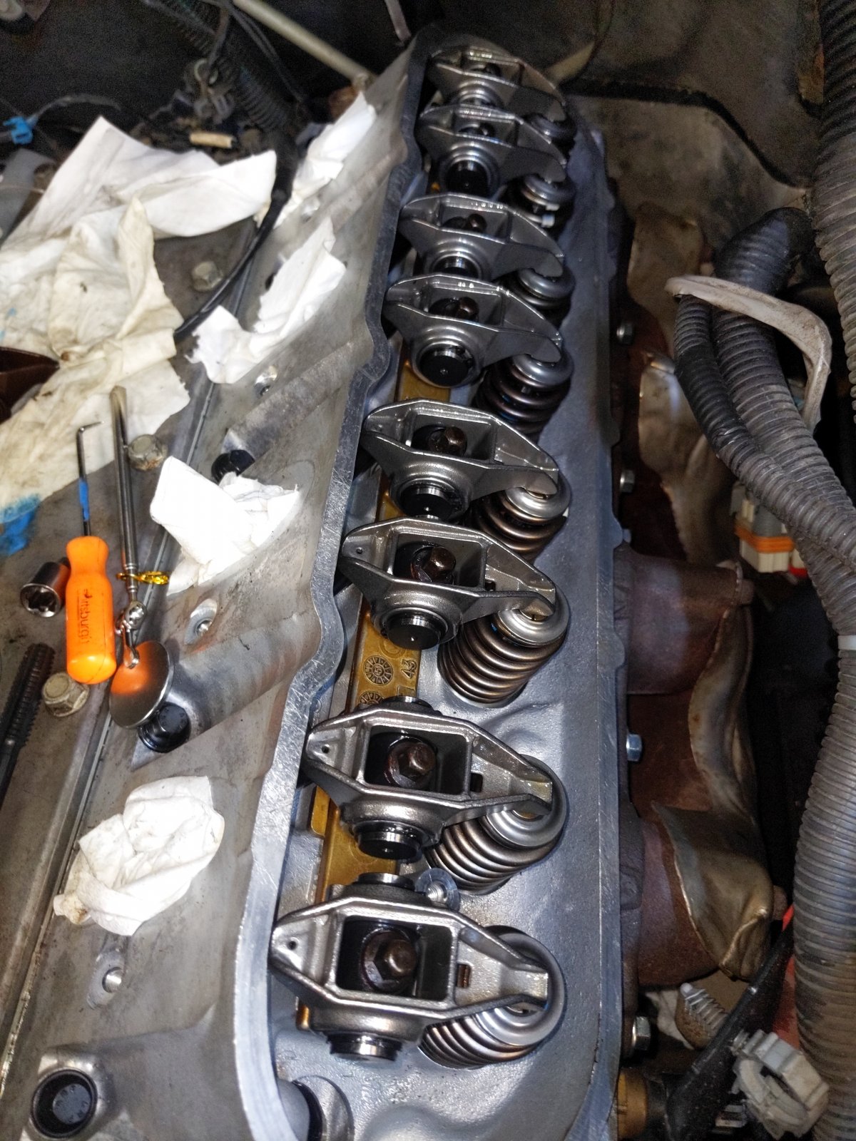

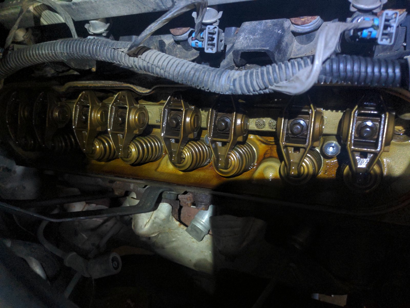

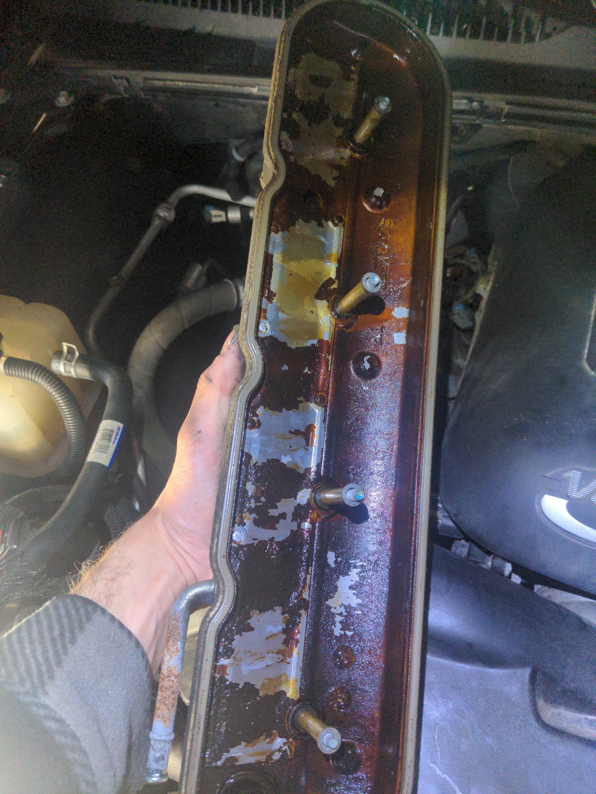

I did get some valve cover gaskets today and pulled the passenger side cover, I took some pics but there really isn't much to see. Started it up with the cover off and saw oil come up every rocker, flow seemed even. No audible ticking because it wasn't fully warmed up. Turned the engine over and wiggled them, passenger side is tight. But I did find another issue before I even removed the cover. Spark plug wire seems to have rotted away, just removing the bracket with the coils caused it to snap right at the boot. It just turns to dust when I pinch it, so I've ordered some acdelco wires and spark plugs. The wires are fine at the top but I guess the heat makes them brittle where they meet the plug. I never had any misfire codes logged though. Could be the ticking right there, I kinda doubt it but it will be a few days before I get these parts so we will see. I'll do the other side valve cover next and check those rockers out in the meantime.
Plugs are acdelco 41962
wires are acdelco 748HH
Valve cover gasket set with bushings: fel-pro vs50504 r-1

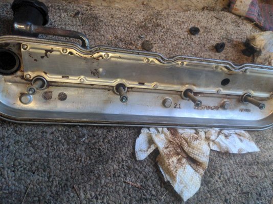

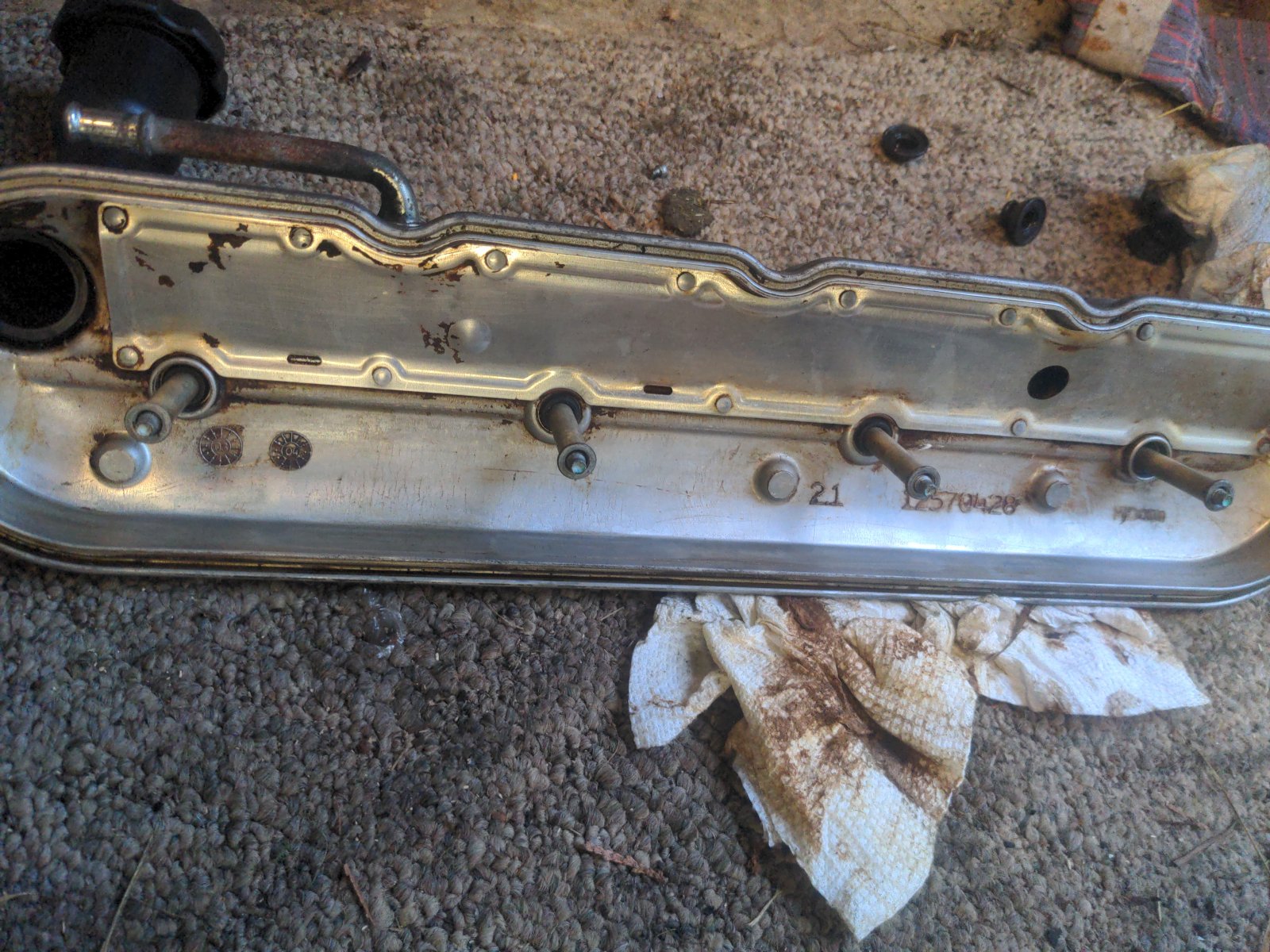

Also unrelated but anyone know what this tube coming out the passenger side vc is for? I have a catch can installed between the drivers side pcv and the intake (and it catches oil and water) but I didn't even realize there was this thing going to the intake. My chilton manual says nothing about removing it. Seems like the hose was rotted on it too so I'll replace that.
As far as I know that hose is also part of the PCV system and draws in fresh air to compensate for what is sucked out by the valve on the other side (unsure if this is correct). I also have a noise from the right side of the engine only when warmed up. I put a Dorman clamp on my front manifold bolt that was broken and I think that fixed it, or at least made it quieter. But I also have a fewer other broken manifold bolts in the rear I haven’t tried to fix yet

Did the other side valve cover and checked those rockers too, all seems good. Got the stethoscope and listened around but It's so quiet on 10w40 I can't pinpoint it anywhere, I almost hear it better with my ears than the stethoscope. I think I might go for a strategic "wait and see" approach for now. If it gets louder again I have some mystery oil, seems very similar to light oil like diesel. I think switching to synthetic on a 130k mile engine might have been my mistake. It is tempting to flush it with atf or diesel just because if that doesn't do it nothing will. Gonna run this oil for about 3 thousand miles and see what happens.

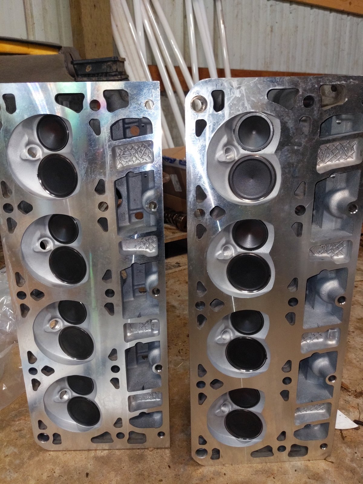

Answered my own lifter question pretty easily. Got one genuine gm lifter from summit and it's the exact same as the delphi summit brand ones lol. Only the date code is different(and the gm part bag), so save your money and just get the summit(jegs/napa/etc.) ones. They all are from the same factory, maybe QC is tighter on the ones the sell to GM idk.
Got a set of melling rocker arms (MR1341), a couple of the old ones are scratched and pitted as opposed to all the others where the cup is mirror-like shiny. One on #8 where I heard the sound is the most pitted and scratched. Also got the arp thread cleaning tap ARP 912-0011 and comp cams 7702 pushrod measuring tool, because murphys law.
Heads pressure tested good and getting the valve grind and resurface + new valve spring/seals + 3 broken manifold bolts removed. Cam looks fine which is good and maybe bad because I see no evidence of that grindy sound. Cam bearings look fine as far as I can see.
8 inch gear puller slightly trimmed with an angle grinder got the crank cam gear off.
Heating the harmonic balancer bolt and hitting it with penetrating oil is a good idea, I was worried I was going to snap my breaker bar until I oiled and torched then it came right off.
Now just taking my time scraping the head gasket surfaces with a razor blade and brake cleaner... anyone have a favorite method for cleaning head surfaces? I'm thinking I'll get them as clean as I can with the current method then finish with some lint-free cloths and a more aggressive solvent like oven cleaner or acetone. Not a huge fan of whizzing it with a die grinder or stuff I see on youtube...

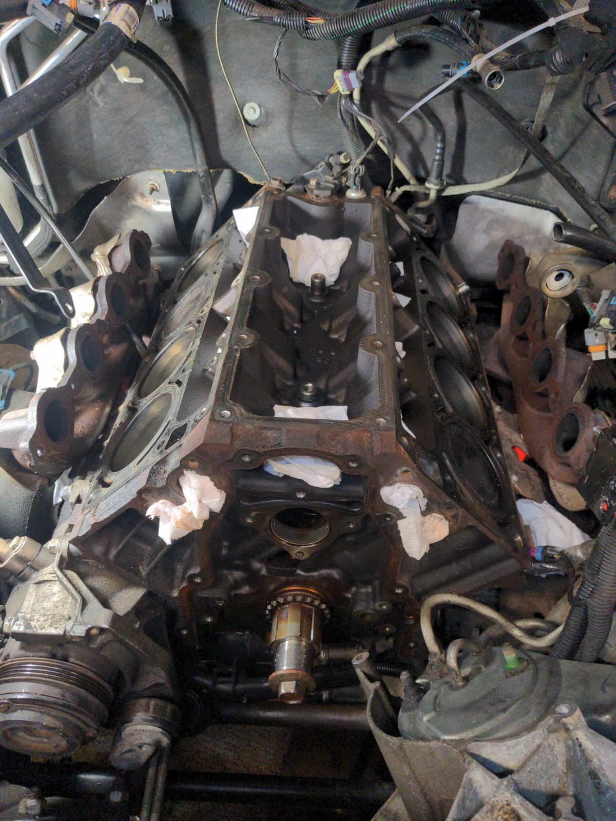

Worlds slowest cam swap mostly done, machine shop had my heads for a month... but they do look great now.
Just started it yesterday and ran it about 30 mins, sounded fine and no leaks just misfire code.
The idle is gnarly with MAF plugged in, +49% short term fuel trim at idle because it's trying to run at too low rpm I assume. Runs fine with a bit of throttle. I'll raise the idle rpm as soon as I get around to it.. throwing all that fuel can't be good for cats.
Measured my pushrods at about 7.300 using the measuring tool and Got the btr chromeoly "PR7300312" pushrods.
Primed the oil pump by cranking it 20-30 sec with all the spark plugs out (and gas pedal to the floor) which worked flawlessly no lifter noise instant oil pressure, also idles at 60 psi cold instead of 40 now. Around 40 hot.
To tighten the balancer to 235ft-lbs loop a chain through it to the frame to keep it from moving and get your cheater pipe.
The thread cleaning tap I'm going to say in my case was unnecessary, just tiny flakes of rust came out after hitting it with air compressor and brake clean. I would want it with the greased arp bolts if I was removing those.
Got to put my front diff and all that back then test drive time! Not completely done but I'm optimistic, definitely didn't hear the old ticking noise with the stethoscope but valvetrain might be a little louder now.
filthysuburban
filthysuburban
Jan 18, 2024
18
39
East of seattle in the sticks
Hauled a couple loads of furniture for a friend after I got it back together, runs great definitely notice more torque. But on the way back of course I start hearing a tapping sound kinda light but very similar...
Flushed out the oil and no glitter, didn't hear the sound until like 100 miles though. It's the same area as the old tapping sound and only one valve.
Got a 7.350 pushrod (50 thou longer) and tried it in various rockers that were on the side I heard the noise and found the 3rd pushrod from the rear on cyl 6 is the problem.
I thought a longer pushrod would quiet it but instead the tick got louder.
Back to all 7.300 pushrods and debating what the hell I should do.
Could take the head off on the passenger side again and install that extra gm lifter I have in there. Funny feeling I will find nothing wrong like the first time though.
Or send it and see if the sound gets worse? It's not loud enough to hear in the cab very similar to the old sound when I ran 5w30..
Leaning toward the latter, parts I took out look fine no metal in oil. And it's hard to hear until it warms up.
