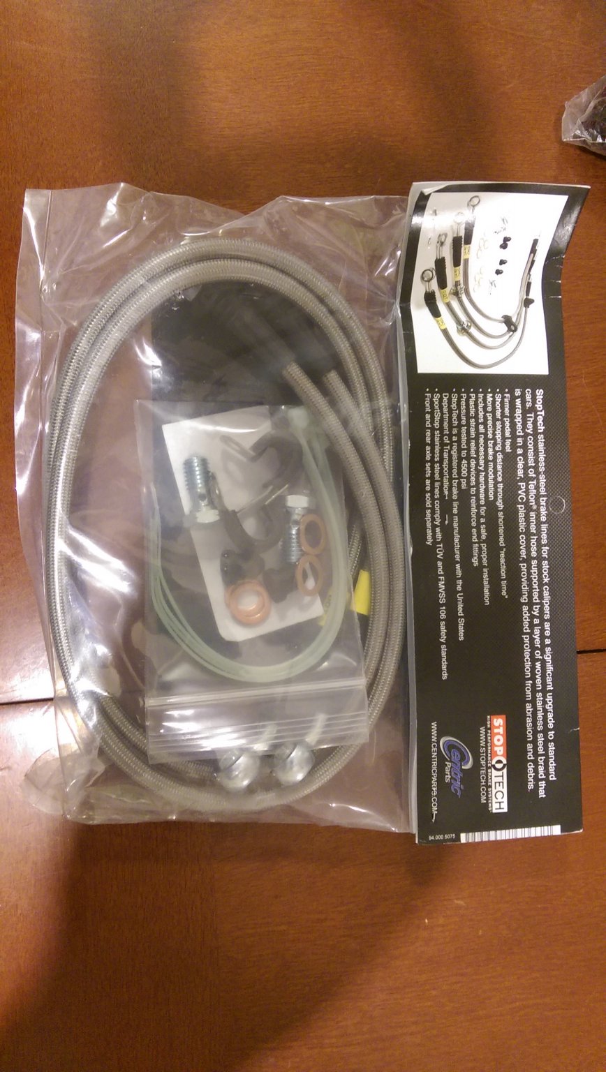

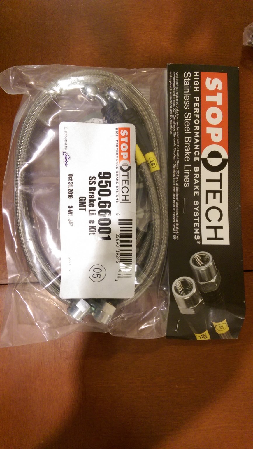

^^^ I'm sure you mentioned it somewhere recently, but I'll ask here: What brand are those SS lines? Did you do all 4 (or 6)? Cost?
I had all 5 lines on my S10 from Kore3 and they served me well. They quoted me a 6-line kit for my Tahoe at $218 plus $21 shipping.
I got goodridge. Came with 6 lines. I havnt installed the midlines. Those are above the rear axle

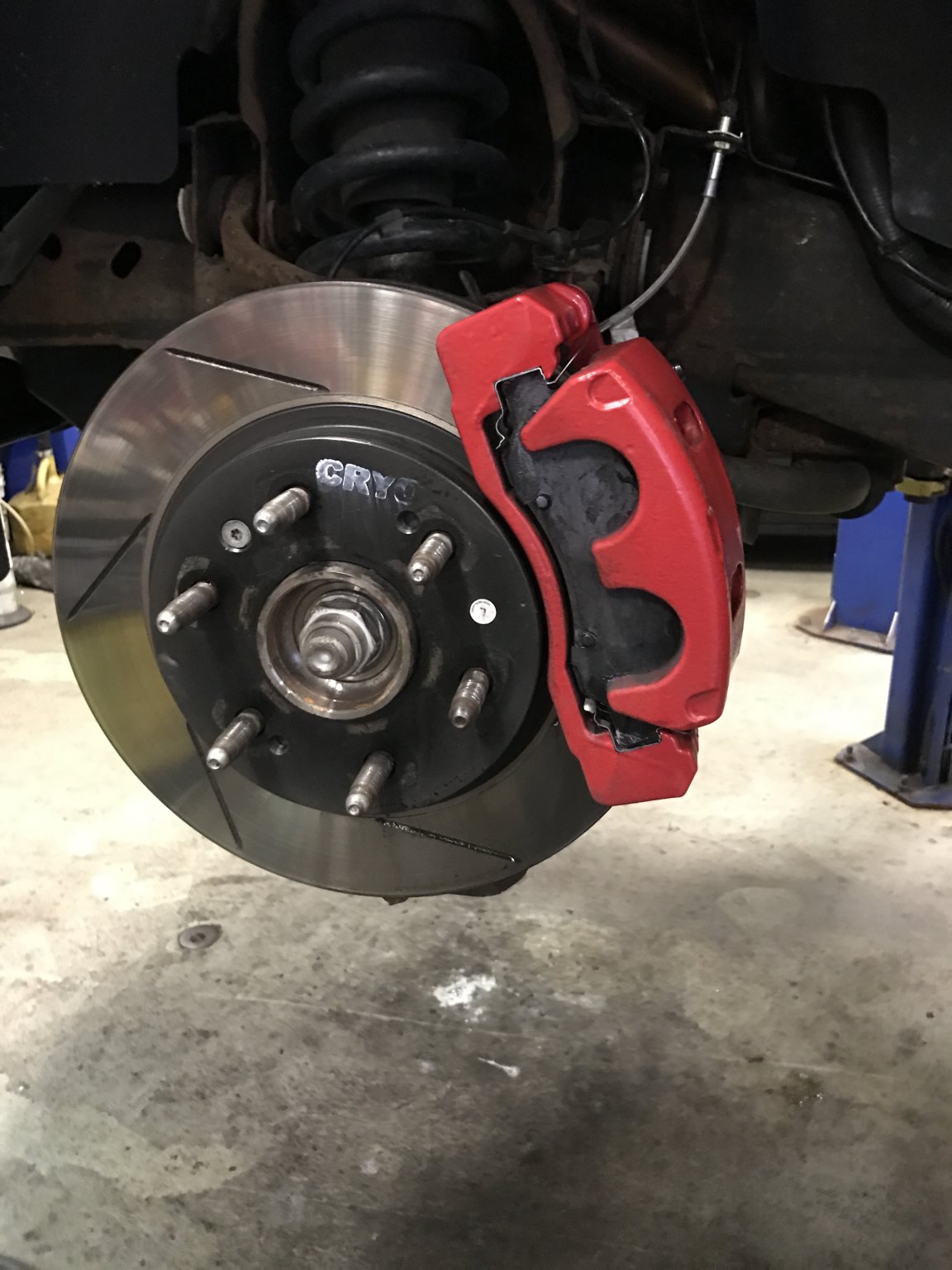

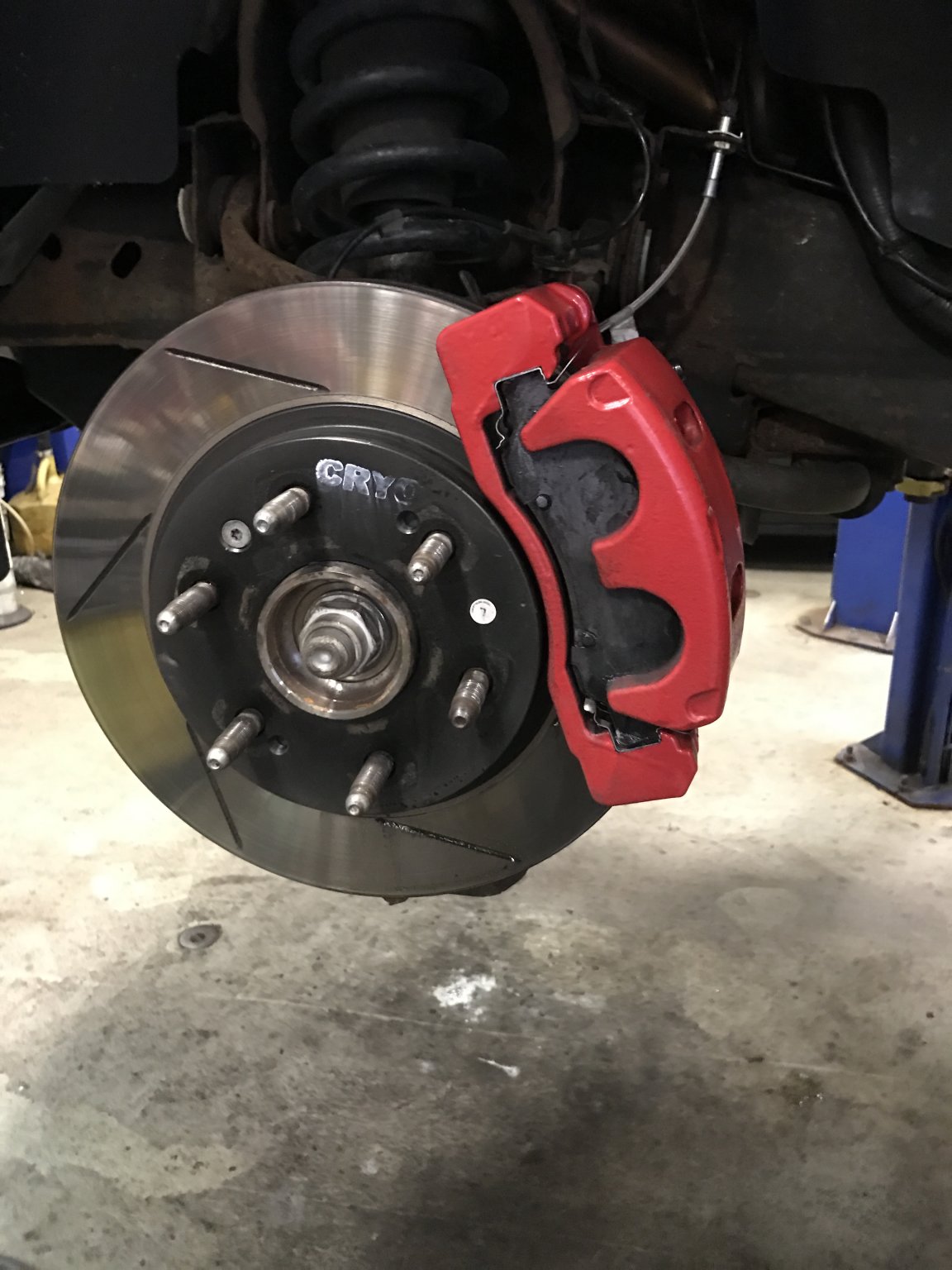

I also didn't install the line above the rear diff, it's pretty hard to access. I used the AC Delco calipers and painted them with caliper paint. Holding up well.
Cool. Glad to know there are other options for a full kit. It's also good to know that just doing the 4 corners makes a notable difference. But, my selective OCD will convict me to doing all or none.
