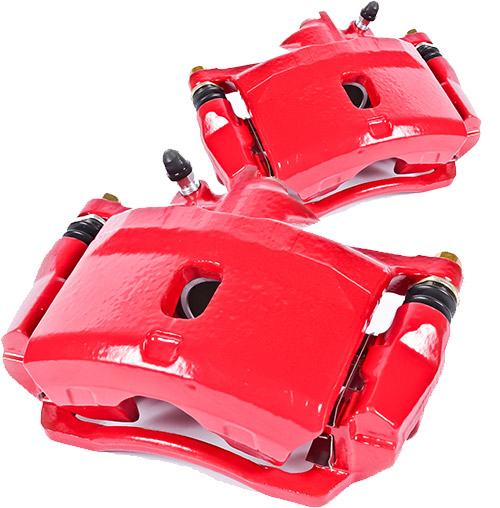

Will these calipers fit?
Will these rotors and pads work?

If you've 18" wheels, your GMT921 (Tahoe) wants 4-piston front brake calipers rotors AND pads from a 2015-2020 GMTK2UC-PPV.
(If you've 20" wheels, your GMT921 wants wants 6-piston front brake calipers rotors AND pads from a 2020-2026 GMT1UC-PPV.)
Stick to 1500 stuff (unless you live close enough to Mexico to know extremely resourceful suspension mechanics.)
Yes you'll need to shave the calipers of some excess material, AND yes you'll ALSO need washers.
More to come. I'm shopping for GMTK2UC-PPV front brake stuff myself ...
Best info I've found so far says you needs four 'M14' washers to make this work with a GMT900 brake caliper bracket.

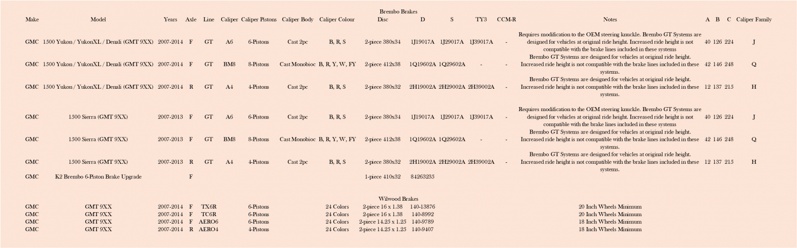

Many men start feeling this need long after they've replaced the OE brakes with aftermarket pads and rotors. Powerstop is a great value but not in the same league as the original Original Equipment brakes. ACDelco also offers a set with calipers intended for towing. We put them on our lifted Sierra and there is an improvement, marginal over the OE but better nonetheless.
Of course, with 26" wheels the stock brakes look wimpy now!
Anyhow, these are my notes on the subject from several years ago:
