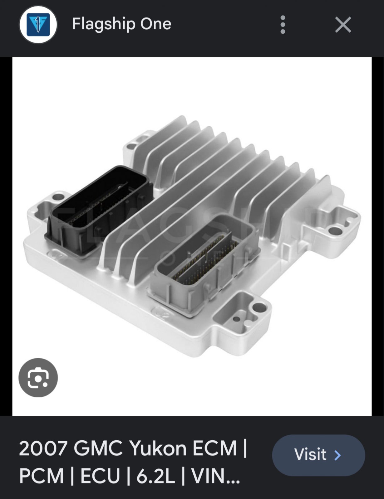

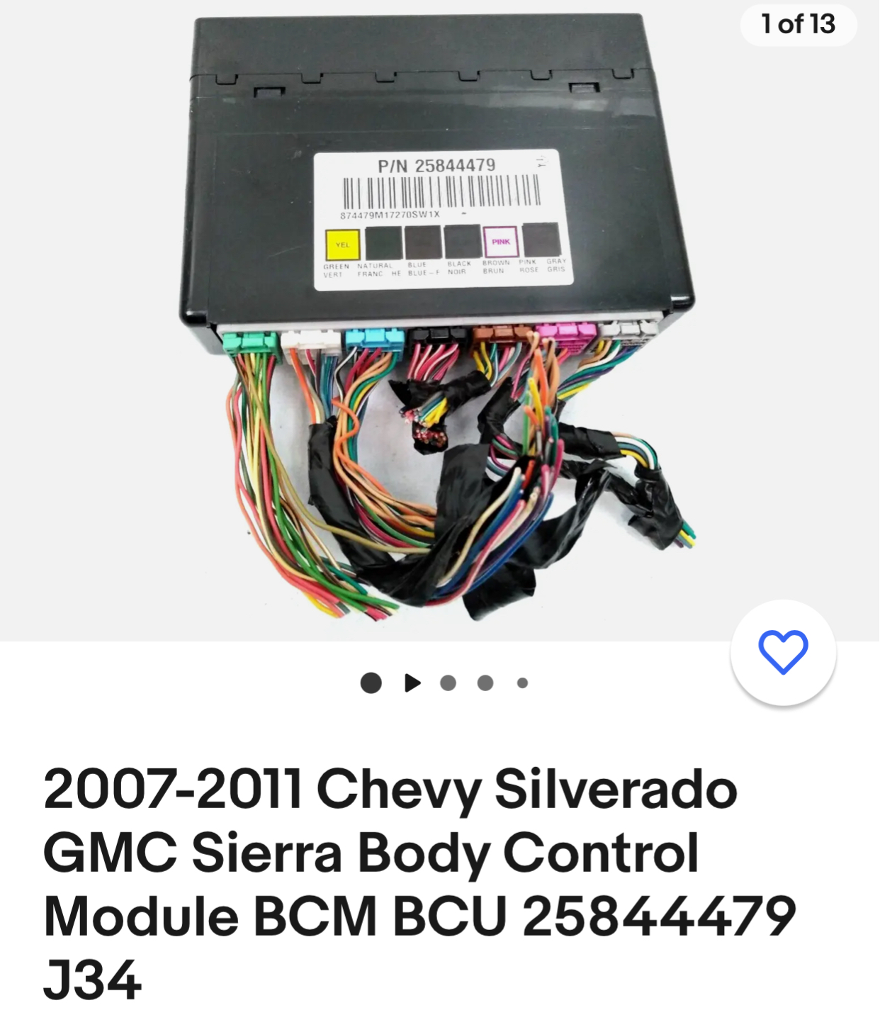

Ahhh, sigh of relief. I’ve seen the NNBS ECM vs BCM discussions in the past as a lurker. The last one I saw was a dude who emphatically insisted both were an interchangeable term for 07-14. I’m happy to now say NOPE.
I love pictures and part numbers.
ECM …
BCM
