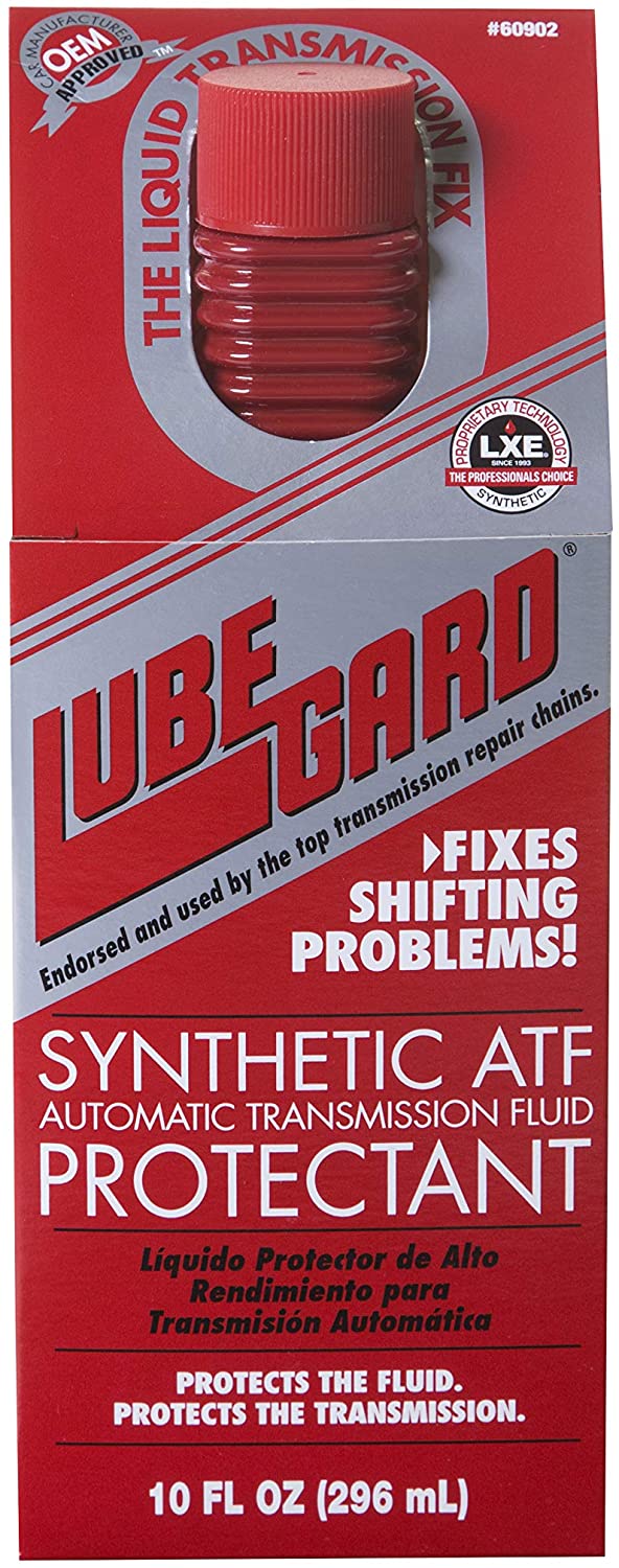

To help keep trans temps down. I run this stuff in ALL my fleet. Its the ONLY trans additive that trans shops endorse
Put this in my Express van because the shifts were hanging up--even after replacing the solenoids. Shifts beautifully now. Was recommended by my trans guy.
Ya its GOOD stuff !!! There's a big transmission distributor out of Cleveland, Ohio "TruTrans" /Transtar industries and they sell it at LOWEST price on Amazon/Ebay !!
I grab a few 10oz bottles when they have a sale going on
