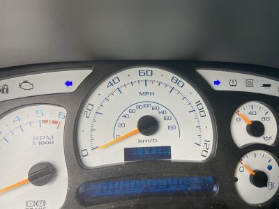

He has quite a few videos about our clusters, adding the trans temp etc. sat in his shop while he added trans temp and turned it on for me. While I was there, had him redo all the steppers, change to LEDs and put white face Escalade in. Now my turn signals light up blue lol
Let's see how it looks [emoji106][emoji41]

There ya go turn signal indicators (hazards on)

I can verify that the different style shift indicators will work. My stock 2006 Denali cluster had the style that’s individual slots on the bottom of the speedometer with a little orange indicator that lights in each gear. I swapped to an Escalade cluster that came from a 2005 that I had rebuilt and programmed with correct mileage. So from 2003-2005 the shift indicator was a little electronic LCD display screen with PRNDL321, and in 2006 it changed to other style. Like the pic posted earlier in this thread. The LCD screen in the 2005 esky cluster in my truck works as it should.
