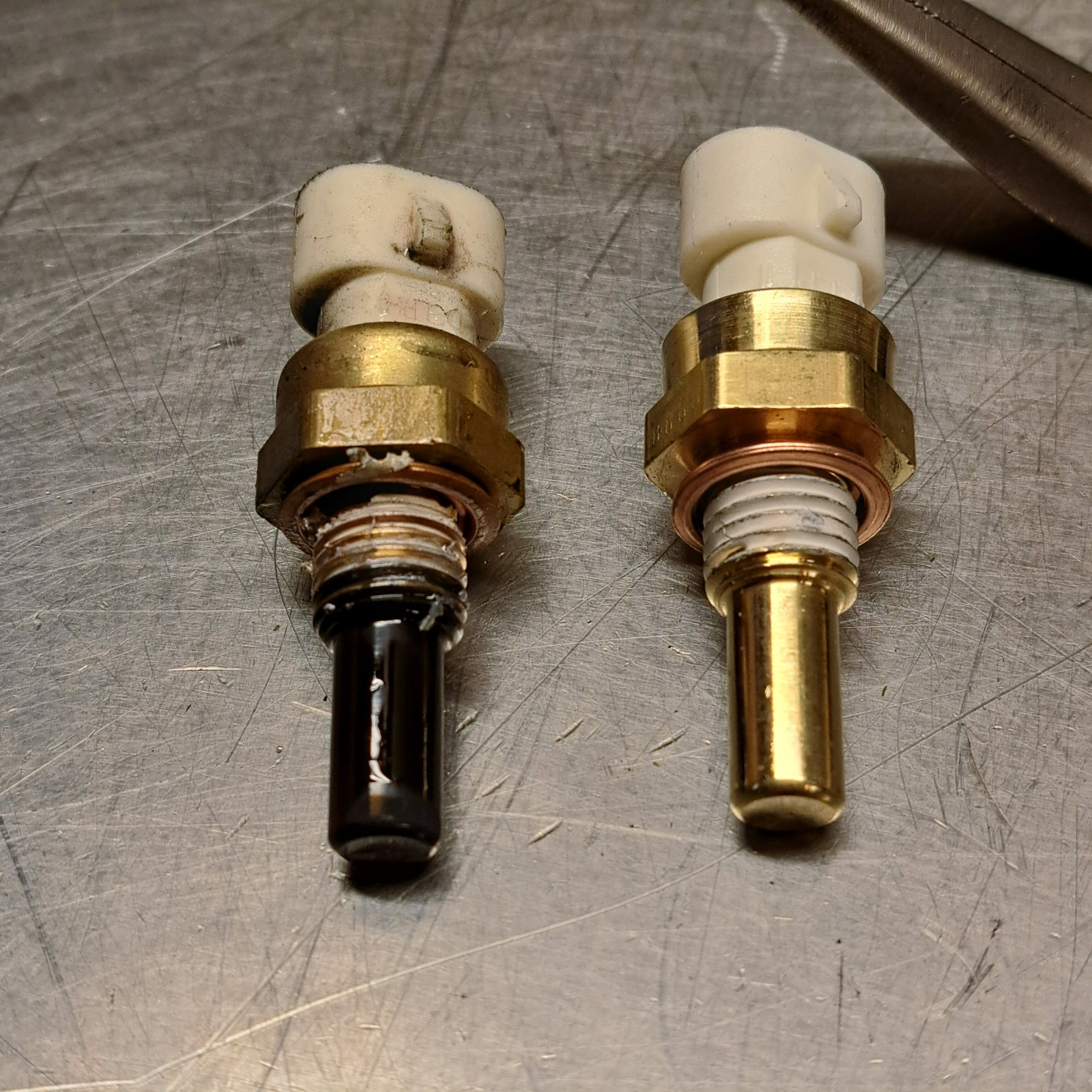

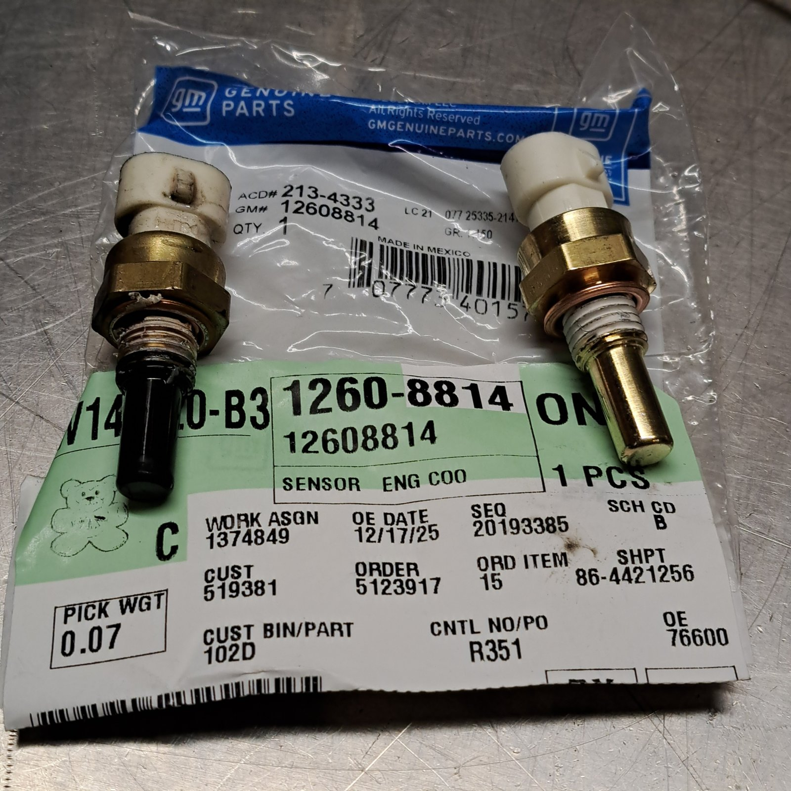

"Landlord called around 1 pm. Was 30 minutes out of town and his radiator fans would not shut off on his 2018 Suburban 5.3 4x4. I talked him thru the fuse box under hood and he pulled the related fuse, 40 amp. Told him to finish what he was doing and reinstall and drive here. Got here at 5 pm. I had done some you tube research and found is a very common problem. When he pulled in, the fans were roaring, roaring. I removed the negative cable at battery. CTS looked like hell when removed. His dash cluster display was at 160 degrees and turns out had been that way for a few days. I chewed him out for not telling me. The thermostat looked normal but turns out is a common problem, according to dealer parts guy. I went to dealer before he got here and got a new CTS and thermostat assembly with thermostat, housing and seal. Easy to swap it all out and reassembly. Then temp at dash climbed to normal just below 210 and great heat and fans functioned normally but start up, as they cycled with a/c on, could hear a squawk noise. Did not sound normal. He is going to Maui in 2 weeks and I can have to do the fans, oil change, clean throttle body and MAF and engine air filter and CAF and whatever else I find. has 96k miles now."

IMO, until you change the ECT, with Genuine GM or ACD parts and the thermostat/housing with Genuine GM or ACD parts, it is not fixed. See the info I supplied about this.
