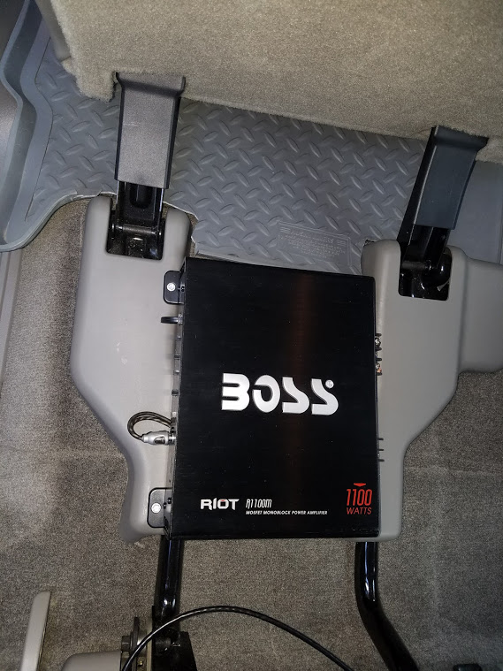

I just went through the same thing. I've had a 2004 Tahoe LS bought new. I ended up putting a Pioneer appradio in it, a 10" down firing sub (and amp just to run that sub) and new door speakers a couple years back. Loved the sound and just enough bass to make me happy...but not bouncing down the road. This Tahoe was recently re-purposed to my 17 year old son and I bought a 2005 Tahoe LT off my dad. Only 17,000 miles...still looks brand new inside and out. I installed a Pioneer 4200NEX, same amp and sub setup, but left the Bose speakers in. Sounds amazing. The amp was only $45 and the sub was around $100. I also just installed remote start for it was well. I'm loving Android Auto.

The amp is under the second row passenger seat behind the drivers seat, the sub is sitting behind the third row seats...right in the middle of them. Perfect fit. I like this sub because I can still put stuff on top of it as it's down firing. I also like to hear and "feel" the music, so this setup is perfect for me. I'll try to snap some pictures when I get home tonight.
Pics for location of sub and amp:
