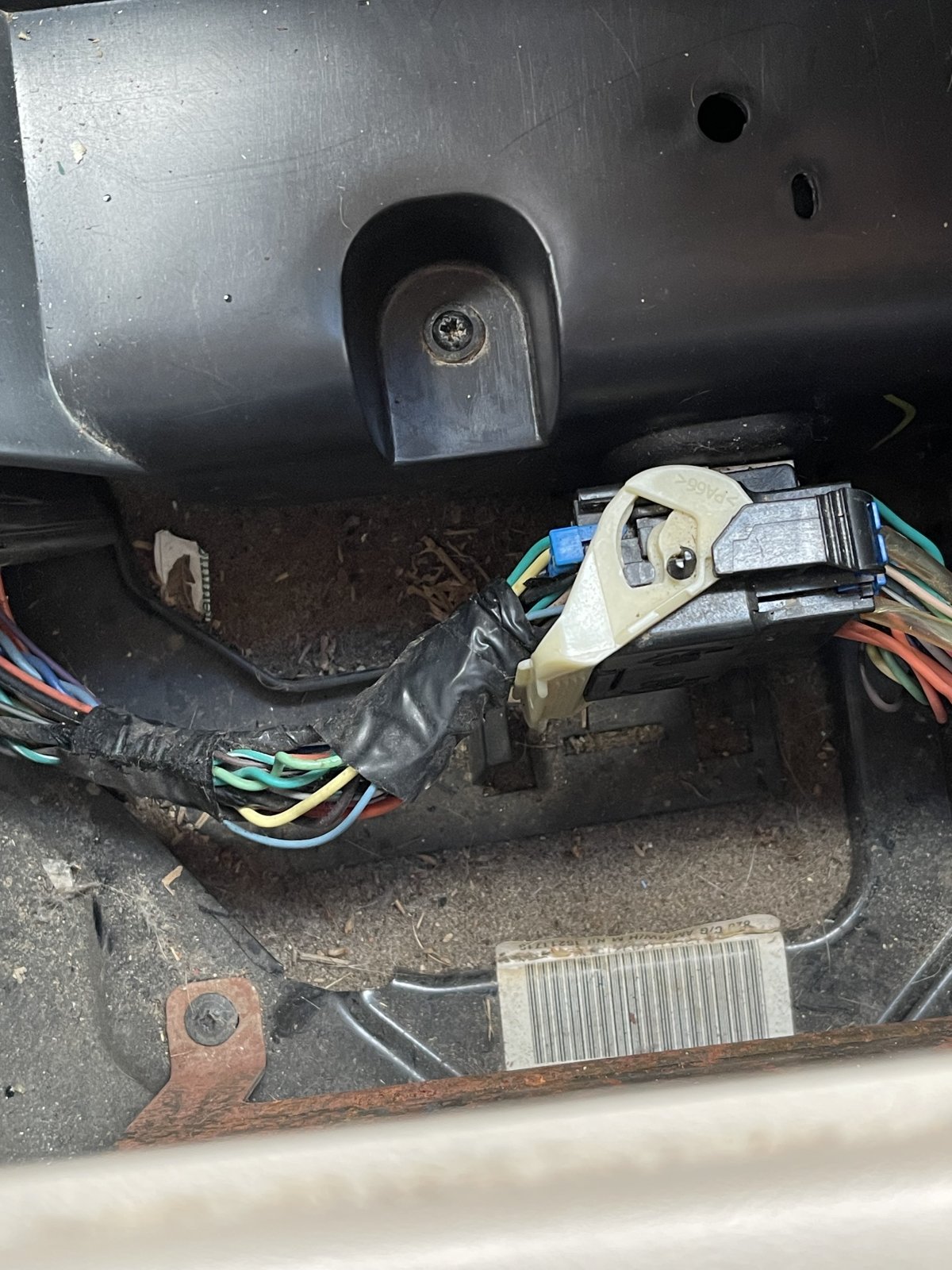

I’m trying to add an amp for my door speakers and i don’t want to get rid of the stock one because it’s necessary to retain certain features, but i’m curious if i can take the certain wires from this harness that go to the door speakers and run them to my amp to avoid having to rewire every single speaker.

You could in theory run one downstream of the factory amp, but what features would you miss if you did a full replace?

Just need a wiring diagram for your machine. Wires are color coded and 2 separate wires to each speaker.

I did get it figured out, I cut wires needed from the amp using a diagram and wired them straight to the amp
